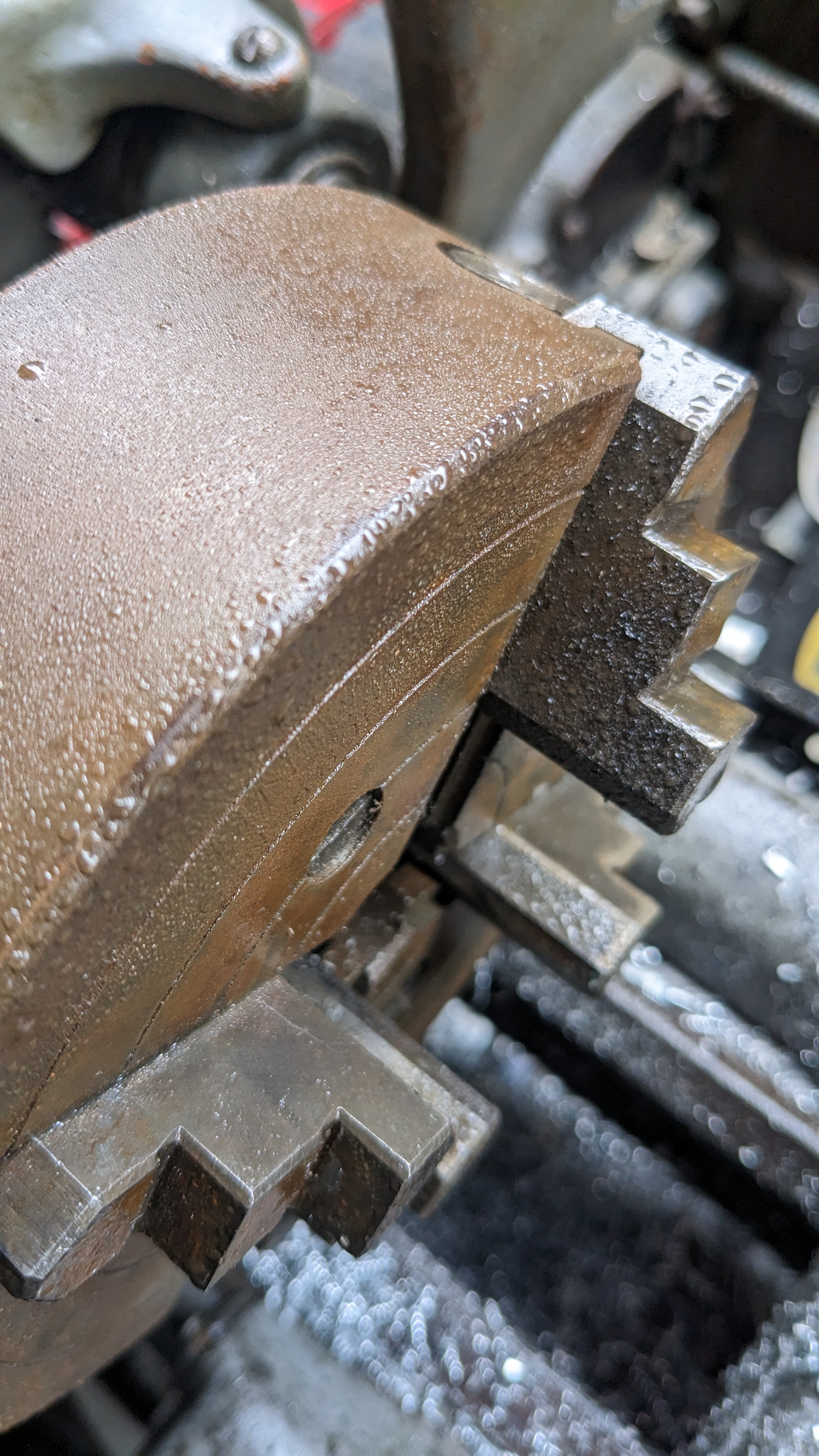

            #412
            Any advice dealing with flash rust on machines?
            my mill is getting condensation from the cold and some top layer flash rust are appearing on the table/vice ...
            I oil all my machines with way oil and tools with ATF for the corrosion additives, thinking about mixing the 2 for the table and vice (keeping way for the actual ways ...)
            Thanks,
            • DocsMachine
              • 2779
              #413
              The guys over on HSM were just taking about this. The recent cold wave brought temperature changes, and the fellow's shop wasn't well insulated. The cold machines condensed the humidity, and he had open water literally running off of them.
              The "quick fix" is to, as you note, use copious oil. Not WD-40, by the way. That's great for getting rid of existing moisture, but it evaporates too quickly for long-term protection.
              Any oil will do. A jug of cheap box-store motor oil will be fine. There's also spray products like LPS3, which leaves behind more of a waxy substance that lasts longer.
              The not-so-quick fix is to have a dehumidifier running- maybe not 24-7, but when conditions are right for condensation. A fairly tightly sealed shop area is almost a must, though. I've also heard of people draping sheets of plastic over the machines, and leaving a 60-watt incandescent light burning somewhere inside. That provides just enough heat to stave off the condensation.
              The correct fix, I'm afraid, is to insulate the shop (or improve the insulation, anyway) and heat or cool it as necessary.
              I understand the issue with cost- if I didn't heat my shop six or seven months out of the year, it'd be uninhabitable. And I also understand that cost not being easy to justify if you just do a little weekend tinkering out there. But, as you add machines (assuming doing so is in the plans) you just get more and more value tied up in machines and tooling, so the little extra on the utility bills pays off in reduced wear and damage to the equipment.
                Doc.
                that's how much condensation I had on my lathe chuck yesterday 😣

                    Sorry X, if I had that kind of thing happening to my machines, I'd move. Or set up a better shop.
                    What's the chances of putting up something like a garden shed, that can be closed, insulated and set up with a small heater or dehumidifier?
                    Doc.
                    Paintball in the Movies!
                      XEMON commented
                      Unfortunately, i don't have the room to move it, and code doesn't allow me to enclose the overhang ...
                      Both machines are now dripping in way oil and ATF .😋
