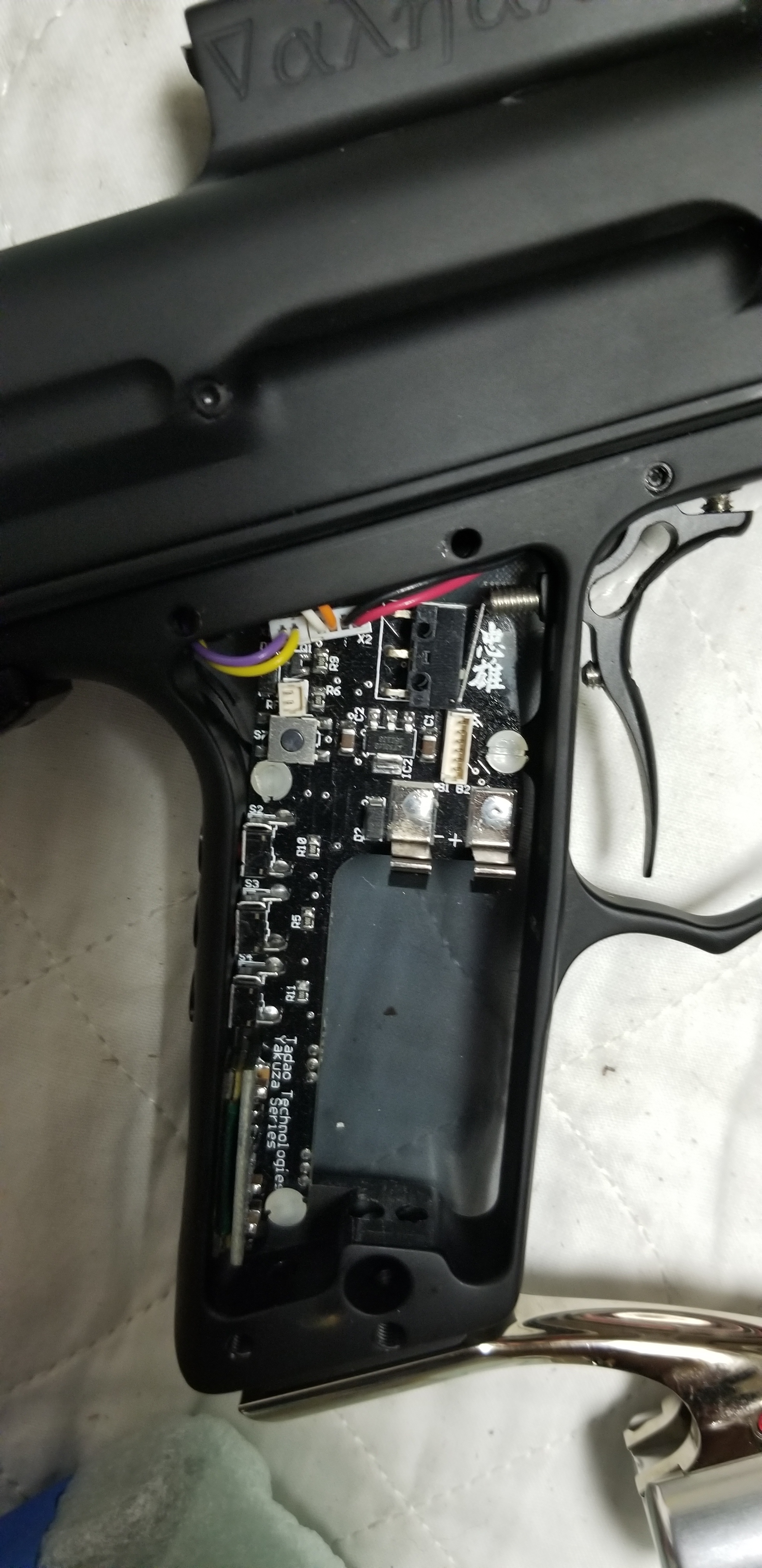

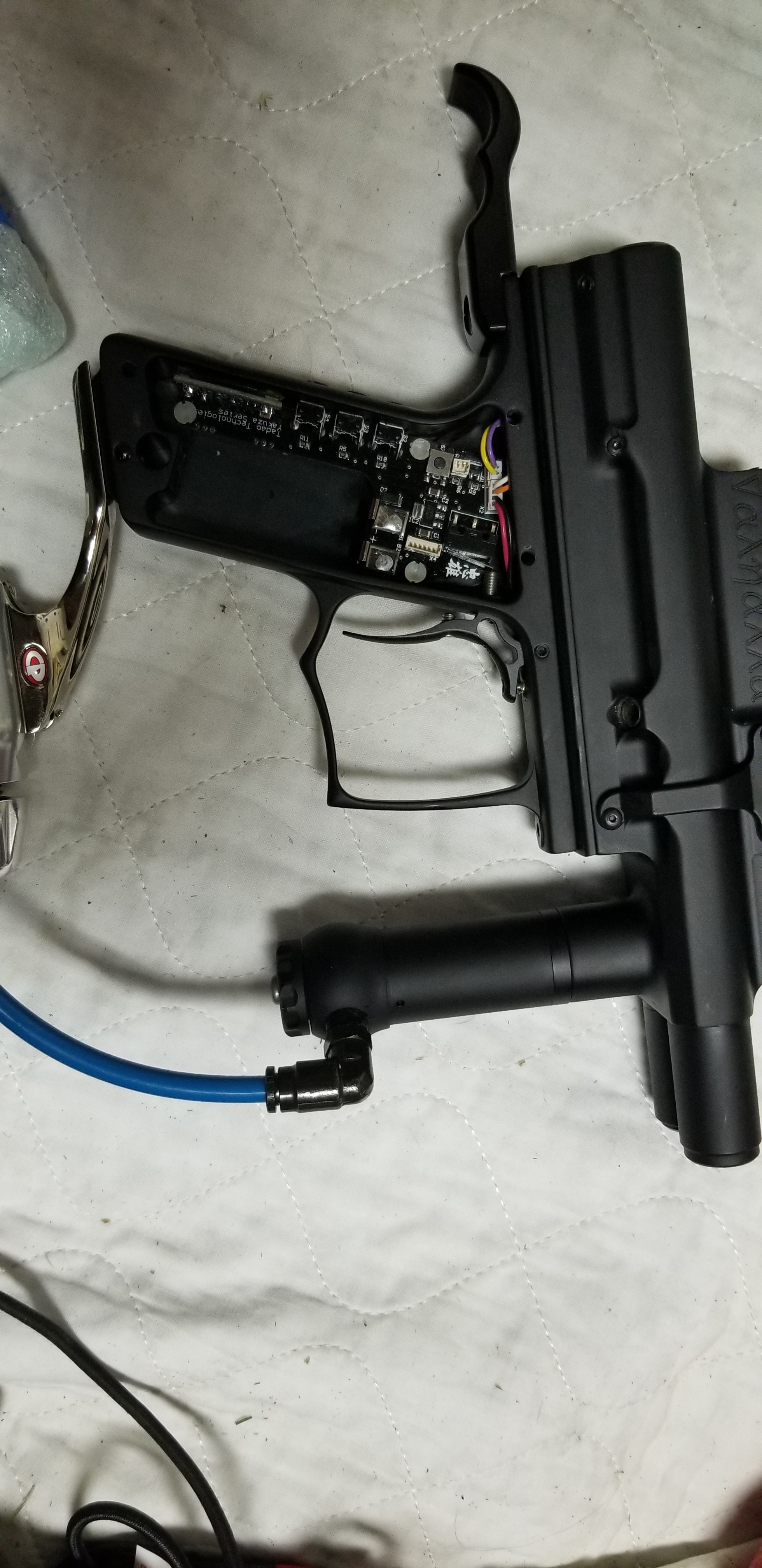

    Spend a couple hours yesterday and most of today working on getting some markers going.
    Got seven of them going, well without paint and place to fire paint. Just tested for leaks and make sure bolt fires without issues.
    I was saving this one for last because I figured all I had to do put on on/off, use the last bit of air and should be good to go.
    got everything hooked up, air it up, no leaks, good so far. Go to turn it on, wont turn on. Check battery that is making contact, seems to be good. Battery was used on couple others for test, pretty new so it should be good.
    Have you guys ever had a board die on you after sitting for a few years. Tadoa board, have used this Valhalla maybe 4 times before my long break from the game.
    Thankfully I picked up couple extra boards for the other EvilEhm I was going to build. Hope those are not dead. Will also try new battery just in case.
    Any other thoughts on what else it can be.
