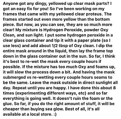

    Isn't there a "magic dip" that the JT guys use for clear bottoms to clean them up? It's oxyclean and something else. Looks like oxidation on the plastic which is why it makes me think that might work.

      "sea glow" cleaner is used on clear/ICE type sneakers. There's a an old tutorial on pbn on how to do it to a jt ize mask.

        • 6282
        This is what is used to fix clear parts but it will work on IZE parts. Is a combo of UV light Peroxide and Oxy clean.
        If it’s just black you can use black shoe polish it will even cover up light scratches and shell marks.

          I wonder if you could just use hydroperoxide and uv light. Basically the same idea behind retrobrite.
            Probably can. I have used the method above and it definitely works.
