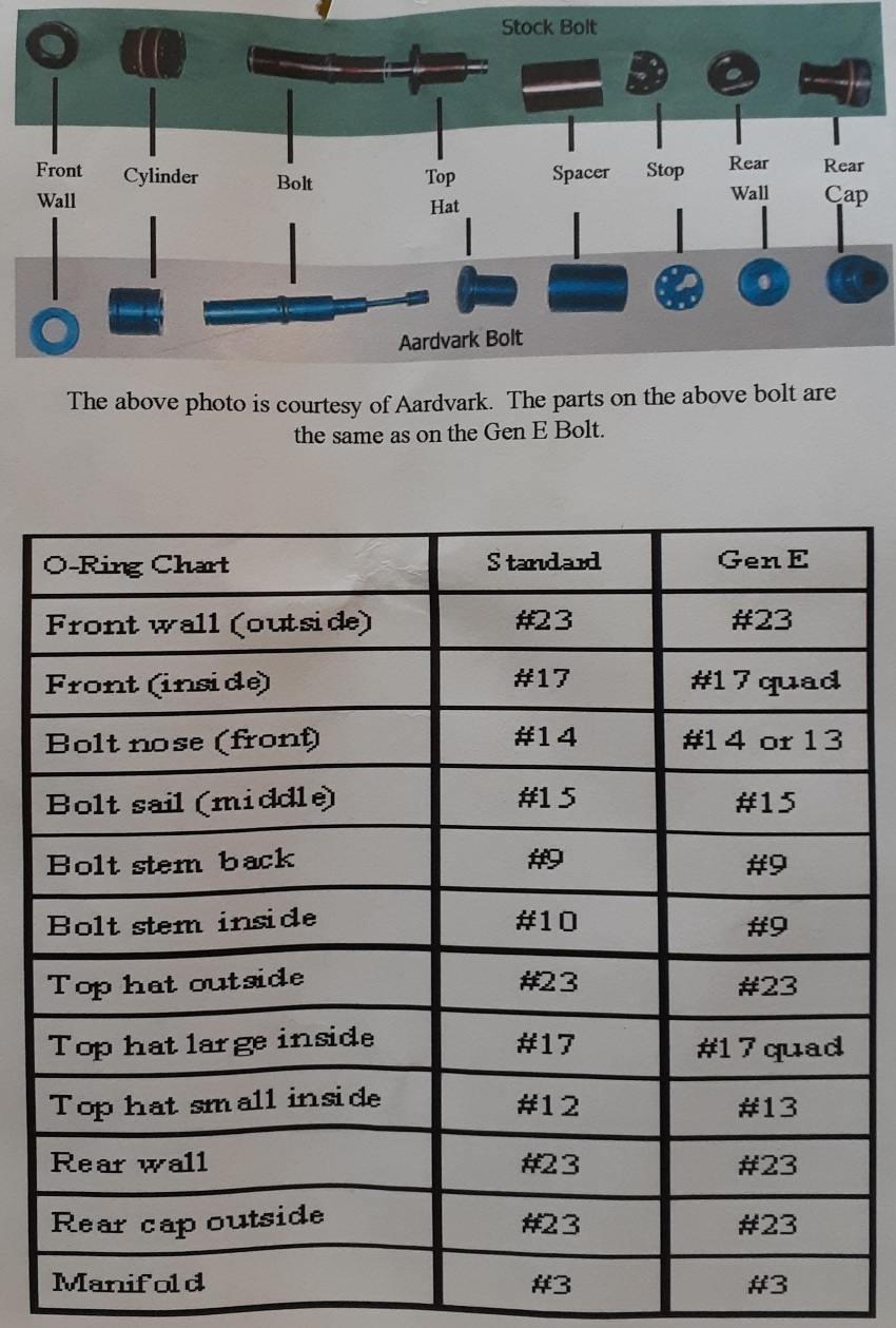

          There are two generations. The newer style after Gen-E bought the rights from Airtech are based on the Aardvark bolt-kit design and are commonly referred to as second gen or gen-II or Image bolt kit.

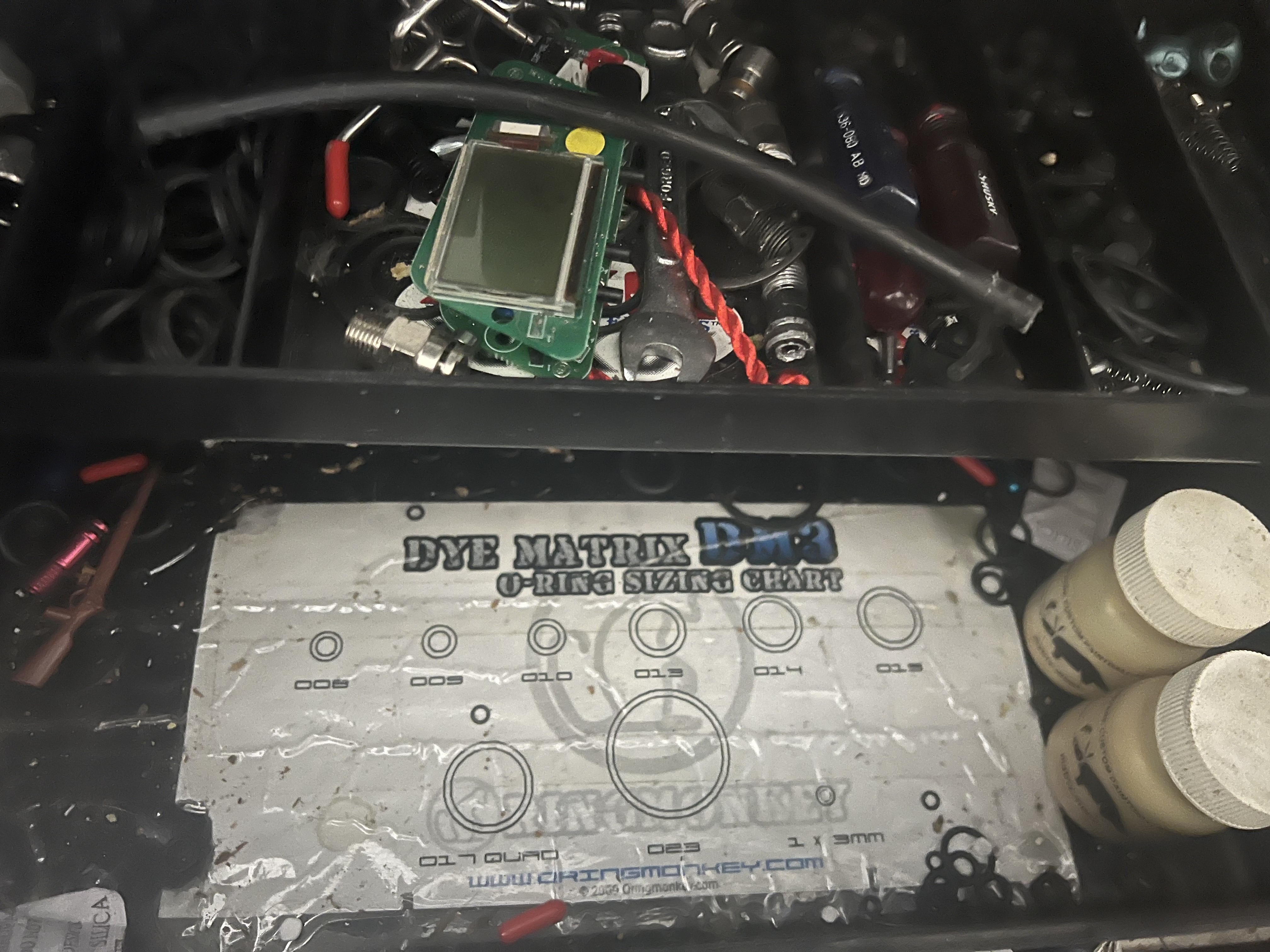

            Also the DYE LCD manual is up on the classic Matrix manual sticky in the DYE forum and it has all of the o-ring sizes
              MCB member
              • 3533
              • Montreal, Qc, Canada

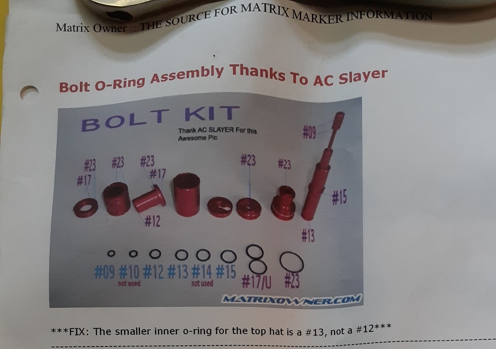

              Had those info on a printed manual when I bought one of my Matrix
              if it can help someone
