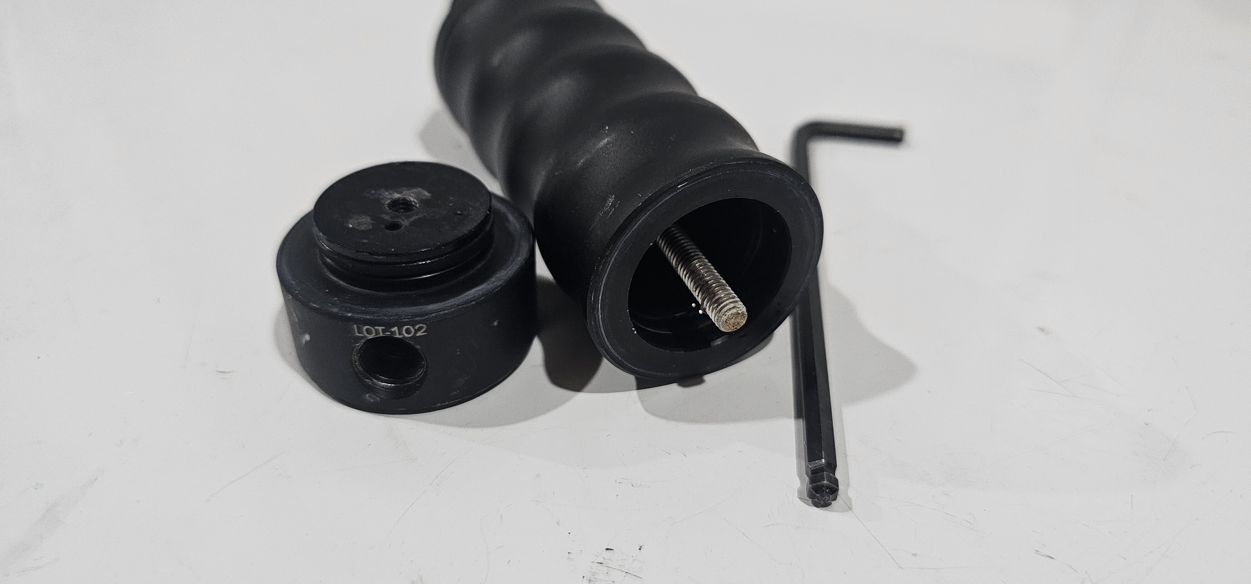

          How about this one? I believe it's a Bob Long/Benchmark. I'm pretty sure I see a socket cap screw down in there through the top but the hole isn't big enough to get an appropriately sized hex key through. There's also a seam at the top that's probably loctited together but I haven't been able to get a good hold of the top to unscrew it.
            scottieb commented
            Way down inside, through the top, you'll find a hex head slot stick the Allen key down there and loosen. It will come apart.
          • Toestr
            Toestr commented
            Yep I see it. The hole in the top just isn't big enough to get a hex key down there and I'd rather not drill it.

          Sorry to necro but how exactly are the benchmark expansion chambers opened? I can't get a good look down the hole at the top and the largest allen wrench I can fit in there is 7/64.
          I can see the bottom of a screw oriented vertically from the air source threading, but the allen wrench I can fit in there doesn't seem to be big enough to grab the screw to unfasten it.

            The answer is you need to drill out the hole at the top with a 3/16 drill bit and use a 5/32 Allen wrench to undo the screw.

              I would assume there is some sort of adhesive or thread sealant keeping the top and center portions together. Perhaps putting it in a pot of boiling water might soften that bond and make it easier to separate. Failing that, I can't see how else to open these things without having to drill it out.
