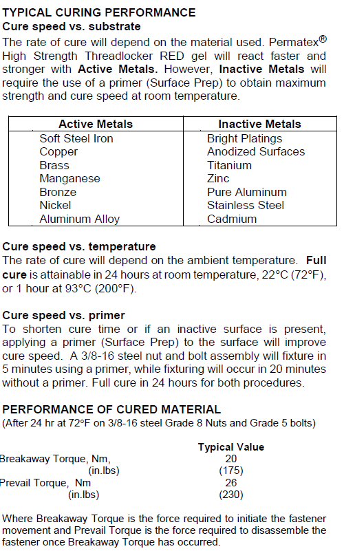

                  Originally posted by Toestr
                  I tried some red Permatex gel. It didn't work. Leaked from all the holes I plugged. Not sure if it was the fact that it was a gel or what.
                  Did you give it a full 24hrs to cure? That's what the tech data sheet (TDS) calls for...
                  Per the TDS excerpt below, it could really use a primer for common alloys used in paintball (e.g. anodized aluminum, stainless steel).
                  • Toestr
                    • 2878
                    • Poland, Onterrible
                    Yep, full 24 hrs. I figured the primer was just to speed up the process. It's being used on steel and brass plugs going into an aluminum body.
                    • Siress
                      S⌀.650" x 3.5g; F1979-17
                      • 1321
                      • Central MA
                      Huh. Maybe you got a bad batch. I've never used Permatex, tho... Try Loctite. That's the name brand stuff.
                      btw - primers are for adhesion; accelerators are for reducing cure time.
