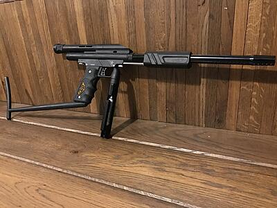

    Just like the title says, my lever changer is leaking won't create a seal, I'm using Crosman 12ies and is attached to my Phantom. The changer is brand new, never used until today. Thanks!

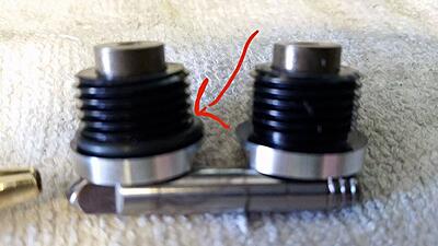

      It’s likely the #15 o-ring missing on the Changer you have. It goes on the part that threads into the ASA that holds the piece pin. Picture for reference.

        Yeah as soon as I drop a 12ie and pierce it vents instantly, I can get about 3 shots out of it. What's the easiest way to take apart the pierce assembly?
          • 6401
          Take the two grub screws at the top of the changer out. This will separate The Pearce pin assembly From the body. Then use an Adjustable wrench to remove the collar in the picture I posted above. Should be a #15 Oring between the Pierce pin assembly and the ASA adapter piece that it screws into.
          make sure you follow the directions I posted above on how to re assemble it. You don’t want to strip those small grub screws. lil blue lock tight on the threads and don’t over tighten them. lil at a time alternating sides. Make sure the body is flush with the piercing pin housing or it won’t have the proper throw to pierce a 12g. After that you shouldn’t have any issues. I have burned threw at min 500+ 12g on mine so far I’m still on the same piercing pin and seal. They are one of the more reliable changers when you get them setup right.

              Finally got a chance to disassemble it and yep no o ring, time to head to the hardware store.

                  Found them at the local Ace Hardware but there they are called a #35 had correct dimensions 11/16 OD 9/16 ID 1/16 wall. The #15 there was ginormous
