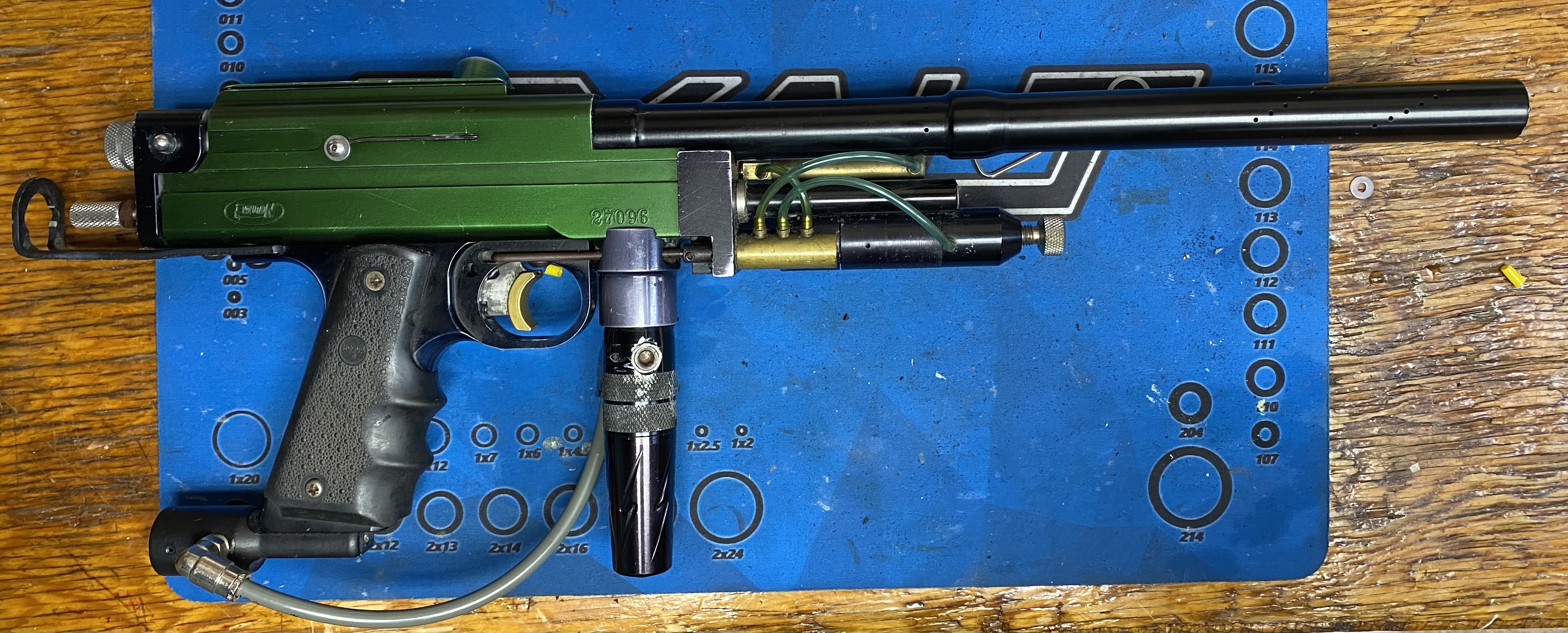

    So I bought this:
    What I know is it’s a pre-2k Evo. What is stock, what is not? General history? I’m not as knowledgeable about pre2k cockers.

    Nice find!
    you are missing the evo shroud (it is cut different from other shroud). I think the barrel is corect but no expert
    HPR is not stock
    https://paintballhistory.com/mini-be...clear-c-94-95/

      It's feedneck is on the wrong side, but still, awesome find ! where did you scoop that from?

        Local Craigslist. Been a good weekend between this and the spec ops mag.

      I'm gonna need you to send it to me to verify everything is correct. Don't worry I'll send it back eventually 😉.
      Would these early ones have come with the angry frame?
        Cdn_Cuda commented
        Yes, I think it is any Angry frame. Has the bottom trigger adjustment screw which I don’t think WGP frames had.
    • WORR13
      • 374
      dont think the real early ones, like this, came with angry frame, pretty sure it came with a cast WGP slider. this is 97/96 or so. hpr is bob long-not original, lpc is shocktech, dont think they came with twister caps either (possibly may have been an option), the barrel is a bob long i believe. this is a pretty rare earlier evo, i like the green ones
        Cdn_Cuda commented
        Yes barrel is a Bob long. In the 690 bore size even.
        Cdn_Cuda commented

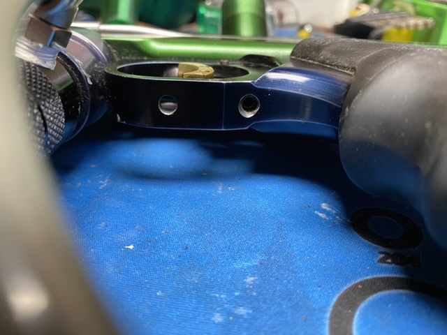

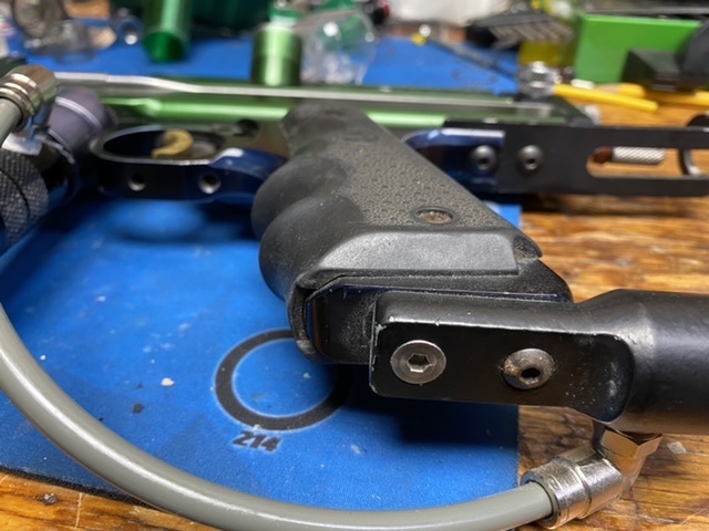

        Is there an easy way to tell if it’s an Angry frame? Lower trigger adjustment screw seems to match an Angry frame, but I’m not very knowledgeable about various slider frames.
      • WORR13
        WORR13 commented
        yea its an angry frame. u can tell more so by the shape of the frame, they have a more distinct trigger guard with less milling as compared to other brands. as for age u'd have to remove the trigger plate to see if its pre or post '98. most of them ive seen are 98+

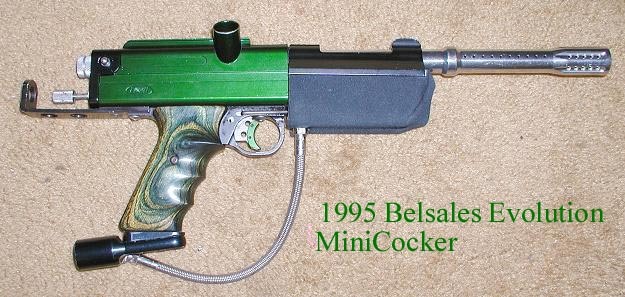

      looks like a 95, here is the type of shroud it should have....

        • 4330
        That's mostly original..... the reg isn't but who's counting. The barrel might be a DAC, which isn't wrong for that era of evo.
        The twister cap is a belsales item. It replaced the original front cap on stock wpg lprs to make them externally adjustable. Great pickup.

            The serial number dates it to 1995. To my knowledge, the angry frame wasn't out at that point. They were offered as an upgrade option by 97, per Ravi's Evo review. Same with the Twister kit on the LPR; not sure when they came out.
            Besides the HPR, it is entirely stock. Well, I think they normally came with SP wood grips, but that also could have been an upgrade.
              • 4560
              Confirmed it is any early Angry frame.
              Here’s a better picture of the bottom of the frame:
              Click image for larger version  Name:	D0454C98-C7B8-4BC4-A4EB-F26BEE4A6214.jpeg Views:	0 Size:	97.2 KB ID:	257681 Click image for larger version  Name:	0BE72A07-541A-49C0-A306-4BBDB6DCDB37.jpeg Views:	0 Size:	80.6 KB ID:	257682
