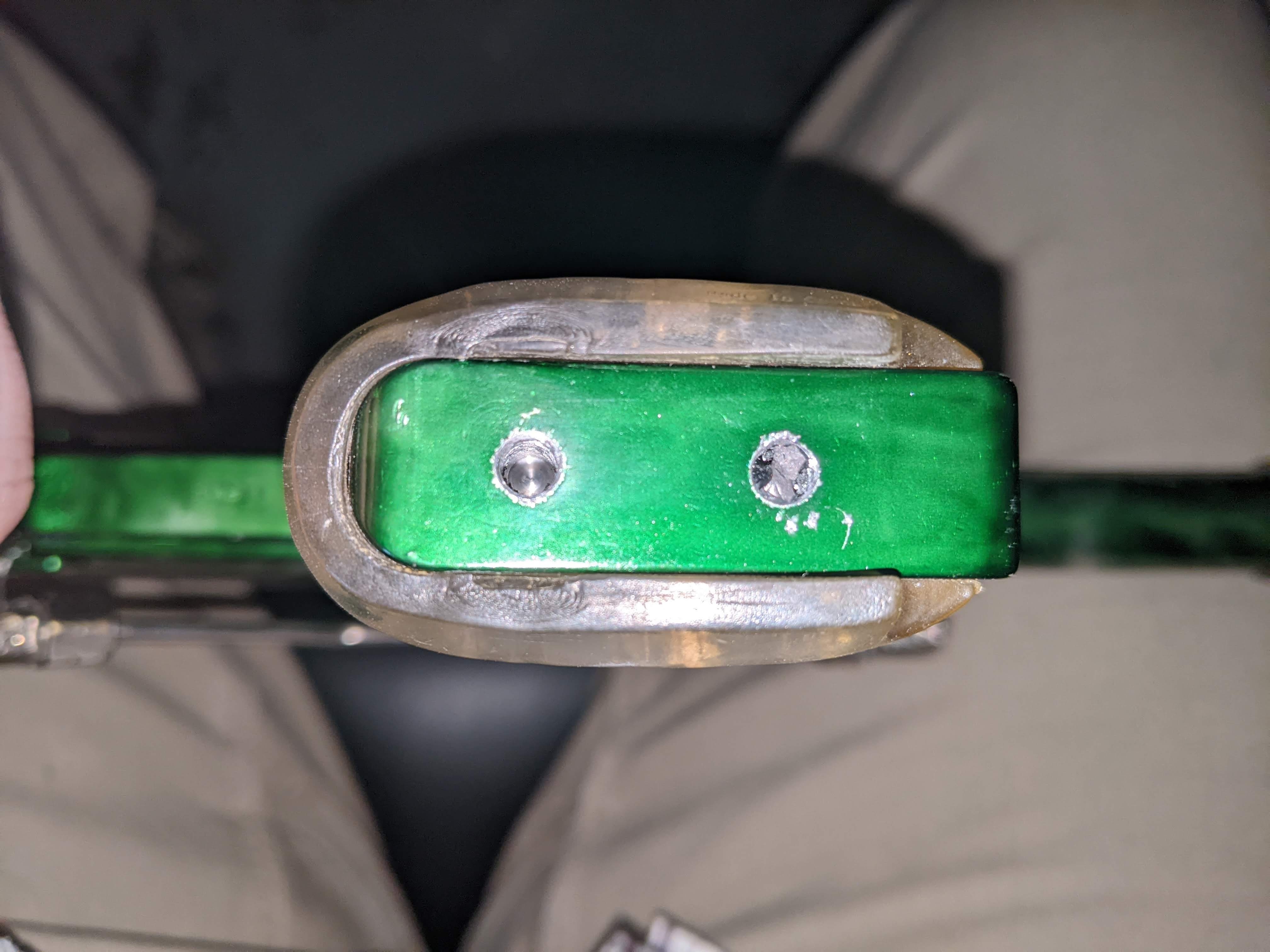

    So I had a phantom that had cross threaded asa screw holes. I decided to cheap out and buy the cheapest taps on amazon. First hole it worked perfect. Second hole it snapped off right inside the hole. There was little tourque being applied and of course it snapped right level with the metal so I can't get a pair of vice grips on it. What art my options? I know little about metal work. I returned the remaining taps and bought some extra hardened Milwaukee ones for future use.
    Thanks in advance!

    Drill a small hole setup it up until you can get a good bite on it with an Ez out.

      You can drill that and use an ez-out to pull it/unscrew it

        Thanks guys, I guess I'll have to youtube how to use an easy out! I'll order a set right away.
