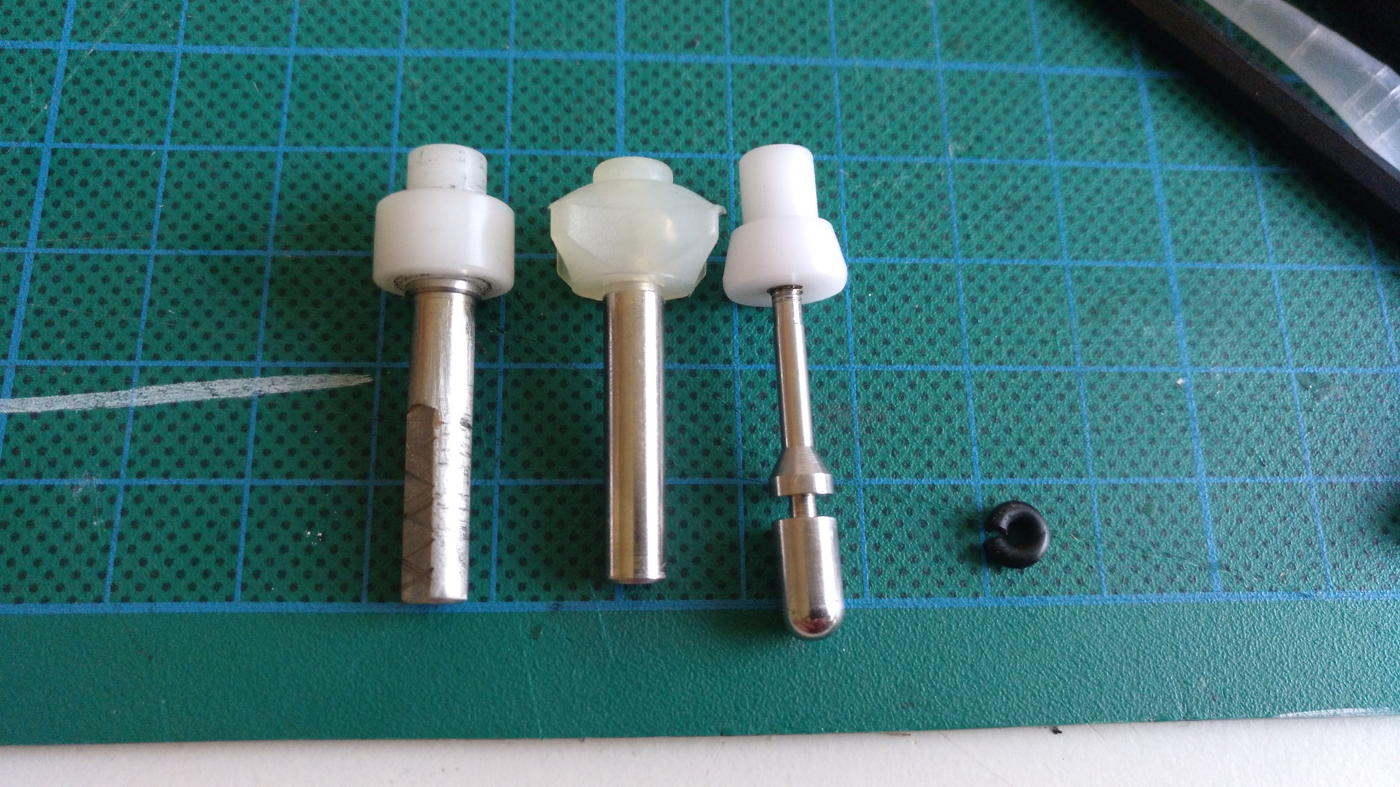

    Received the parts, my findings are interesting:
ID:	267397 From left to right: Stock (but trashed trying to modify it), Empire Sniper, Alias Intimidator
    The sniper pin is slightly shorter but has the exact same diameter as the stock pin (5mm). Good, and in my case cheap option, but probably not suitable for low pressure operation.
    The intimidator pin is 5.2mm in diameter and a few mm longer. It was binding in the valve at first, but I was able to fix this with just a bit of polishing paste and a paper wipe. The fit is just perfect and almost airtight without the o-ring (which was too thick and had to go).
    After reassembling the gun with the new pin and - without touching the reg or velocity adjuster - my first shot was 340, where it was previously set to 260fps. I had to turn the velocity adjuster all the way down and was still able to drop the pressure from 350 to 270psi until I got back into the safe/playable FPS range.
    Of course those numbers are anecdotal and from single measurements, but even if you take it with the biggest grain of salt, I'm pretty impressed by the results.
    I attribute these drastic improvements to both the narrower shaft for higher airflow as well as the longer pin that should significantly increase the open time of the valve. It's probably not a good choice if you're going for efficiency.
