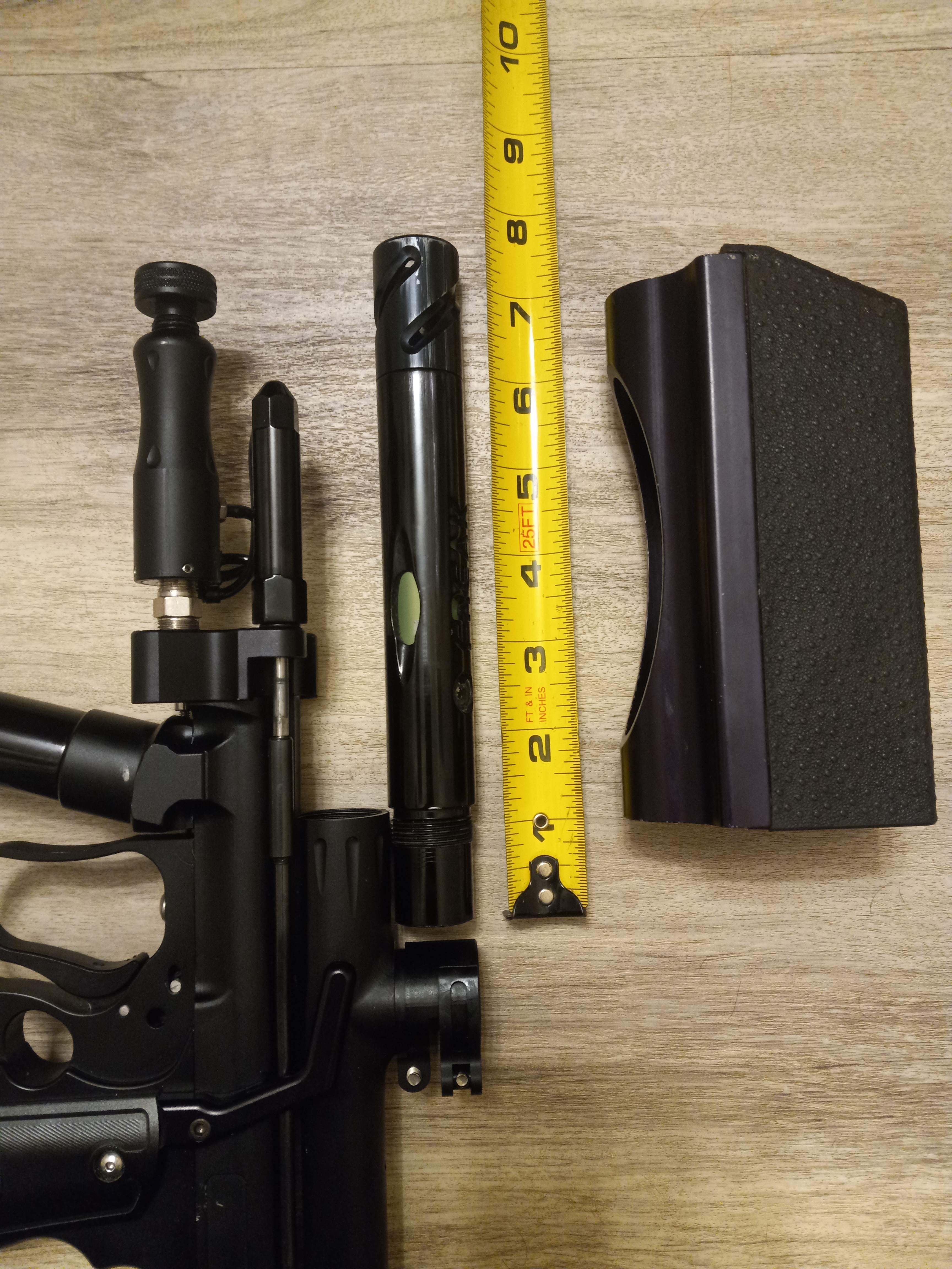

    I like short barrels, and my plan is to have a bull barrel bored out and cut down to just past my shroud using my standard 5 inch freak kits.
    If I go to an 8 inch XL, I would pick up almost 40% more control bore for only an additional 3/4 inch in length than what I have now.
    I assume this would help with consistency in velocity? The price isn't an issue, but I don't want to spend it for no real gains.

    Picture for clarification

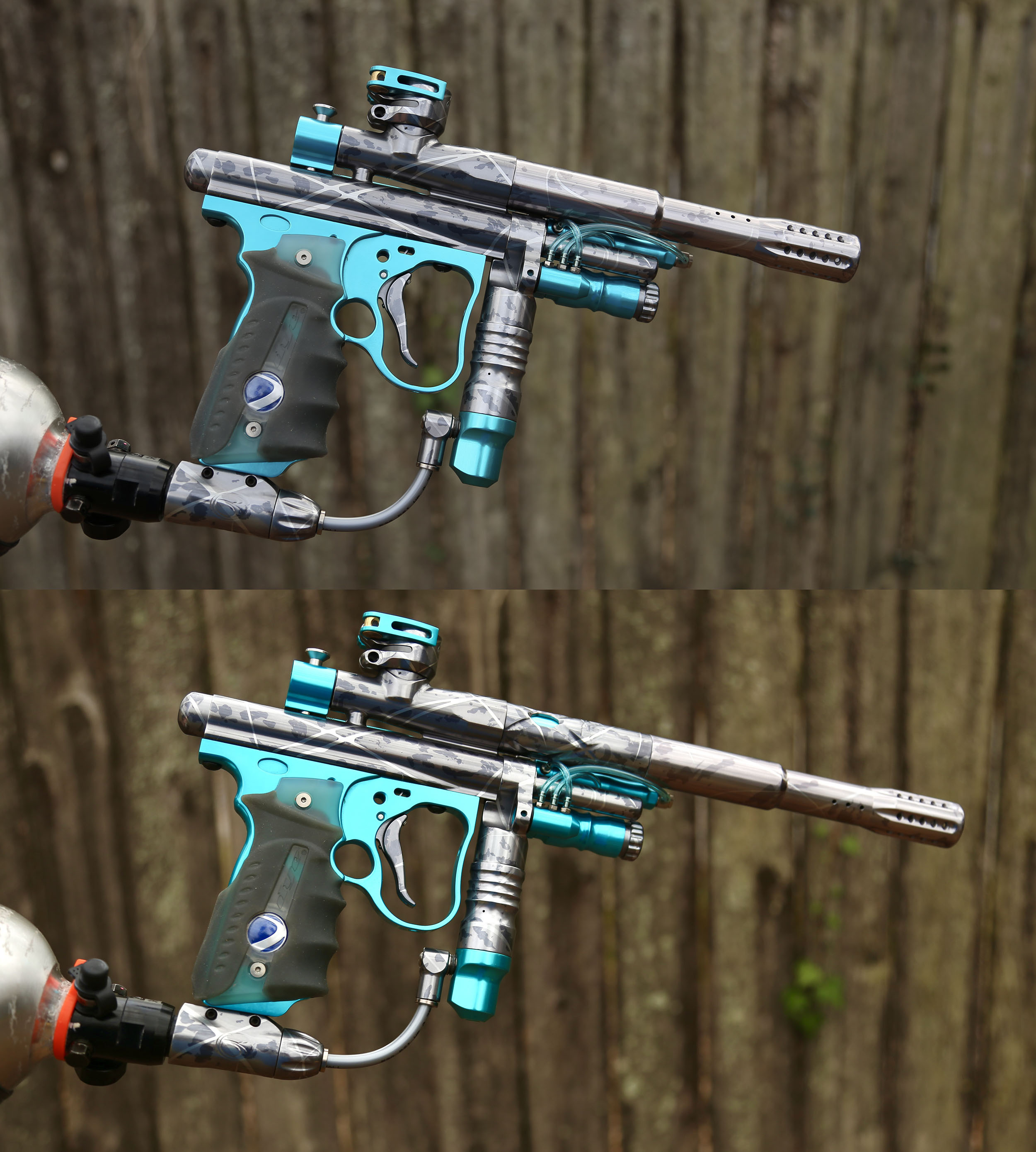

        I would buy a nummech XL barrel back extender. Just use as needed. Makes any freak cocker barrel an XL

          • BrendanB
            Autococker Fan
            • 1057
            • Louisiana
            Here is my midget halfback, you can see the stubby freak bored barrel in one pic, and the stubby barrel with XL freak adapter added to back.
            • latches109
              latches109 commented
              great build! I like the ccm 3way, gives it the stubby feel. who did the anodizing?

            Thanks for the info guys. Bad paint out of my short barrel seemed to be drastically worse than other longer barrels last weekend.
            I will do a little more research before I start cutting
