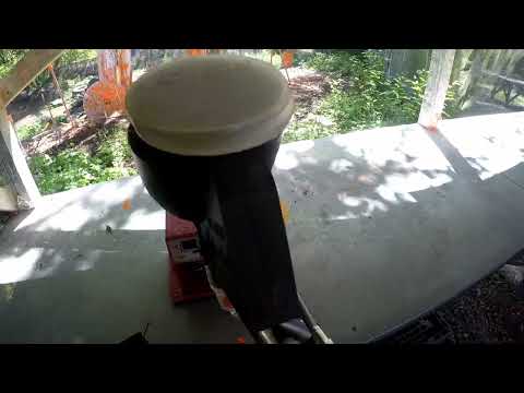

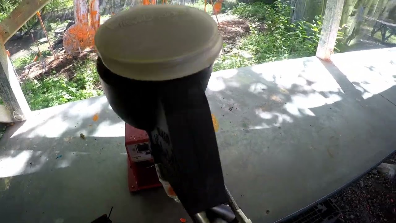

          This is why I use a level 10 instead of a level 7, that is a 9v VL-2000 with the original tiny 2 prong agitator, I am certain I would have a paint blender shooting like that with a level 7 bolt

            If you can do that with a mag's heavy trigger pull, you'd be an absolute terror with an upgraded EMEK.

            I mean I shot the Emek but, I am just not terribly impressed with it, maybe the deadlywind valve makes all the difference but, by the time I am done with this classic mag I expect to get a much higher fire rate with it

          Hey, the '90s called... they want your trigger technique back. 🙂
          I've never actually seen someone fan a trigger like that, until now.

            Lol it took me many years to get it to were I can actually hit something with that trigger technique I am not gonna stop now
