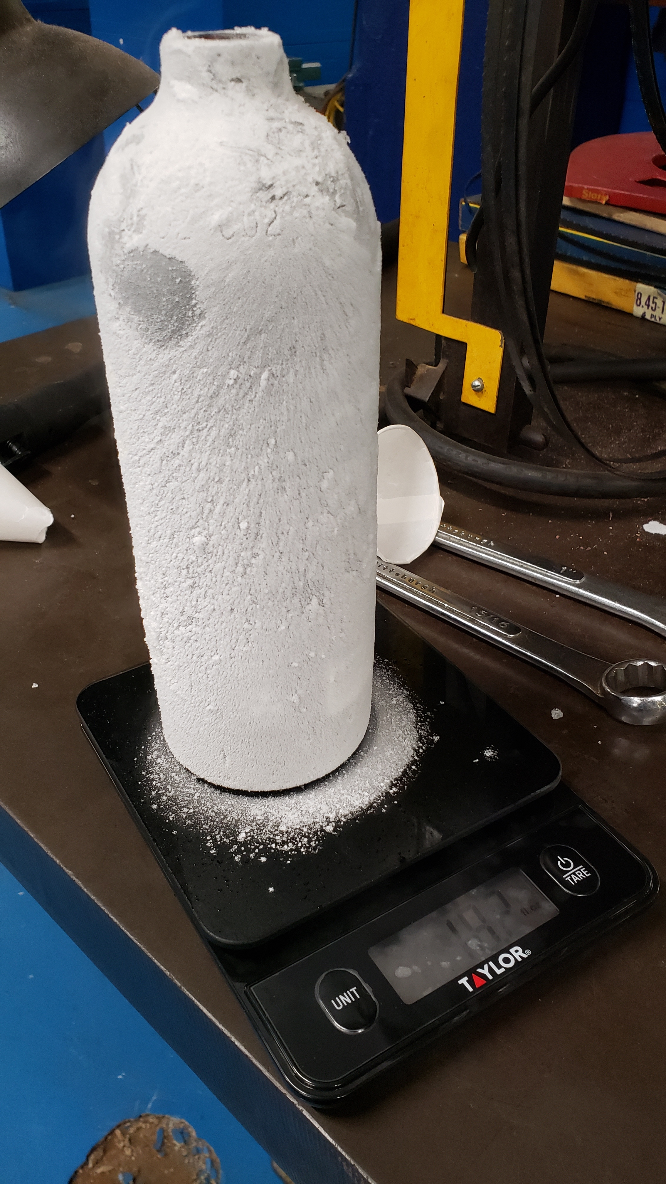

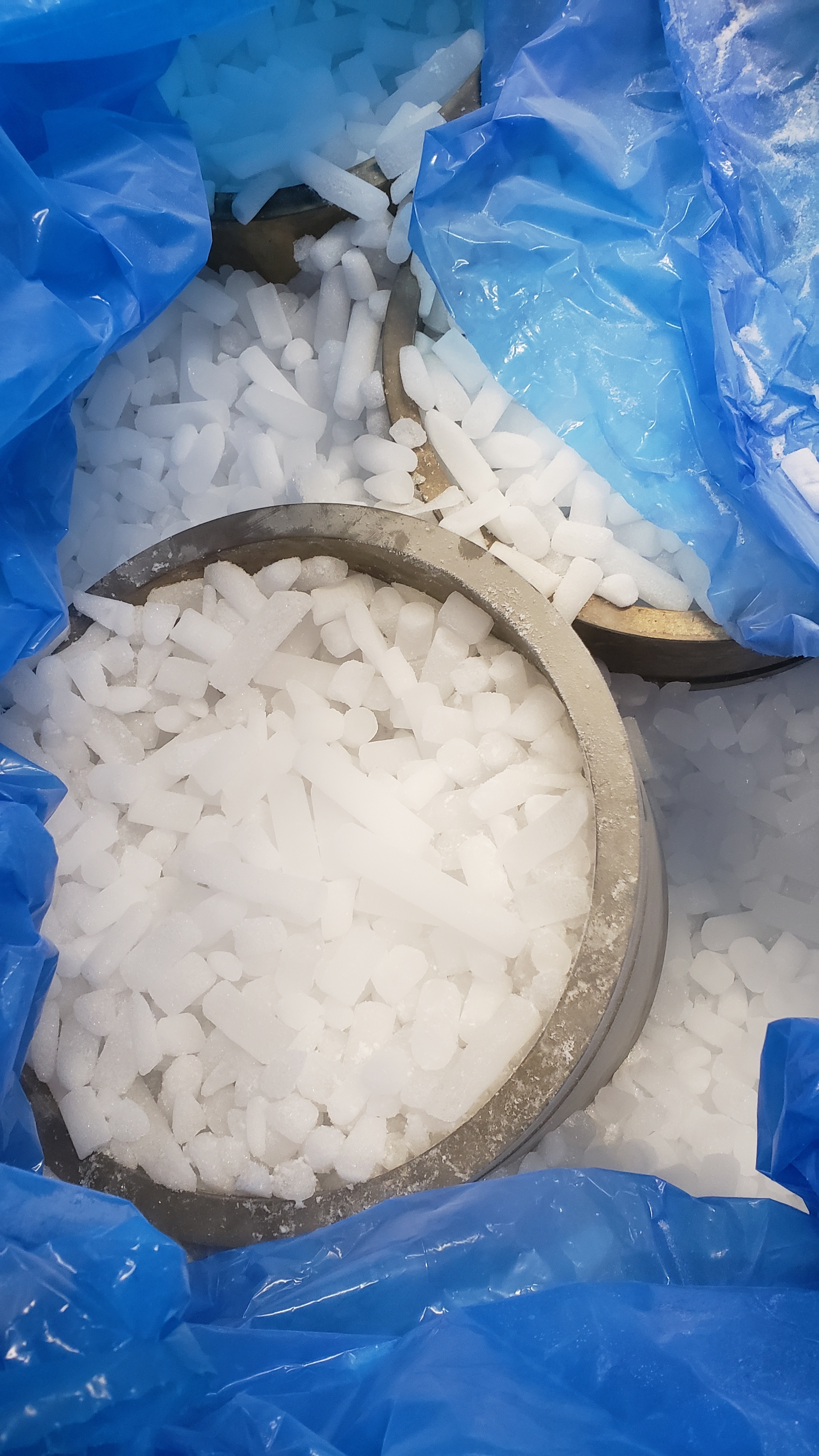

    At work, we picked up a few hundred pounds of dry ice pellets to cool some bushings we need to replace. And I had two 20oz-ers sitting around, so I gave it a shot. Filled one to 18oz, the other to 17oz.
    Do ya think they'll blow up? Lol

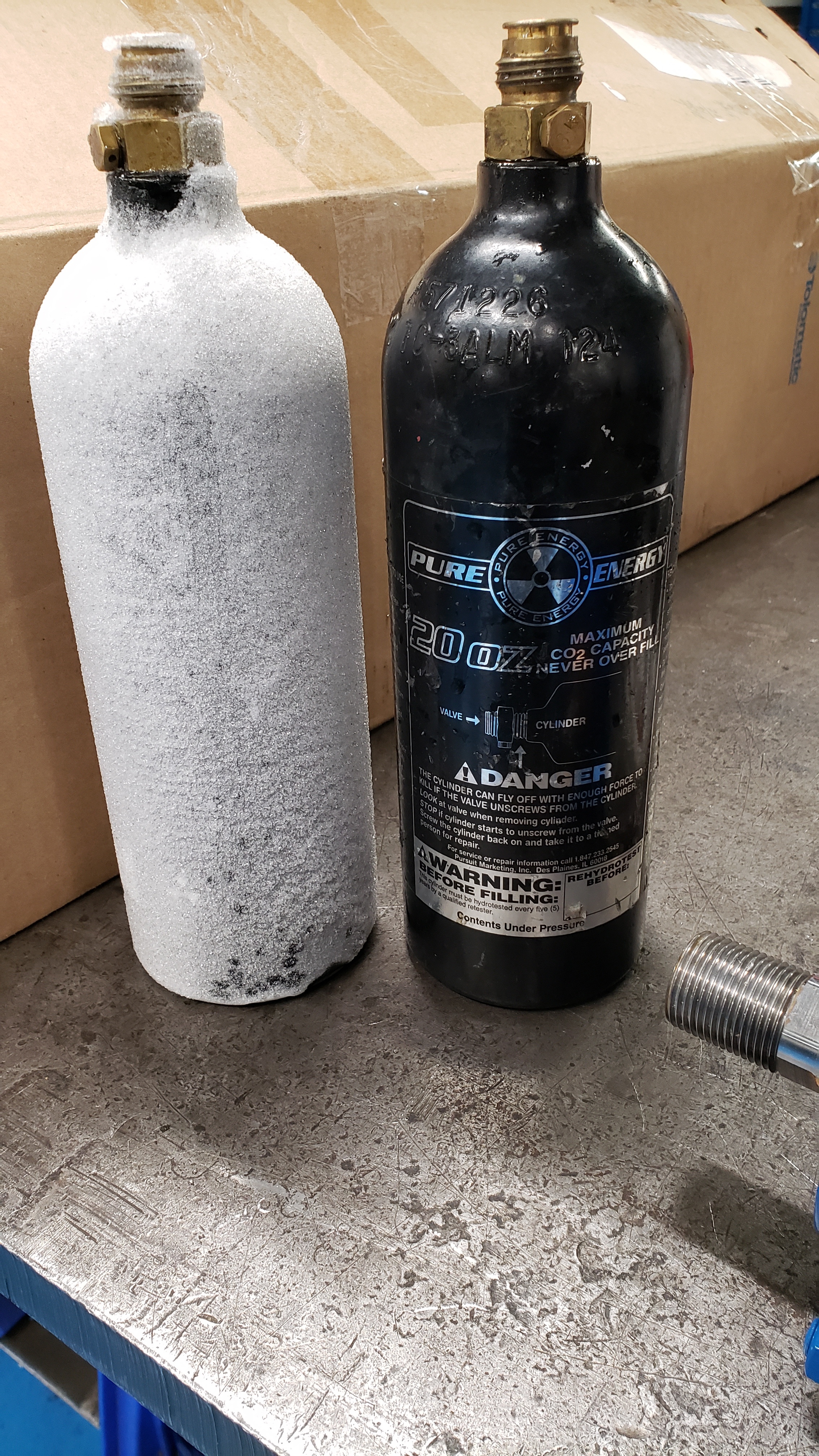

        So far, no explodey. The one filled to 18oz is almost room temp now.

              It's certainly not the most efficient way of doing things. In the time it took me to smash down the next round of pellets into a funnelable snow, about 2oz of the previous fill would have gassed off. It probably took me 6 or 7 rounds of smashing and filling to get them up to about 18oz. Maybe 30 minutes each tank total time.
              But it was free from the company, and I did it on the clock. So I benefited. Lol

            Well it's been a few days and nothing's burst or ruptured. I even used one yesterday to troubleshoot an Illustrator clone of mine.
            I'd call it a success.
