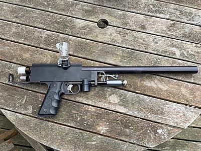

Can someone please tell me what I have here?
  • Lurt
    Member
    • Nov 2020
    • 11
    • New Zealand

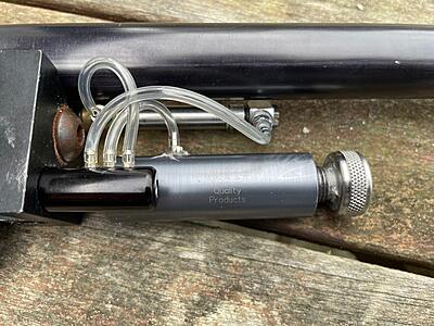

    I know its a Autococker, more just wanting to know what the vintage is and a little about the accessories that are on it and if they are any good. Its has a benchmark slider with a A.N.S LPR I would like to change the 3way and ram to brass, well basically change as much as I can to brass I would be keen on any recommendations for aftermarket parts that any of you guys have.
    Thanks in advance.

    Mid- 90s body. Pneumatics are upgraded from original brass. ANS jackhammer, maybe a clippard ram. No clue about the 3-way.
    There are knowledgeable people than I who will chime in.

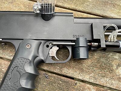

      That serial number puts it at a 1997. That 3 way looks like a Shocktech Bomb. You shouldn't have a hard time finding some original brass pneumatics for it. If you're looking for an original brass barrel I have one I'd part with. Shipping is the expensive part. A bespoke brass back block would look cool. Are you on the North Island?

        Thanks for the information, where did you manage to find the information regarding the serial number? Or is it something that you knew generally. ’m in Wellington NZ, I would be keen to see the barrel you have. Would the standard pneumatics have less performance than the current ones? Or is there not much difference in general.

          https://docfirepaintball.com/blogs/a...er-dating-by-s
          There's a link to the site above. I have one with a similar serial number. The ram and 3 way you have will be better than stock. Here's the only pic I have right now of the barrel...I have two of the same. I have a Niece who just moved to Christchurch from Queenstown. We send a box there a couple times a year with some stuff.

                The 3way looks like it may be a Belsales Angry 3-way and worth 100 plus to the right person.

                  Benchmark slider are really good
                  LPR is ANS and I think 3 way could be later WGP or AND
                  3 way is not a shocktech bomb, they have a different shape
                  RAM could be clippar or ANS but does not look like its rebuildable, it it leak you will need to change it
                  This website can help you ID lots of parts
                  https://pbase.com/k_macocker/cocker_parts_guide
