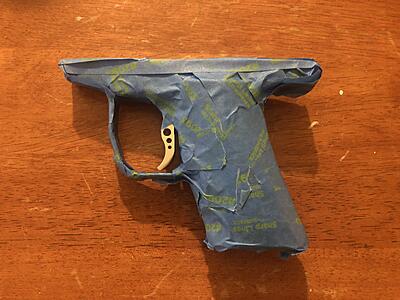

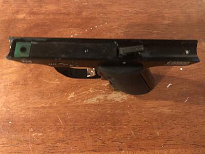

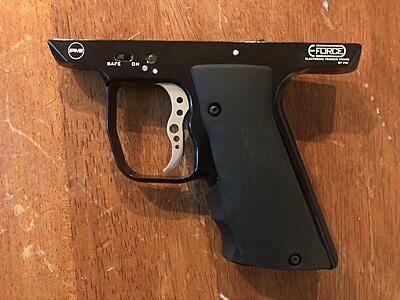

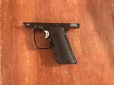

              Weeell MCB, don’t be mad at me haha. Definitely not my prettiest work, but far from my worst either. I’ll prob clean it up at some point, round out the trigger a bit more. I was very diligent about the aluminum dust, confident the tape kept it out. Frame seems no worse for the wear, cycles fine.
