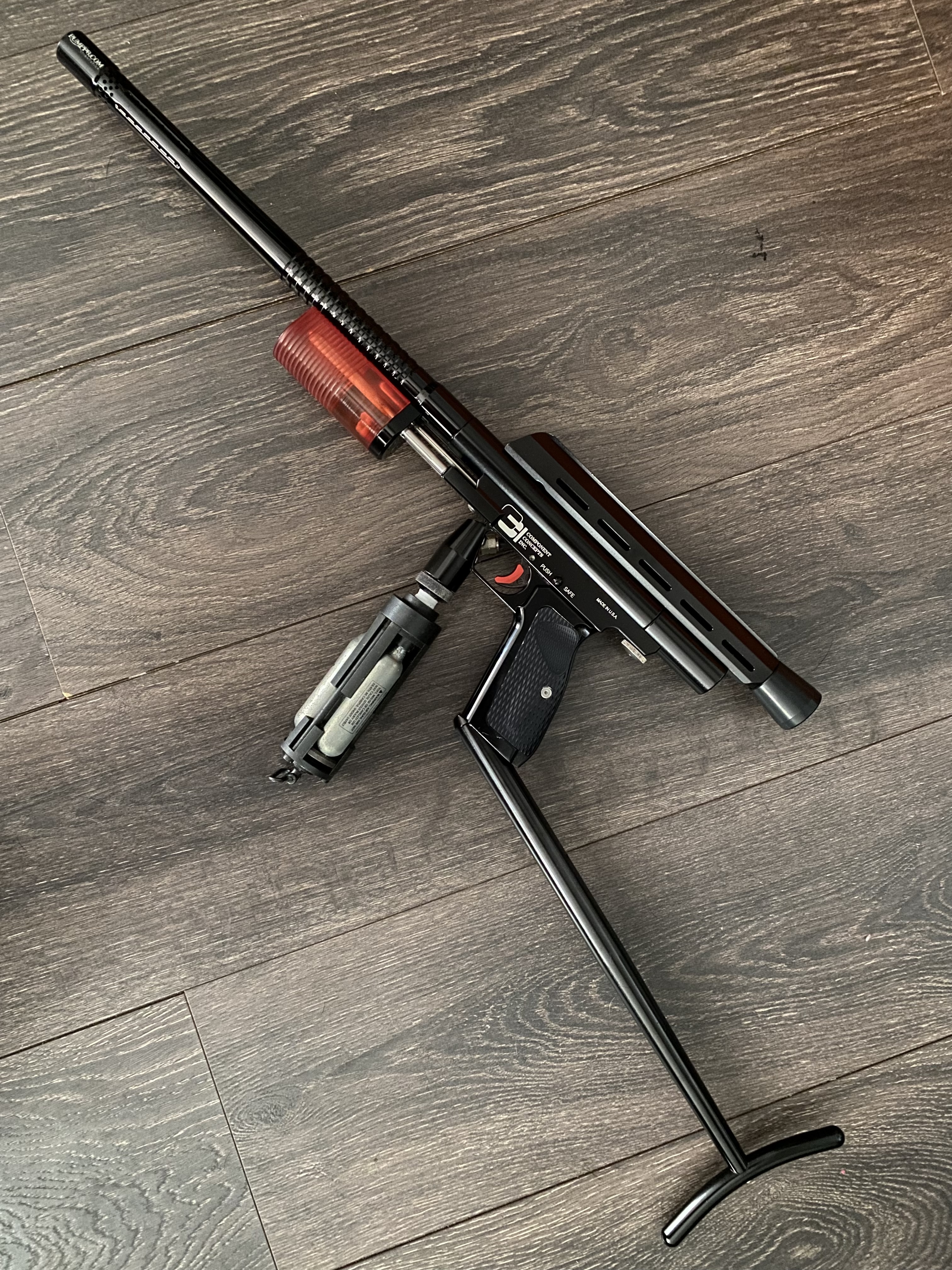

    So maybe I’m just dumb, but ​I just found out these things exist? If I’m understanding correctly, it’s essentially a tube that you load two 12 grams into, and when you tighten the knob on the back it pierces both at the same time?
    Is there a reason nobody (at least from what I’ve seen) seems to use these for paintball? Or any serious downsides to them (other than ofc not being stock class legal)? The fact that I’ve never seen anyone using one at the field makes me a little nervous, but they do seem to be popular in the airgun community.
    If they’re actually solid pieces of gear, I can definitely think of some cool applications for them. They’re thinner than any tank, so for a light, compact marker that you want a little more capacity than a standard 12ey can offer, they seem pretty ideal. And according to the video I just watched about one, you don’t need to use two at a time either—you can also just load in an unused one and put a used one behind it if you only want one.
    So...anyone have any experience with these? Are they...safe? Would I be dumb to put one on a marker?
    I’m honestly pretty pumped to have just made this discovery, but also I’m fully ready for you guys to bring me back to reality if they do indeed suck. But I’m hoping they’re awesome, because they seem kinda perfect for this compact SMG-shaped pistol build that I’m working on.
    So what say you MCB? Yay or nay?

      Makes sense that they aren’t a new thing, I thought it was strange that I’d never seen them until now since they don’t seem to involve any groundbreaking tech.
      What would you say the cons are, besides size/weight? Are they less reliable than say a standard bucket changer?
      Something else I find appealing about them is that I often go play outlaw ball at friend’s properties deep in the woods—and often I’m the one supplying the gear, and I don’t always have time to stop to get tanks filled. But I always tend to keep a bevy of 12 grams with me.
      Something like this should in theory allow most markers to last roughly the duration of one game (these games are always limited paint anyway), and then I can worry about changing out the 12 grams afterwards if need be, so that someone who is playing for the first time doesn’t have to worry about it.
      I also know that it’s simply becoming rarer for fields to continue to fill CO2 these days, and I wonder if soon it will be harder for me to find places that want to fill my 4oz.
      On the one hand I can definitely see how they objectively aren’t better than say a 13/3000, but I think for what I’m looking for they might be great. That is assuming they’re at least remotely reliable and aren’t hunks of junk, which I’m not sure that they aren’t.

          Speed is really the biggest con to them. They are just a way bigger pain in the a$$ to change cartridges and that only gets worse when under stress. Add on top of that the ergonomic limitations just not practical.

          Why 2x when you can run 3x….
          I will get about 120 shots on a 60*-70* day out of this before I have to change it out. It’s great for outlaw play.
          The biggest issue with running multiple 12g is the change out. It takes forever and it don’t make sense to top it off. Let’s say you play a game only shoot 25 shots. You then have to dump a perfectly good 12g for tactical purposes or run on the single till it empty then change out on the field. Your sitting there a long time fumbling with the 12gs getting the marker back up and running. It’s a disadvantage over dumping a single bucket. Or tactical change out before a game. It’s not that it can’t be worked around but it’s not an advantage over a single 12g bucket especially with practice.
          What it’s great for is playing like you have bulk Co2 without the need for the big storage tank or the rental fee on bulk tanks.

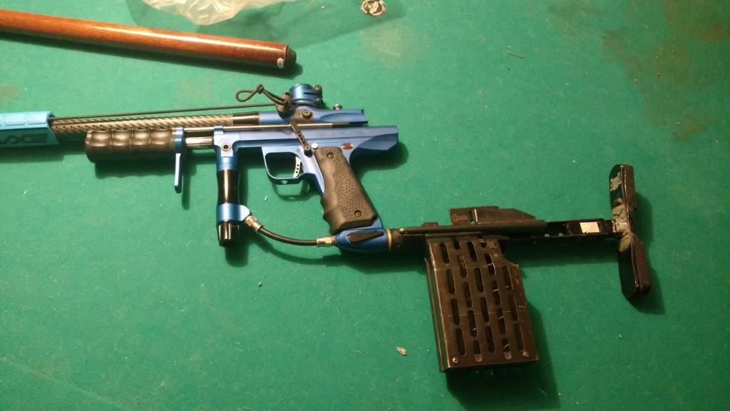

                  Another idea I was just kicking around to cut down on change out time would be to reload the 12 grams from a tube as though they were paintballs. You put two 12 grams end to end in a 10 round tube, and then when you need to change you unscrew the cap on the changer, dump the spent 12’s into a pouch, and then pour the new 12’s in from the tube as though you’re refilling a stock class feed. Screw the cap back in and you’re ready to roll.
                  I just tried this out with two 12 grams and a 10 round tube, and they fit perfectly into the tube, lengthwise. Width is a problem. The tubes I have taper a bit at the bottom, and the bottom 12 gram got stuck in it and was tough to get out. But I figure with a hairdryer and a dowel I could probably deform a few tubes enough that the 12’s would just fall right out, and I’d probably only carry like one or two refills max in a game.

                    Might find a cigar tube that fits two 12g

                      Good call! Something I’m also kinda excited about is that it opens up some new mounting options that wouldn’t really be feasible with a tank. For example because only the end cap threads out, I should in theory be able to affix it with some ring mounts to the side of a marker instead of mounting it as a bottomline. If I’m able to eek out a setup that uses one practically I’ll definitely post it somewhere here. Since the marker I’m planning this for isn’t my main semi or my main pump, I think this should complement it nicely as a kinda “sunday driver” marker—something to use when I either find myself playing outlaw, or against a group of renters at the field. That being said this will kinda sorta be like the third or fourth such marker I own that fits into that category but hey, who around here would say that’s a problem haha.
