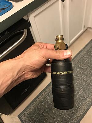

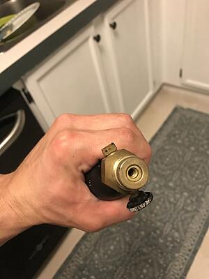

    I found this cheap on eBay and just got it in. The pictures didn’t show so I just noticed It doesn’t have the pin valve. I can see the hole has threads, but I wasn’t sure if the black knob was some sort of on/off they used back in the day.

    It's just a typical on off valve.

      the on/off is built into the tank valve so you can use it in ASA that don't have the pin (like cocker VASA 😅)

        I have an HPA tank that is expired but setup that way, it is cool but more difficult to fill and the air coming out is not regulated. With most old guns that are designed to use CO2 the output pressure of the tank is not a big deal but with the new markers having an input pressure of 4.5k most new markers could not handle it. (The tank is past it's 15 year lifespan and has not been filled since 2010 if i remember correctly.)

      Yep, it's an on/off. Smart Parts made one that was a universal anti siphon tank. Screw it in to the furthest in position where the on/off was oriented upward and turn it on.

          Whenever I see 3.5oz tanks with on/off valves I assume they were used in multi-tank setups.

            The threaded output hole should be able to accept a Schrader valve- that is, a typical tire valve. People actually used those- not particularly wisely- back in the day, and in your case, it could be a "back up" seal against a very-probably leaky on-off valve.
            Yes, you can screw that straight into a Phantom or pretty much any other Nelson based pump, or conventional brass.
            Second, peel that tape off before you try to fill it. The bottle qualifies for the 2" rule, but somebody may have scarred or damaged it- or even tried to drill it or something stupid, and hid it- or even tried to "fix" it! - with the tape.
            Chances are they just put it on for padding, probably because it was used on the front of a VM-68 or something and became a sort of front handgrip, but it's worth checking. (And it's just cheap tape.)

              Assuming the bottle is good, a standard pin-valve is more reliable. Over the years, the only on-off valves I ever had that never eventually leaked, were the original "Thermo" valves, the giant old-fashioned ones.
              A little 3.5 like that with an on-off, was generally used for a dual-bottle setup on a VM-68. You'd screw in the little one as a foregrip, and to "block off" the front ASA, then you'd screw in a 20 at the back bottle or bottomline ASA. The valve kept the little tank from opening 'til the back bottle could be installed, and most players considered it a "Backup"- you didn't open the 3.5 unless you ran out of gas in your main tank in the middle of a game.
              Doc.

              Well believe it or not, this old ass valve works. Air tight lol

            I am seconding what Doc said. Remove the tape and inspect the tank before you use it.
