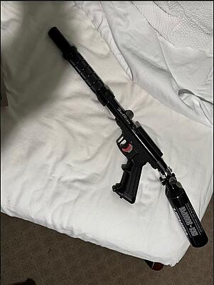

    Hello everyone. So I found a new toy at the shop... The black widow! The price was too good to pass on so I took it with me. She fires up, shoots, and the pump is smooth.
    However.... I know very little about this marker.
    I only know that it's nelson based. It is the unibody design with the integrated barrel. But I'd like to get a few more details.
    • Maintenance
    • What to look out for
    • How to adjust velocity
    Any tips I'd appreciate!

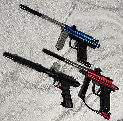

          scottieb here is a picture of my current guns.
          • Top is Spyder AMG with VS2 internals (glaman5266 probably remembers this from PBN)
            • The AMG is still a work in progress. I'm still on the look out for the old Vertical Regulator adapter, but if I don't find it I'll just settle with a bottomline regulator. Or do what I previously did. I mounted an normal regulator in between the fore grip and ASA. It was a monstrosity, but the extra volume allowed for lower pressure.
          • Second is Azodin Kaos with the Zero System
          • Third is the new addition, Black Widow
