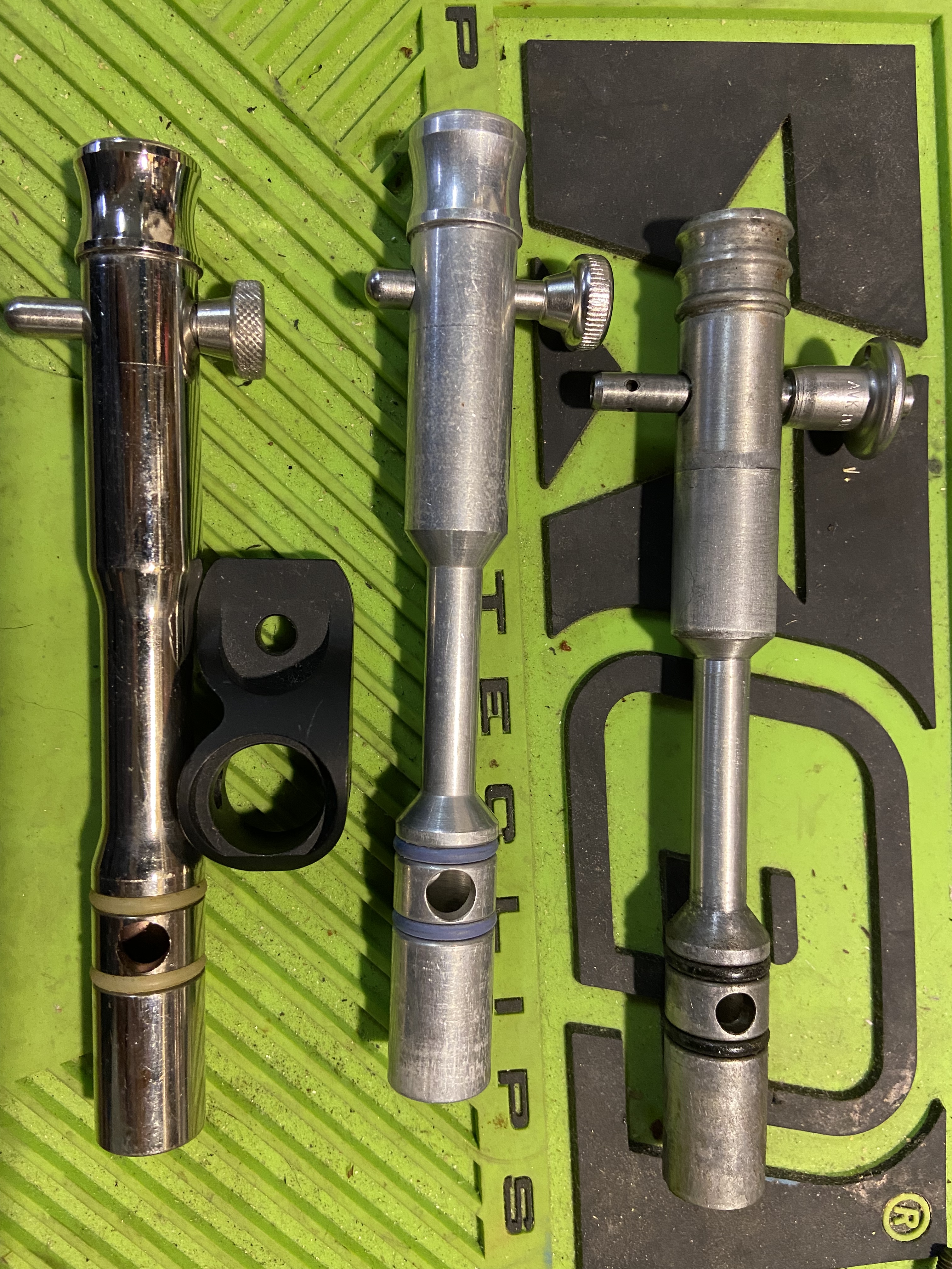

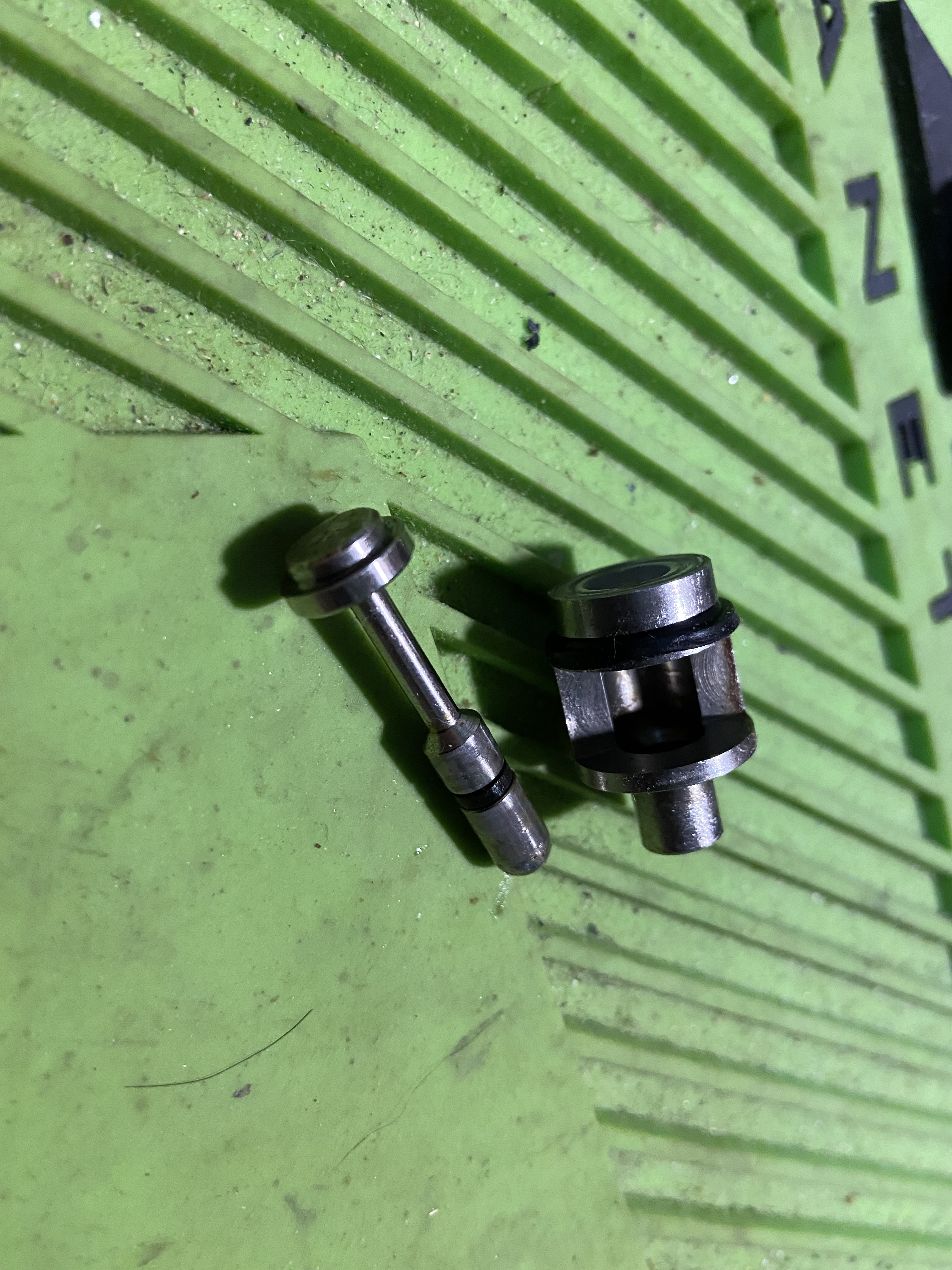

    Looking to see if anyone can help me get proper IDs on a few cocker parts, and whether they are anything special. I assume the bolts may be different stock versions but I just don’t know.
    —3 different bolts, the top is slightly longer than the bottom two and was pulled from a pre2k body.

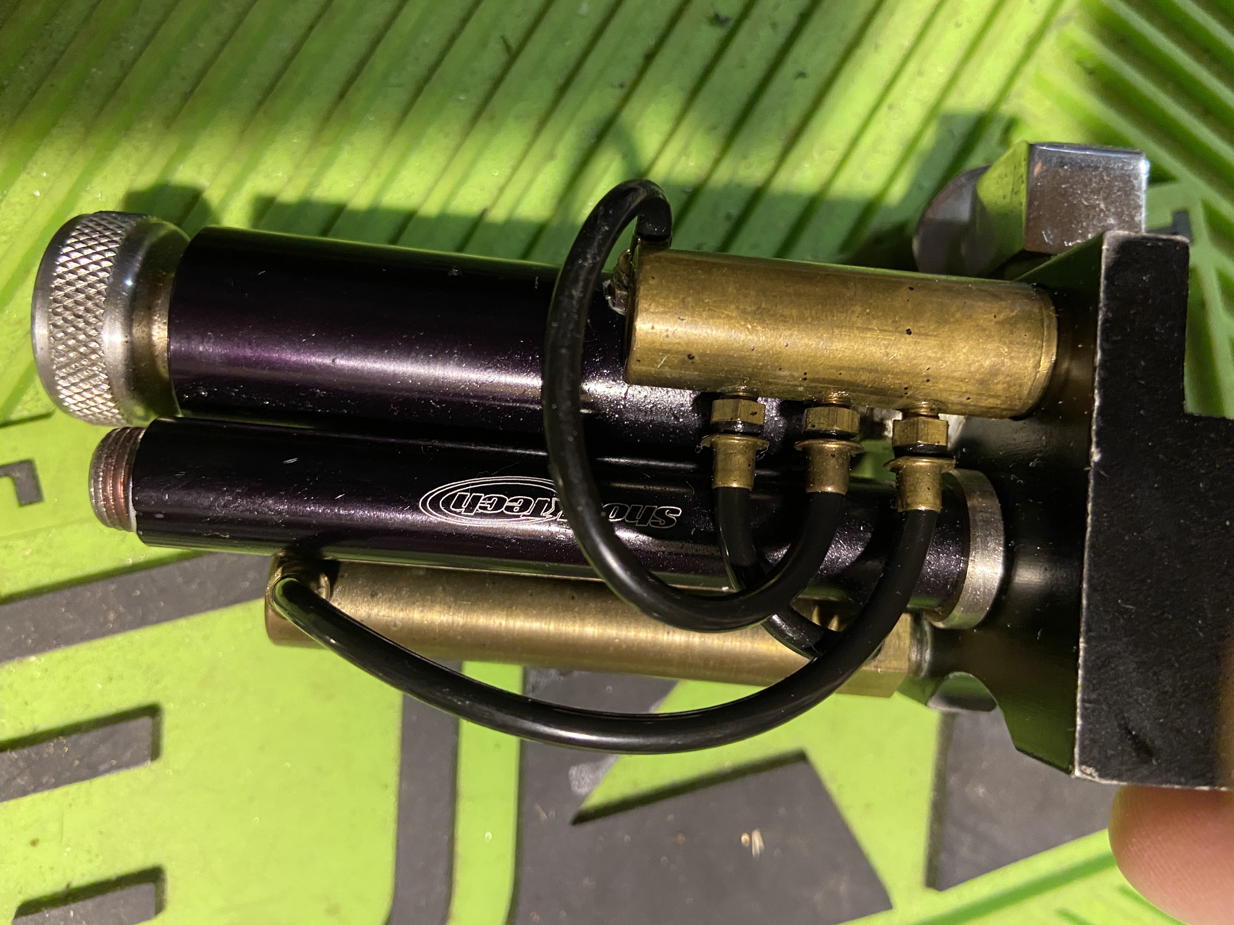

    —what is the Shocktech part in this front block? Just an LPC or what? Any value to it?
    —Lastly the valve. I believe it’s a Shocktech rat valve? Value again here?

      all WGP/STO bolts, the polished one and the ribbed(pre2k) one are older. shocktech lpc, ans lpr, rest WGP. lpc maybe around 25? (pre2k is more rare). looks like rat valve, older style, not really desirable imo due to outlet port design, value? 25 or so?

          The valve is a RAT II. Obviously the second version before the RAT 3:16 (the current version) came out.
          As for the bolts, the far right (pre-2k) is a stock bolt from 98. Only year they did the ribbing. The chrome one is probably from a Trilogy Sport, based on the size of the inlet hole and how much it necks down in the middle. The last one could be from any stock gun between 2000 and 2004.
          As mentioned, the Shocktech part is a pre-2k LPC. Looks like an older one. Funnily enough, their later LPCs are literally just a ram body with a plug.
          Not really sure on value for anything, but I wouldn't expect more than $25 on anything.
