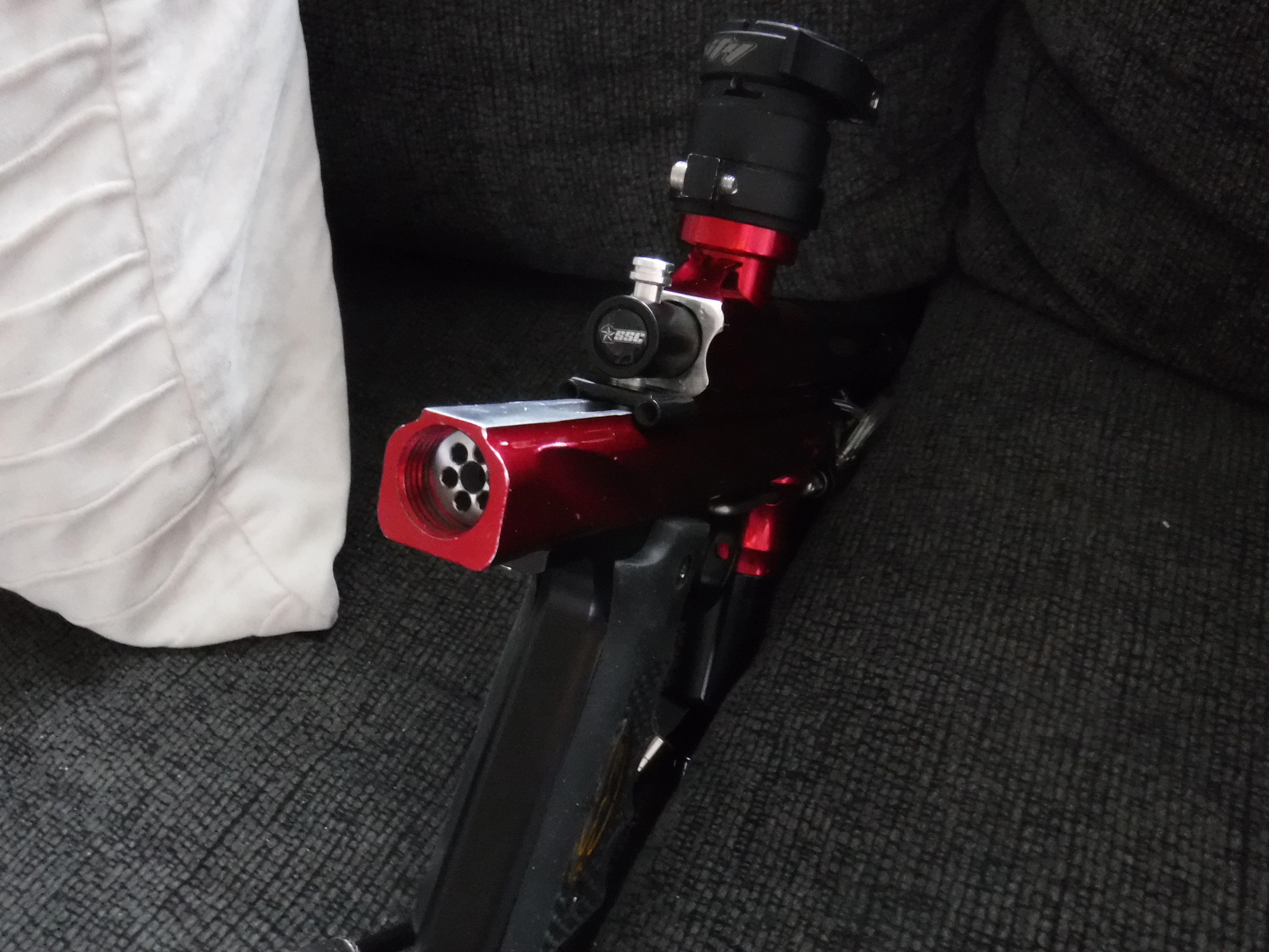

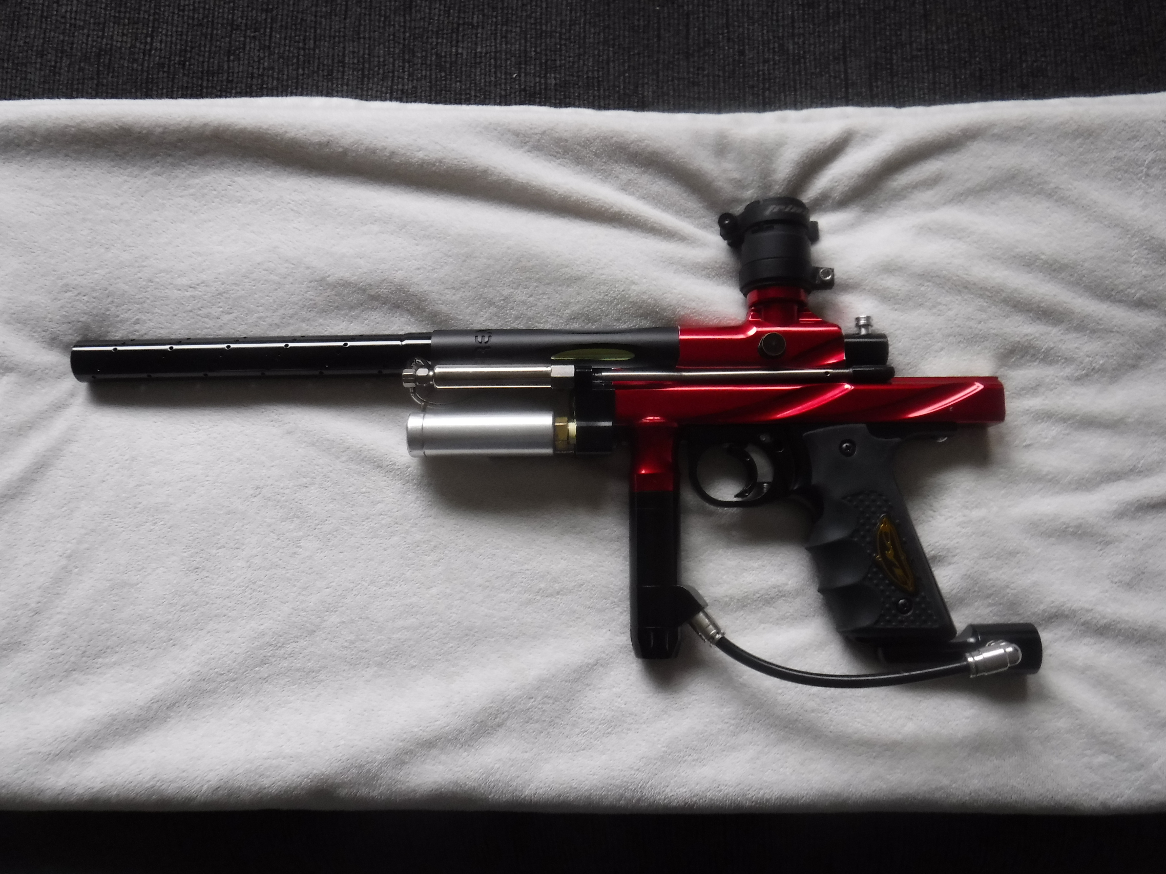

    Yo, I have been working on my half block build this week, and I have a functioning autococker shooting 280 , but I wanted to learn more about cocker fine tuning.
    I believe i have the HPR sweetspotted , the fps will drop below 280 if I start increasing pressure at the HPR.
    But the ID HPR is about 1.5 turn away from being flush with the bottom of the reg, so I must have a pretty high pressure going into the gun.
    And look how far the mainspring is turned in ?
    Is that pretty typical number of turns in?
    Edit: I do have a brand new Inception heavy hammer installed in there, and it is about 45 grams, compared to stock hammer which was around 39 grams.
    The hammer is still pretty easy to cock back by hand. My pre-set WGP lpr is having no problems cocking the hammer with that spring tension.
    Anyhow, the gun is consistent, and I could go play today if there was a game, but would like to tune it better if possible !
    Ideas please? Thanks, M7
