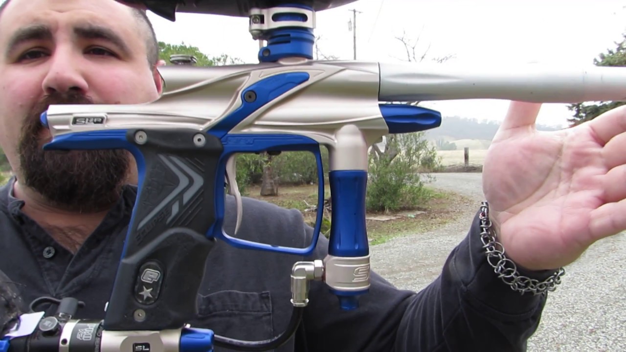

                egos are the AKs of paintball, they shoot semi accurately, faaast, loud, and super reliable. You can burry it in sand and it will still shoot.
                Tim's 3 finger semi-auto savagery sums it up - (I own this one)
                • Impactfour
                  Impactfour commented
                  I quit competitive paintball right around when everyone and their mother had an ego that sounded like that one. I just had some serious flashbacks to 2008.
                  Dye UL and the LP valve and it takes the bark right out of em.
