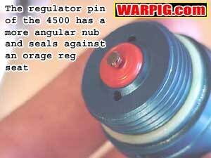

        It is unsecured, but the old war pig page still has pics...

          Interesting. Didn't know about the potential change. If I had to guess, the white was was later, and looks molded- if that depression is from new, not because it's used. I'll crack open that second one and check, maybe by blind luck I got one of each.
          I've still got two on their way to ya, Supes, if you could give 'em a good flogging and let me know how they stand up. If not, we can try harder or other materials.
          Spider- I'm seeing the page, but none of the pics are coming up. If you can see 'em, do they show a red or white seal?

          • Spider!
            Spider! commented
            Red.
            The only way I see the pics is on Firefox and I hit the little source icon on the right of the address. I guess the pic server is not secure.
            I had to look that button up. It's "reader view - F9" in Firefox.

          • DocsMachine
            DocsMachine commented
            Thanks! And since the Warpig article is an early-release reg, chances are good the red is the first-gen seal, and the white the second-gen.
            Now if we just knew what issues the white one was meant to solve- longevity, probably.
