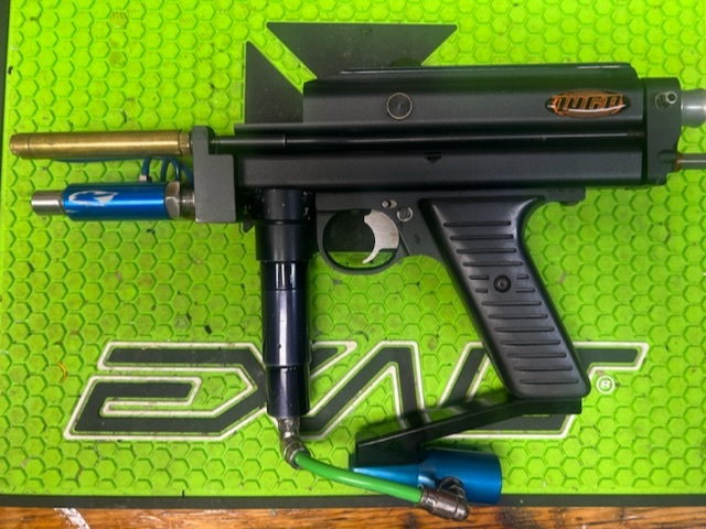

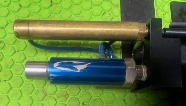

    Tried to a Google but found very little, but have questions about this Kapp LPR:
ID:	391674 First, are they worth using?
    Second, I can very easily spin the silver adjustment piece at the front, like just by hand. There is no resistant. And if threaded in all the way it just bottoms out. Is this normal?
    I do have a 3 piece WGP kicking around, so I can always swap out if needed.

  • Toestr
    • 2877
    • Poland, Onterrible
    Never used one but they have the same theory of operation as all the other Automag style regulators. Strange that the adjuster just freely spins. Is there a spring in there? It might be too weak to hold the knob with friction. The ANS LPR has a nylon set screw for friction. I bet you could put an Automag or similar tournament lock/thumb adjuster on there.
      Cdn_Cuda commented
      It does have a spring and I replaced the o-rings. I don’t have any Automag parts kicking around. I’ll just swap out the lpr.
    • Toestr
      Toestr commented
      You could use a nut as a lock. I don't know if it would have enough threads exposed with the pressure adjusted though. Or maybe it will stiffen up with air on it.
    • Meleager7
      Meleager7 commented
      You could try a little bit of loctite purple as well....since once you find the right cocking force for the ram, you can set and forget

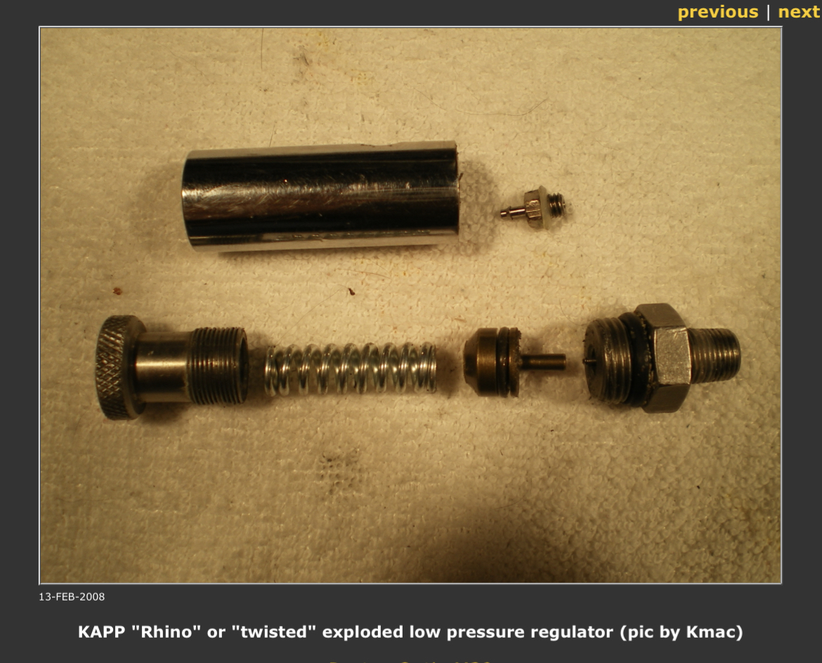

    • flyweightnate
      • 1903
      • Dallas, TX
      Piston in backwards?
      Take it apart and put the pieces on the table - someone here knows them inside out, for sure. It's been several years since I've messed with one.
        Cdn_Cuda commented
        Could be piston is backwards.
    • latches109
      Always Sciencing
      • 2113
      • latches109
        Always Sciencing
        • 2113
        Kapp LPRs work great, my rhino is super stiff to adjust
          • 4560
          Yup, looks like I put it back together wrong. Thank you!
            Cdn_Cuda commented
            And got it back on the front block and works great now! Just need to fix a massive 3-way leak now.
