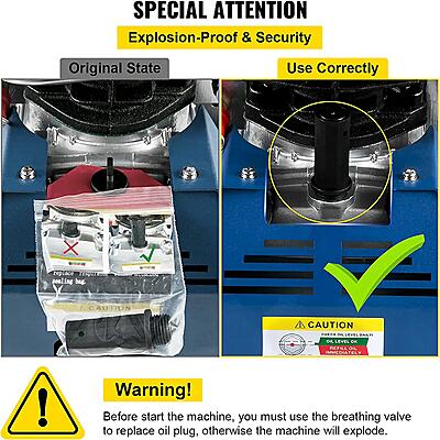

          If this photo doesn't give you the warm fuzzies inside...
          Sorry, given the advertising, I'm betting QC and documentation are a bit lacking.

            Yeah can confirm the docs are horrible. I knew I was rolling the dice. I can’t see anything simple that I am missing here so I think it’s back to the box
