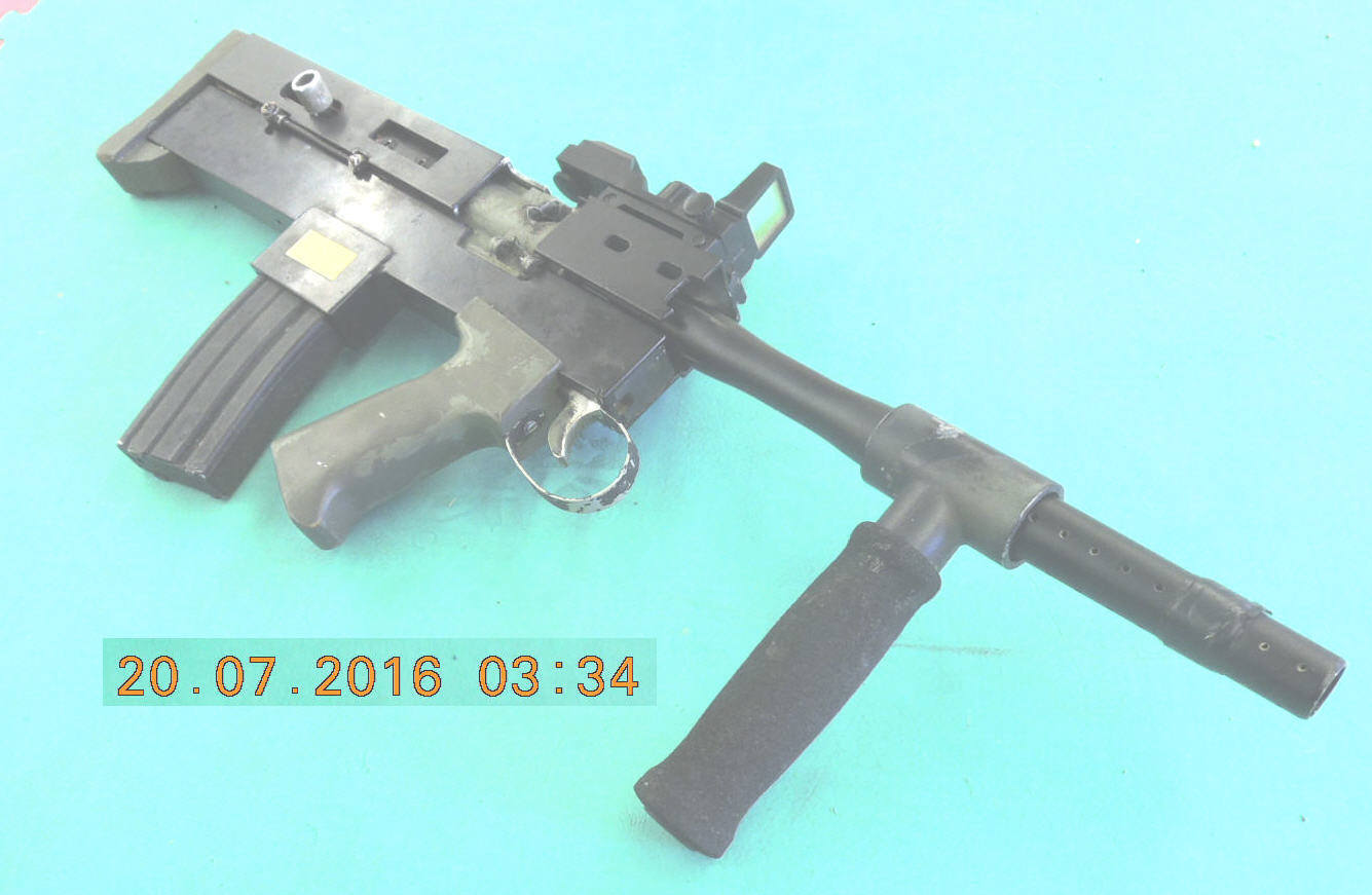

                  like photo but with response setup. I have2 -this is the better one. The other one sputters with a long and a short 8'' barell
                  • COMMANDERBOND
                    • 160
                    • NS Canada
                    actual markerClick image for larger version

                    • Myrkul
                      Myrkul commented
                      I would very much like to see the internals on this. More pictures please.
