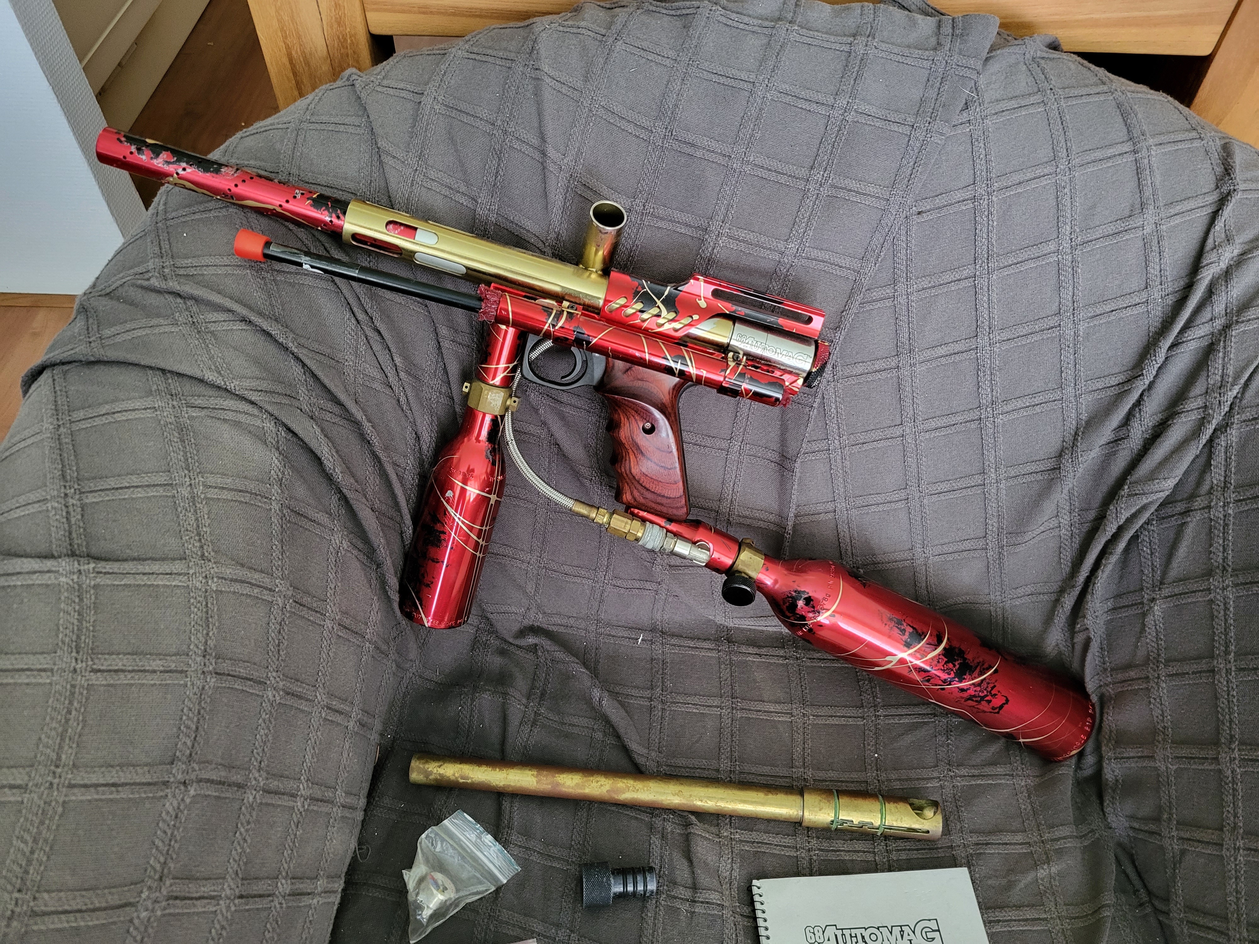

    The crew is still working through our FBM Spyder builds and I have recently felt inspired to finally have a marker with a matched anno tank. The thought here is to get an old 7oz and perhaps a 17ci3k tank done to match.
    A couple of thoughts and questions to the group:
    1) My 17ci and 13ci tanks are painted with the standard epoxy style coating newer aluminum tanks tend to have. Did you strip this before anno? If so how?
    2) Hydro: Did you bother to rehydro any tanks (even though they are 2") before or after anno? I have my thoughts here, but am curious about others.
    I have to thank FiXeL for re-inspiring me to pursue getting a matching tank. Your minimag post just hit the spot for me (pic for pretty pretty reference)
