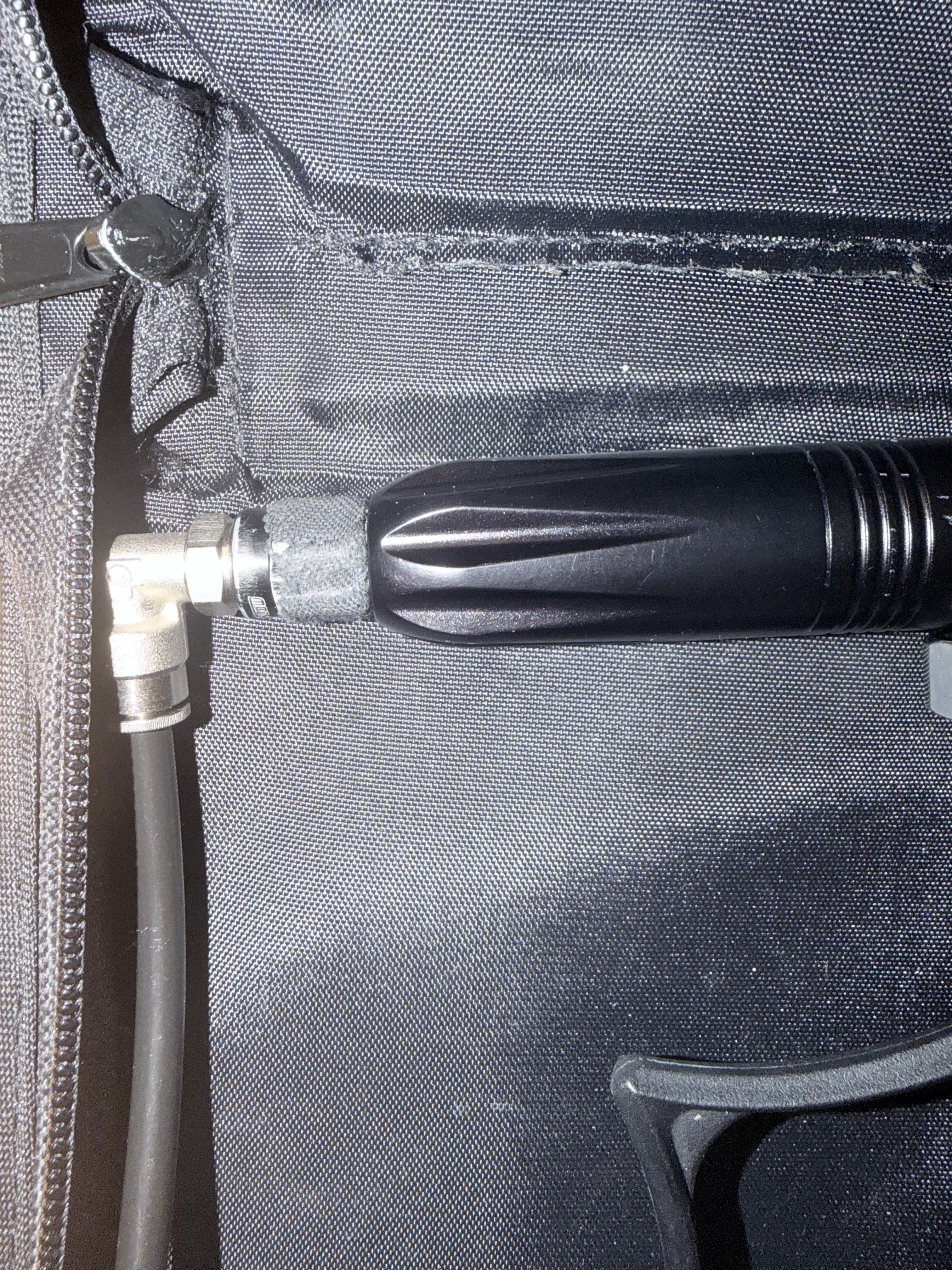

          Sorry for da necro but just thought I’d share a solution since I found this thread when I was searching for a fix. I ended up using an Aeroflow 1/8 npt thread extender. It’s anno black and fit perfect. Ignore that black hockey tape covering tool marks
