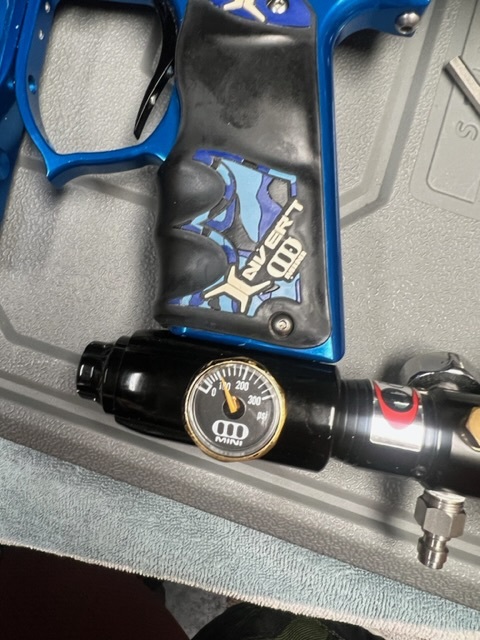

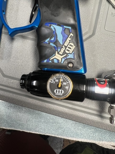

    Rebuilding an Invert Mini that’s been a challenge. Had adjusted the main ref to sit at about 200, but my recharge is horrible. After pulling the trigger it takes about 15 seconds for the reg to recharge. Multiple shots drop the pressure below 100psi, with balls just rolling out the barrel.
    Anyone know what my issue is?
    Before the trigger is pulled:

    After the trigger is pulled:

    Probably the reg seat. Whatever it is you will have to pull apart the reg.
