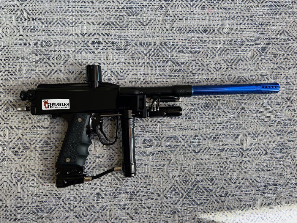

                  • 2111
                  Click image for larger version  Name:	IMG_2357.jpg Views:	0 Size:	464.8 KB ID:	434923
                  This is a true slab side pre-2k center feed. ^this body is rare.
                  I think a meteor would be the easiest route. It’s already milled for empire and the red tube is pre-2k ish dimensions. Expansion would happen at the spring perch to valve face.
                  pre-2k center feeds:
                  Aka revenge v1,
