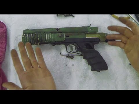

          Bacci did a good video. Full internals, pop out thecsear and use the 007 sear. You need to trim some material off the top of the sear toget it to work.
          I did ponder using the CCI trigger to avoid needing to modify the sear but that's going to be way more work than modifying the sear.

                  I asked Dan Bacci about it in 2013 (!?!!) and he made this video which I think is the one Nish refers to
                  But, it doesn't answer your question about parts.
                  If you're changing to all-modern internals to get the anti-kink features and the TPC, you need to swap out the bolt assembly, hammer assembly (with swapped sear), and short phantom power tube (the modern standard). I am not sure if you need to change springs, but I would go ahead and do it because it can't hurt and the old ones are probably crusty anyway
                  There are other combinations of older parts that should work (e.g., old pre-TPC bolt with long Nel-Spot power tube), but I assume you're going for all-modern parts to get all the benefits of Mike Casaday's innovative brilliance
