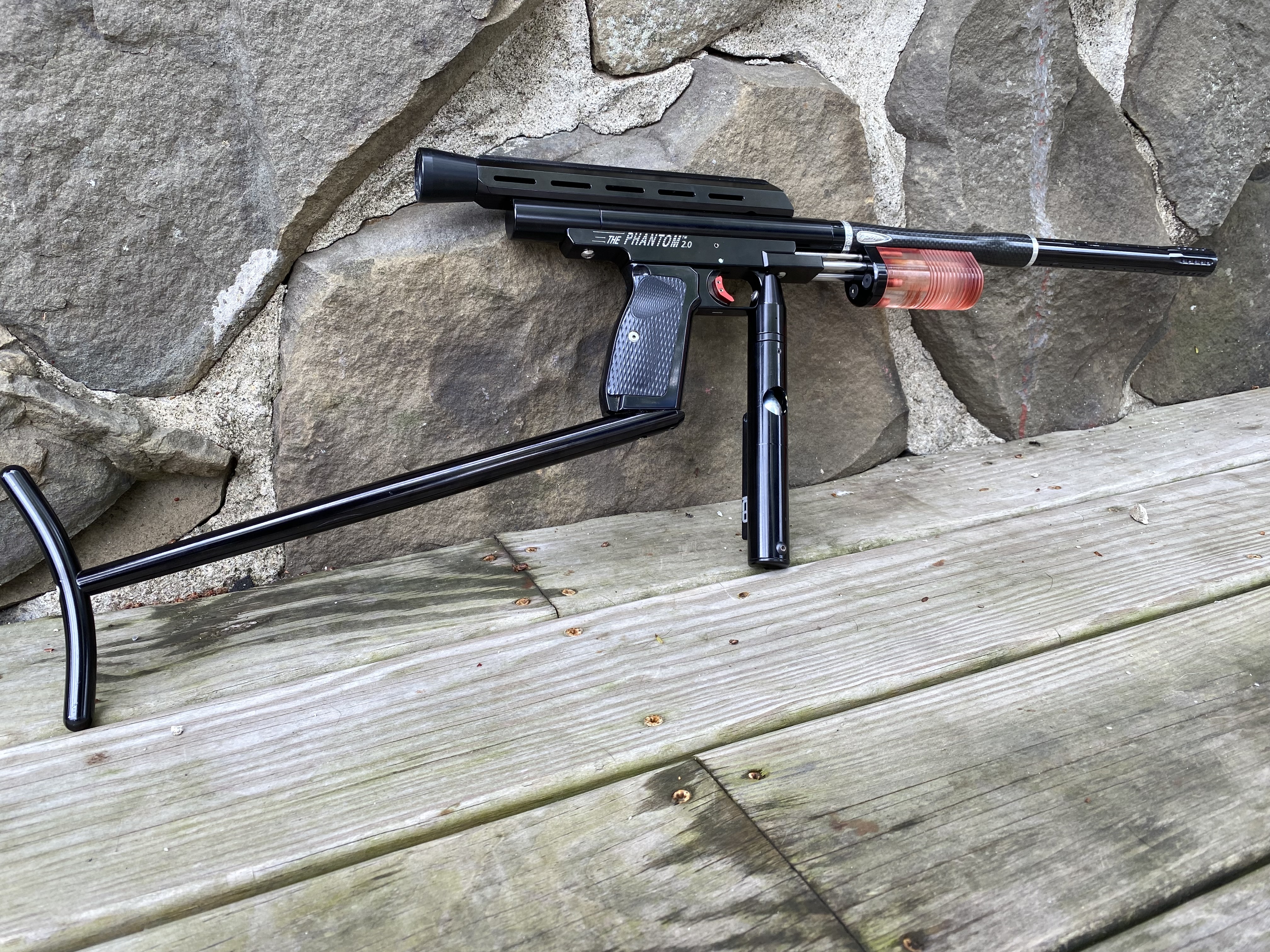

    I installed the set screw on my phantom 2.0 grip and no matter what I do it still leaks. I’ve tried a few types of Teflon tape but can’t completely seal the air. Any ideas?

    loctite 242. which i believe is the sealant.

      Loctite 545. You'll never go back to Teflon tape after using it.
    • 6401
    I had to chase the threads on mine. I ended up stripping the grub screw out so I removed it. Chased the threads with a tap and re installed a new grub screw. I used Teflon tape on mine. But it was a pain in the but my to get to seal up. I would have plugged the frame at the base but I wanted to use my CCM 86 grip instead of the 45 with the 2.0 setup.
    I put it under water after I finally got it just to make sure I had finally got it sealed. It took me way longer than I want to admit. But it’s definitely worth it, it looks so clean without the hose down the right side.

      On small set screws the tape likes to bunch and walk if wrapped with the thread direction.
      this might seem like a silly question, but did you put the teflon tape on in the correct direction?

        Quick tip: Teflon tape doesn't work particularly well on straight threads.
        It works on tapered threads- that is, pipe threads, the typical 1/8" NPT or National Pipe Taper- because the threads, of course, get tighter as it's screwed in. That compresses the teflon into the grooves and creates the seal.
        Straight threads don't do this. When a straight-thread setscrew tightens into a hole like that, it simply runs to the end of the threads- but there's still clearance to the thread root, which gives the pressure basically a spiral path to leak through.
        Setscrews are better sealed with a Loctite or similar sealant- and I've found that, given clean threads, blue works just fine. I've tried the thread-sealant specific Loctites, and they work fine, but at least in my case, the standard blue tends to be easier to find on the local shelves.

          I tried blue first but that’s when I ran into the issue and stripped the supplied screw itself. I couldn’t get it all the way in and it needs to sit completely flush. So I had to flatten the sides to get a good grip removed it and checked to see if I cross threaded it. I didn’t but the threads were so tight I couldn’t get the sealing screw in it so I used a tap chased the threads and was able to get a replacement in and seal up this time I used tape.
          Not sure if it was a manufacturer issue or just me being ham fisted. But I got it to seal up. I definitely would have preferred to use some loctite instead.

            Ok thanks for the tips. I got the screw all the way screwed in and it still leaked. I tried using teflon tape and wrapping it both directions but that still didnt work. Ill try locktite tonight.
              Thread locker is always a better option for the reasons posted above. It’s also cleaner fit. Make sure you let it setup by the recommended time before adding pressure to it. I used Teflon because I was impatient.
