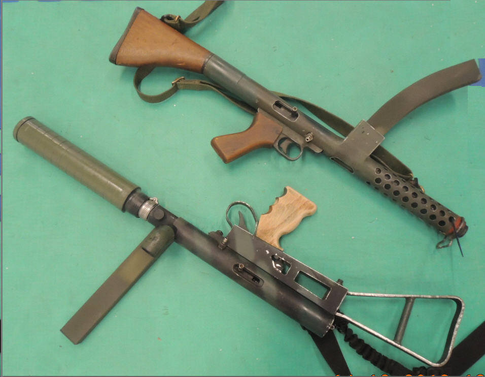

                    anyone able to seal4 or 5 mokals and test them 4 leaks. they wer in my favorite modded markers.
                    image.png​
