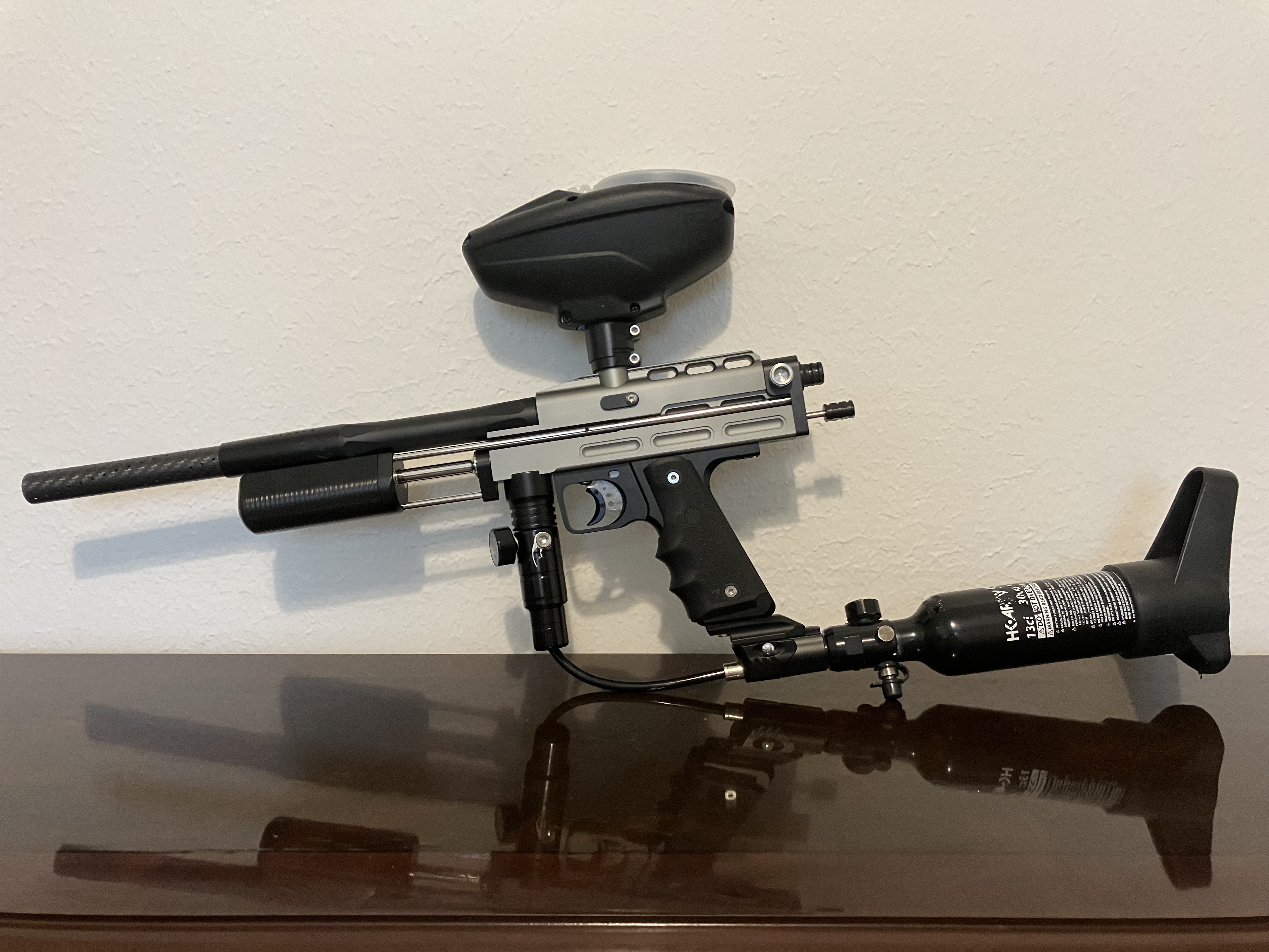

    Hoping to leverage some expertise on this. I’d like to put CCM SS25 lowers in my Meteor autococker pump. I talked to Laurie about it and she isn’t sure if they’ll work or not. I know that the Meteor has an 11/16ths valve which CCM can provide. Outside of that, I can’t think of why it wouldn’t work but I’m guessing I’m missing something.
    Do any of you happen to know if CCM SS25 lower internals would work in pumped Meteor autococker or not? Thank you in advance for any and all help; I really appreciate it.
