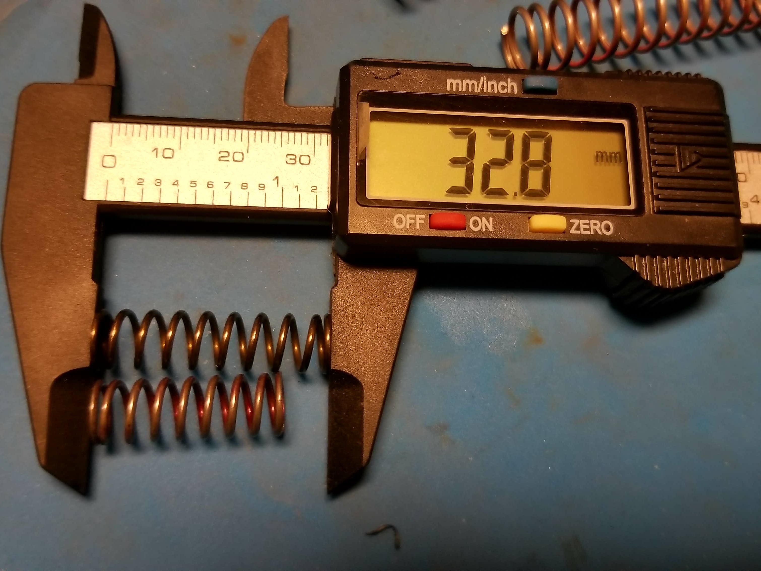

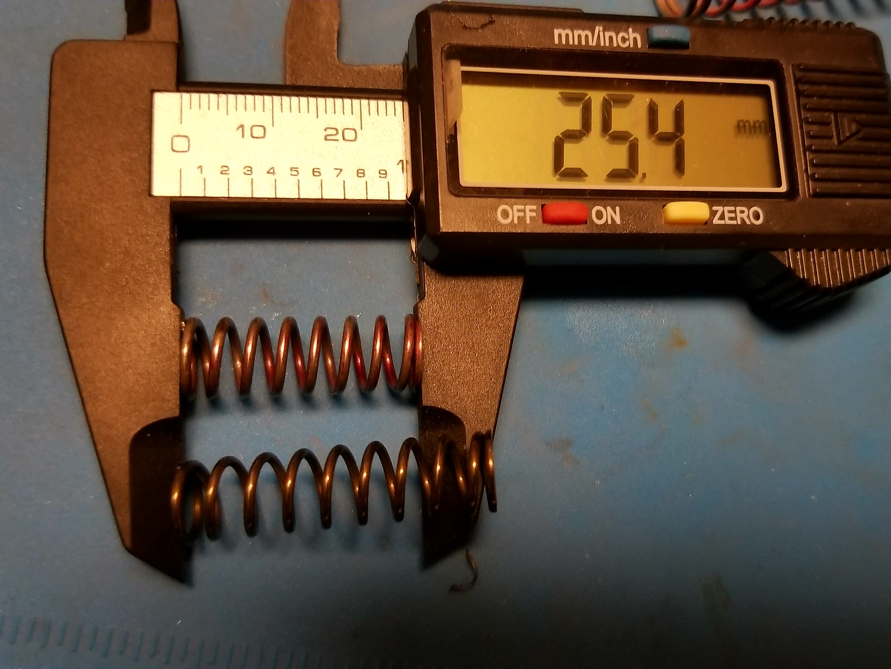

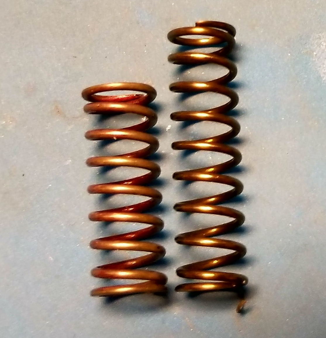

          Ok I finally got some pics and measurements.
          Pre98 valve spring (red madman) left, post99 valve spring right (stock wgp).
          Pre98 is 25.4mm and Post99 is 32.8mm
          Velcor will save us...
