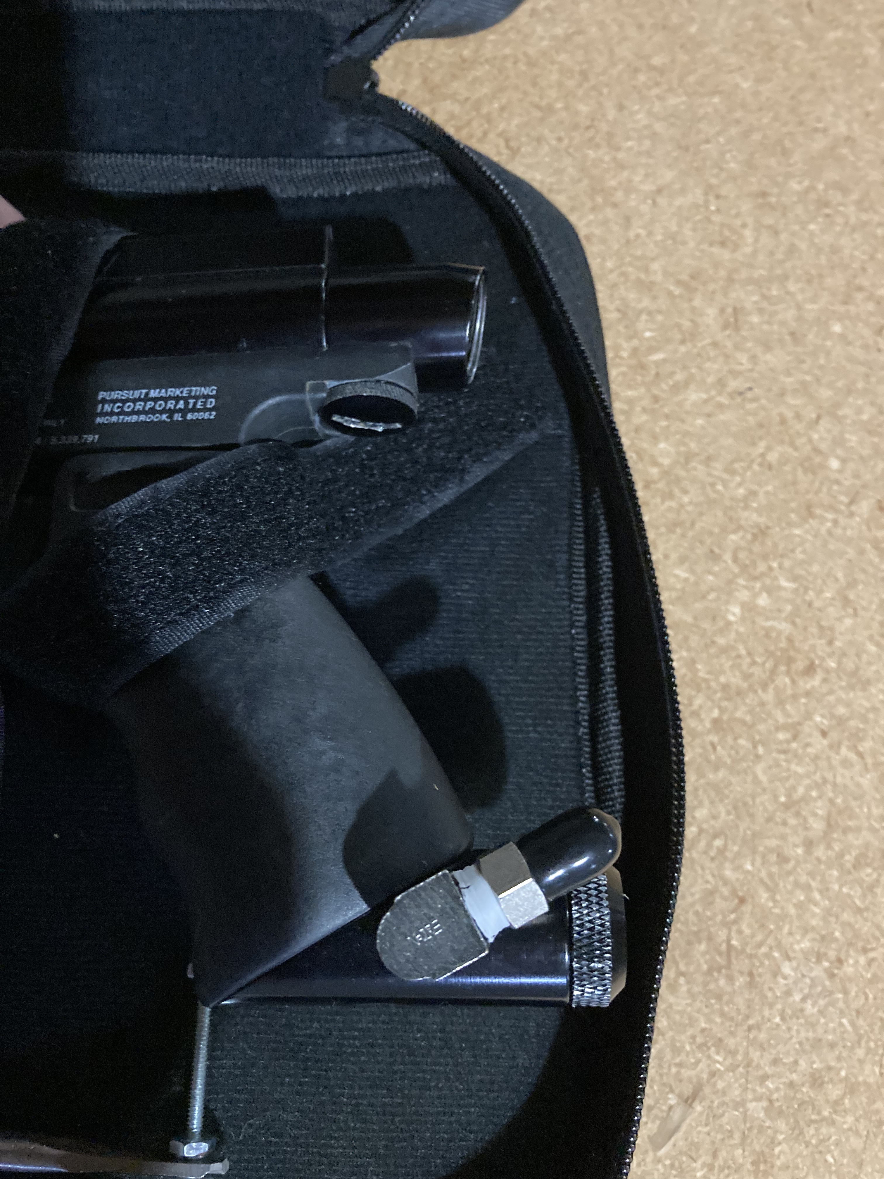

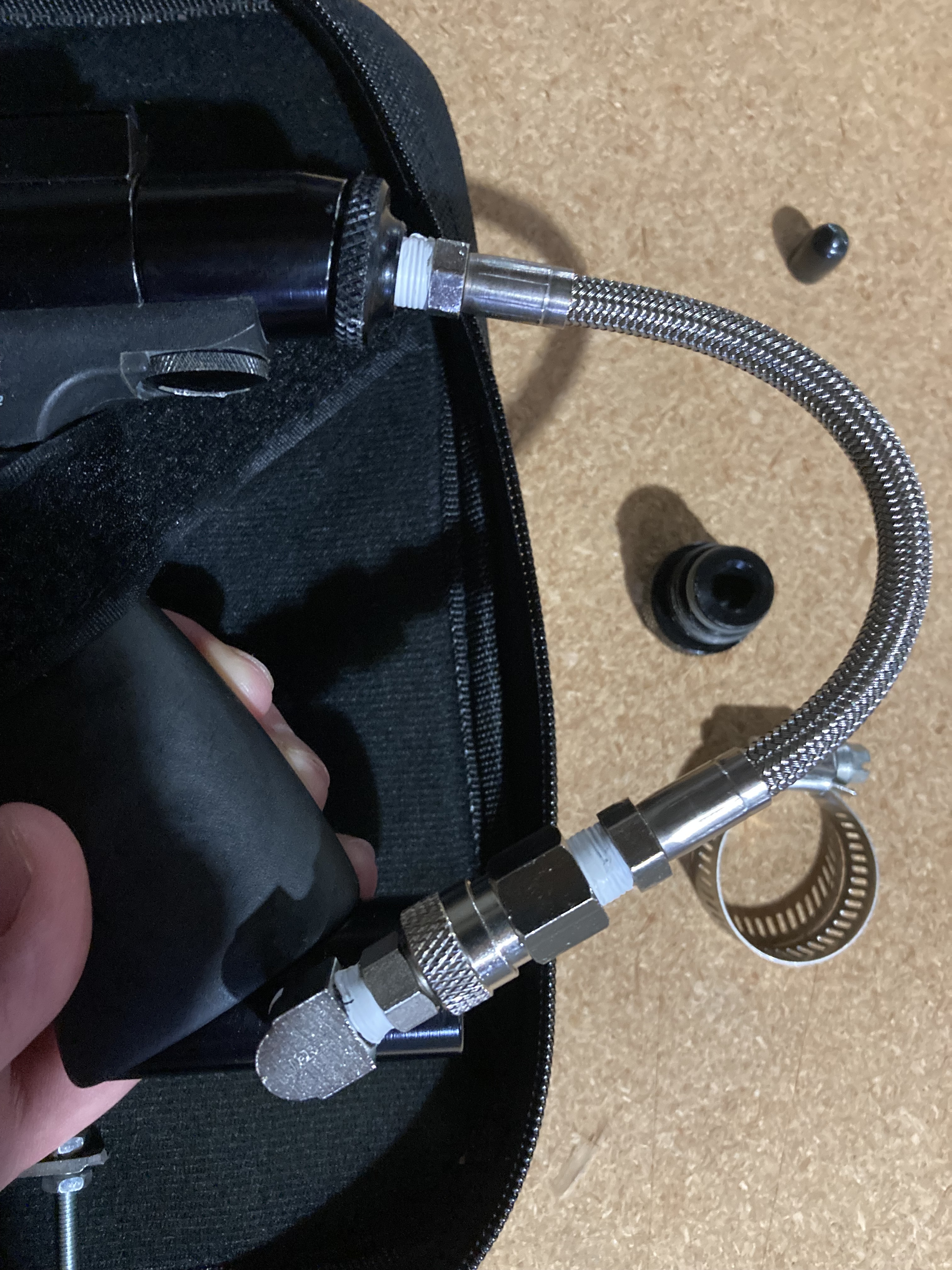

        EDIT: One thing I noticed when I made a bottomline setup for mine is that if you loop it backward down to the grip make sure it doesn’t swing by too low that there’s no clearance for the bottle’s full nipple or burst disks when you screw it on. Probably more of a concern with braided line and Q/Ds though. And I run co2 on mine, so no fill nipple.
        If you’re looking for ideas, I made mine “convertible” so I can just remove the hose, plug the bottom Q/D & ASA, and throw a bucket changer on the back for stock class.

          If you run it on co2 the pressure can spike and blow the macroline and/or dry the orings in the fittings out over time
        • glaman5266
          glaman5266 commented
          What Psycho91 said. It’s not recommended you run co2 through macroline. That and I simply prefer steel braid on almost everything I own. I just like the durability.
          If you plan on running your Trracer with HPA only, by all means use macroline.

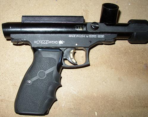

        Here's a trracer I used to own with a CCM 86 grip for a Phantom mounted. Not a 100% perfect fit, but close enough for me.
        Though technically I don't have this gun any more, I kept the grip and replaced the trracer with a Kingman Hammer, just to get an easier to find barrel thread.
