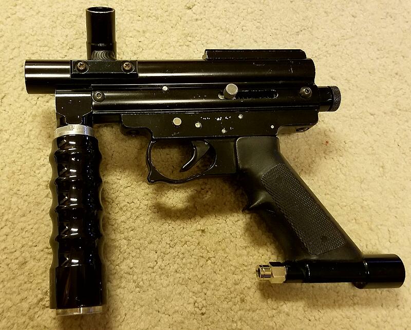

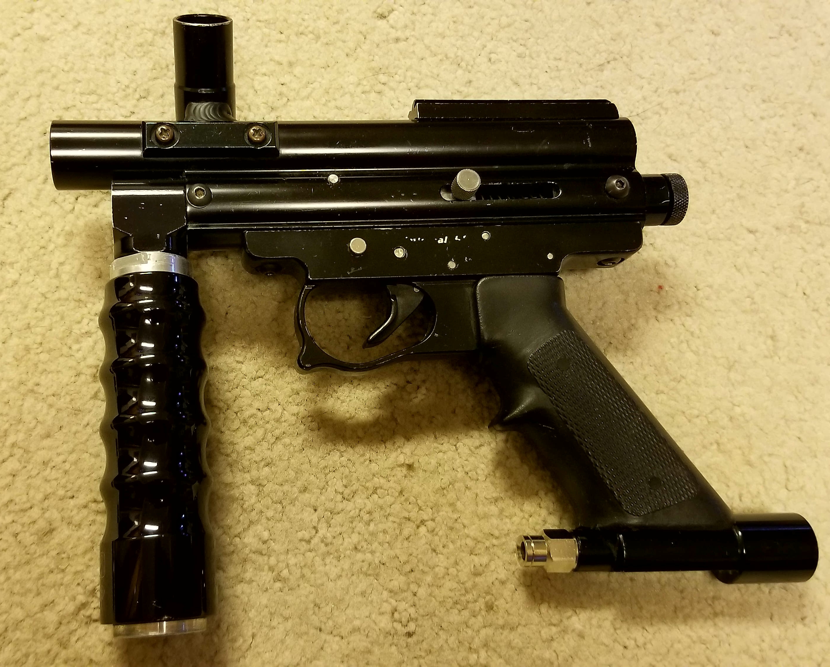

    Can someone help me identify this body?
    So this came in a box of Spyders, so I naturally assumed it was a Spyder body, and it had a laminated M16 grip that had peeled too bad to read any model name from, but the detent is much longer than normal, the ASA is secured from the sides, not to bottom, and it has marks on the top from where a sight rail was on it. I can't find any model online that seems to have this sort of retention for the ASA though so now I am doubting it is a Spyder at all. It fits a fatty striker, and has proper Spyder barrel threads.
    I notice on my Spyder body that looks almost exactly like this (but uses a slim striker) and has the shorter ball detent, and it also has two lines milled in near the barrel which this lacks, that one had a gripframe that said Spyder Compact 2000, which further make me suspect this might not be an actual Spyder.

    That is a first generation Kingman Spyder Compact. The first ones had the long detent cover, two side holes to secure the vasa, and a classic fatty striker. This was my first marker, still have it somewhere.

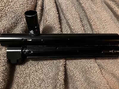

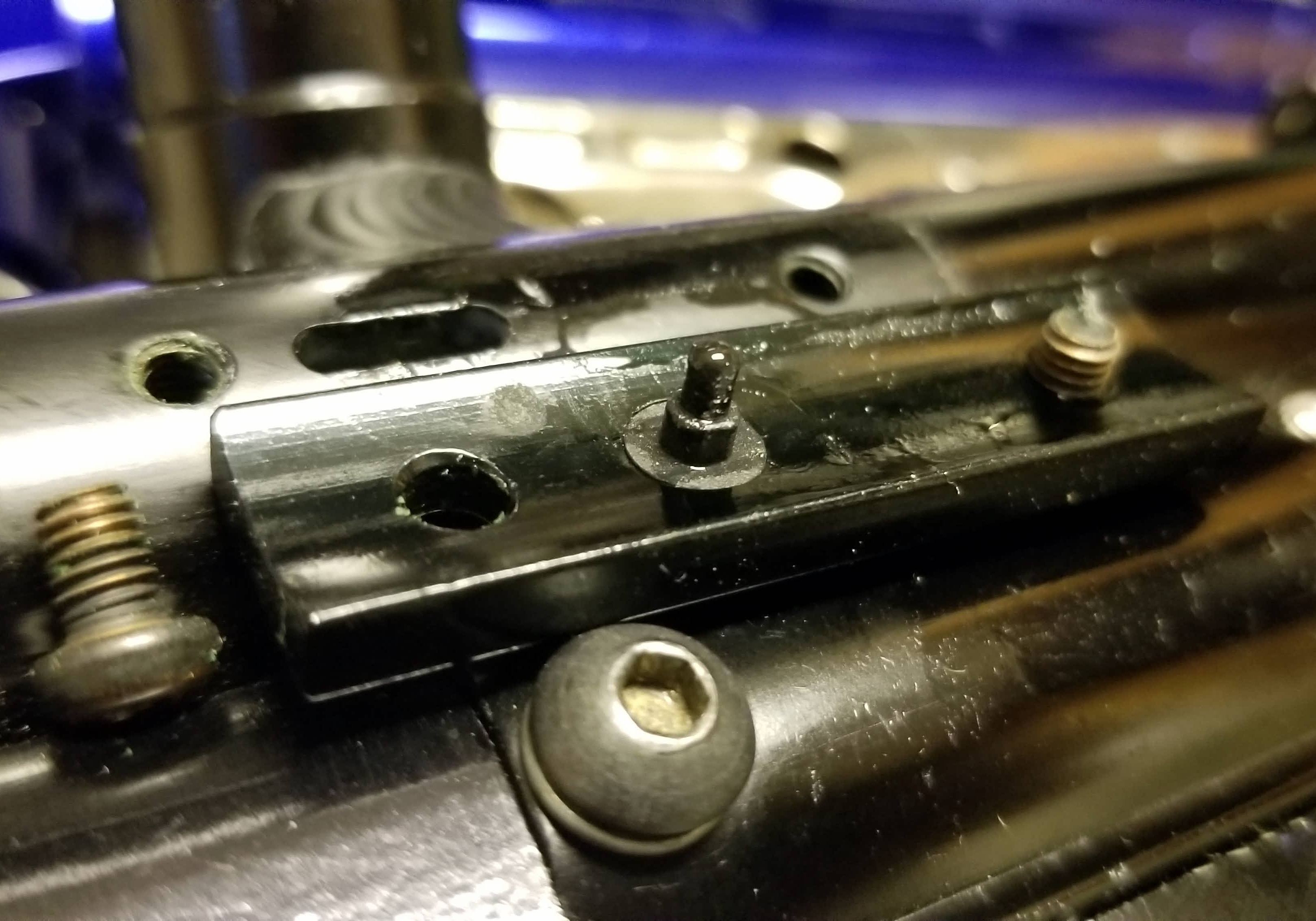

        Nice, so it is an actual Spyder, how is the detent, is it a little rubber "feeler" or is there a wire or something under that long cover? I am going to have to find a solution to getting a detent on it, because now I have to get it going because I have never seen on like this before.
          It was the nubbin I believe. Just sort of sandwiches between the detent cover and the receiver.

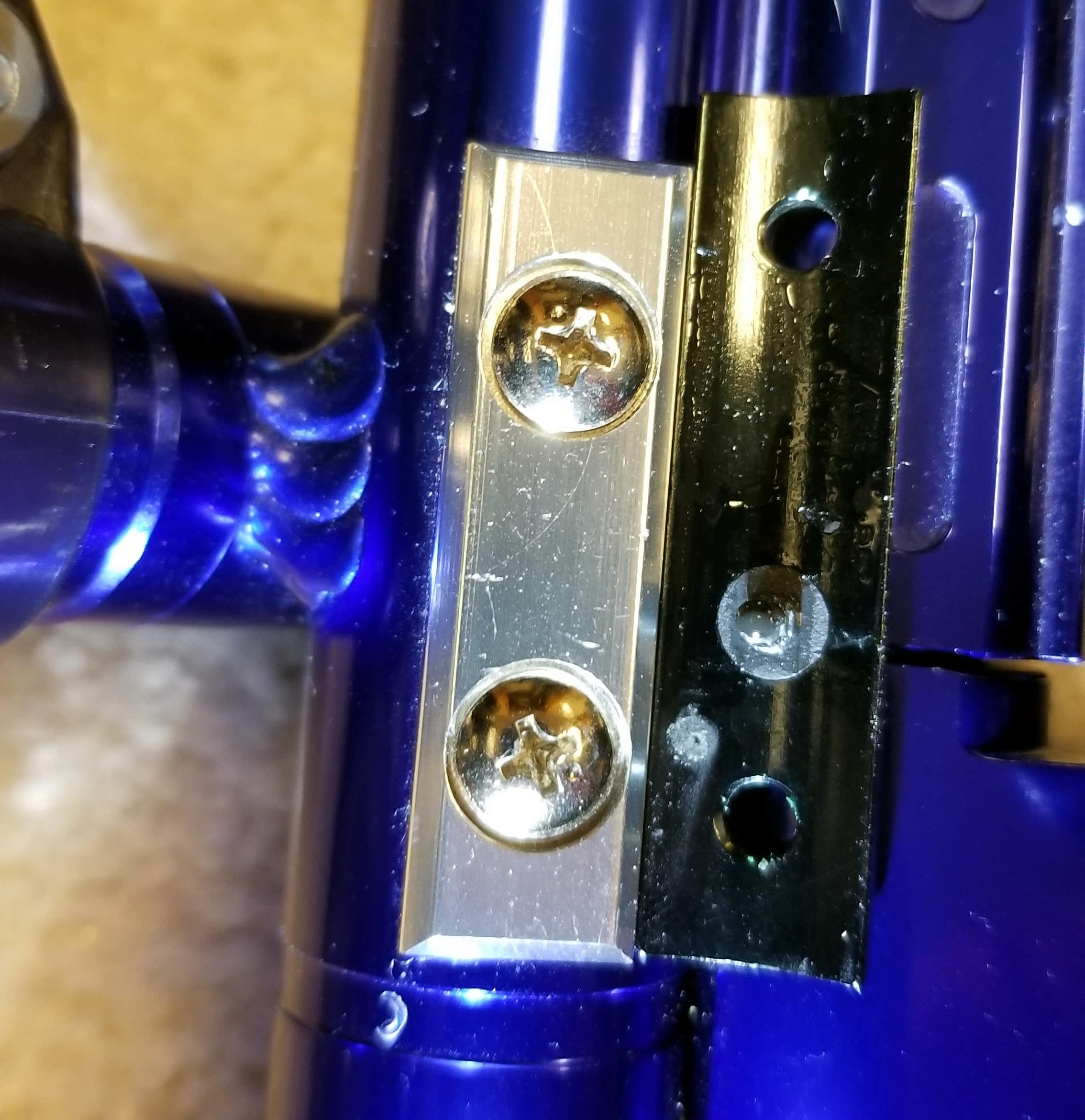

        They use the classic Spyder nubbin style detents with a cover plate (as seen in my pic). Now the plate for these is the "long" version. About the time they introduced the slim striker, they shotened the detent cover plate length. I say "sometime" as I have a fatty striker Spyder classic that has a short detent cover.
        Nubbins detents can be found easily at various vendors. Short plastic detent covers aren't too hard to locate (metal ones are harder to find). The long detent cover...good luck? I know someone designed a 3d printable detent cover, not sure if there is a long version STL file out there to make your own.

          Pic of nubbin inside the long detent cover and size comparison with a Spyder Shutter short detent cover. As a note I seem to have a metal long detent cover, so I guess they exist.

            Oh, nice, so it looks like I just have to 3d print a new cover and I can fit a detent in there, or better yet I think I have a scrap piece of brass I could cut and grind into shape for it.

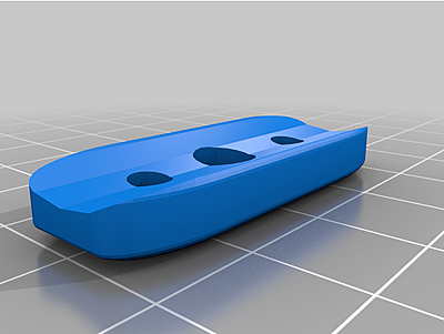

          Found the 3d printed model but it is the short cover style.
          This is the two screw Spyder detent holder. I rotate it 180 degrees and print with supports touching the buildplate because it bade the outside look better. My original part broke.ao here I am. I hope it's usefull. I would love to hear from you if it helps...

            I think I uploaded both versions in the STL repository in the 3D printing sticky threads on here. They are also in the Kingman sticky threads about detents.
            I didn’t post them on any of the 3D printing websites because bah humbug. If someone wants them, they can join our lovely community here.
