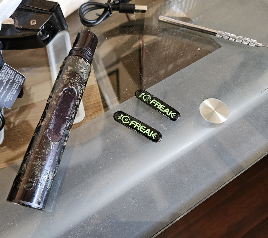

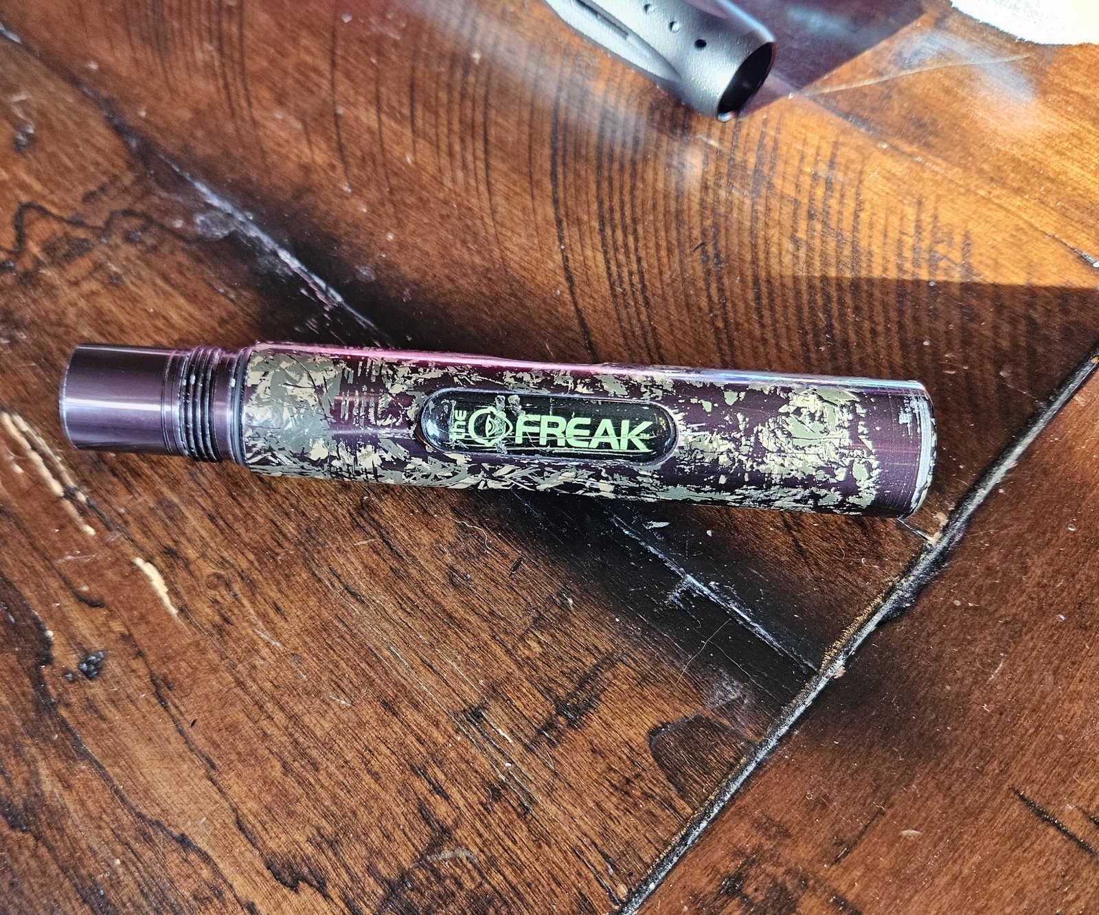

    I've got a Freak back here I've acquired with a spraypaint "camo" paintjob.
    There's plenty of things in my garage that I know can strip the paint off without harming the anno, but I'd like, if possible, to not dissolve or fog up the "Freak" logo jewels in the piece.
    Is there a solvent that will attack the paint without harming the jewels and if not, what's a good way of protecting/masking the parts while the paint is stripped?

    Don't leave the Jewel in place. The easiest way to clean this up is to warm up the freak back and carefully remove the jewel sticker then clean up the paint on the anodized freak back. You should be able to remove the paint from the jewel logo with alcohol and some light rubbing. Once everything is cleaned up reattach the jewel using fresh double sided adhesive film.

        Right now the jewels aren't moving when I try to pry them with a dental pick.
        How muich heat would be appropriate here? I don't have a heat gun so I'm looking at the hairdryer, boiling water, or a blowtorch. Guessing the blowtorch is out.

          Hair Dryer heat and heat up the aluminum not the Jewel if you can to keep from making the actual bubble soft. Oh and blow torches are always an option just not something that is often recoverable

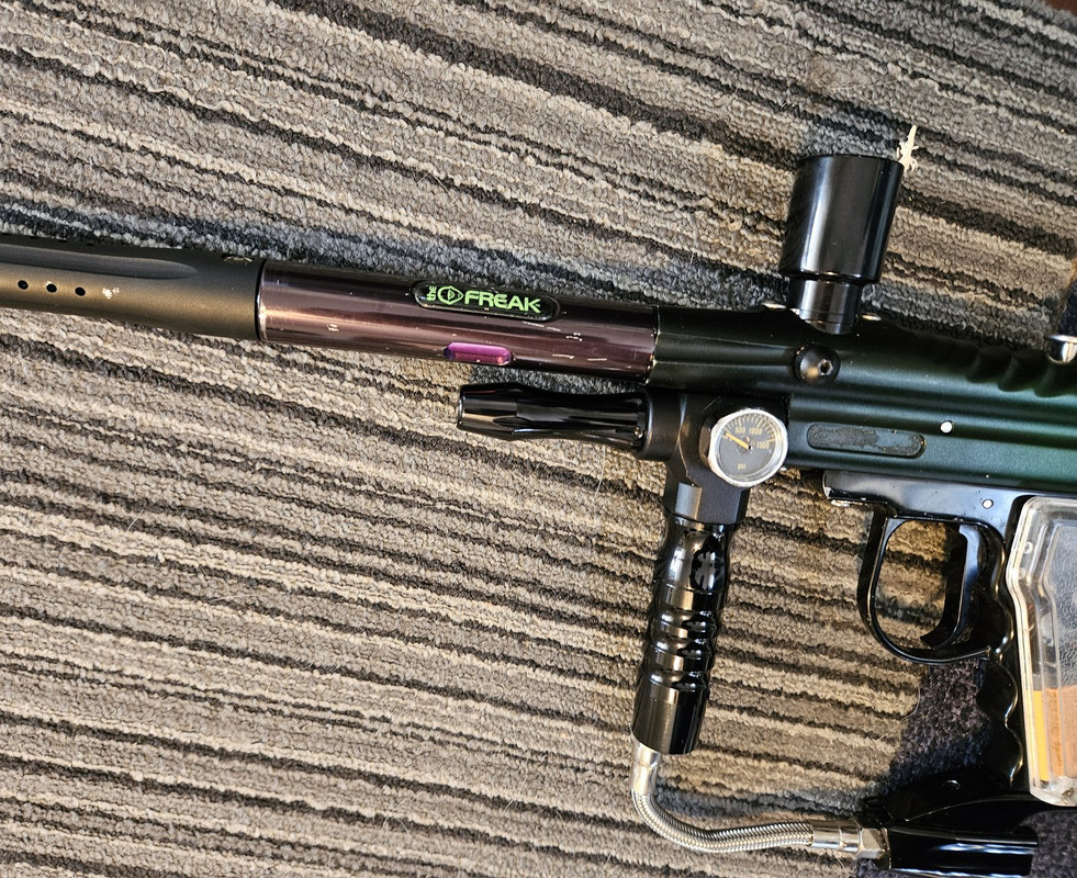

            A combination of hot water and alcohol got it done.
            A splash of acetone in a small baggie took care of the old paint.
            Thanks, everybody!

                Originally posted by Sdawg
                The acetone didn't damage the anodizing?
                It did not.
                That Freak back was already kind of a dark purple black compared to the other parts of that Dragun, though the sunlight in the picture accentuates it more than normal.
