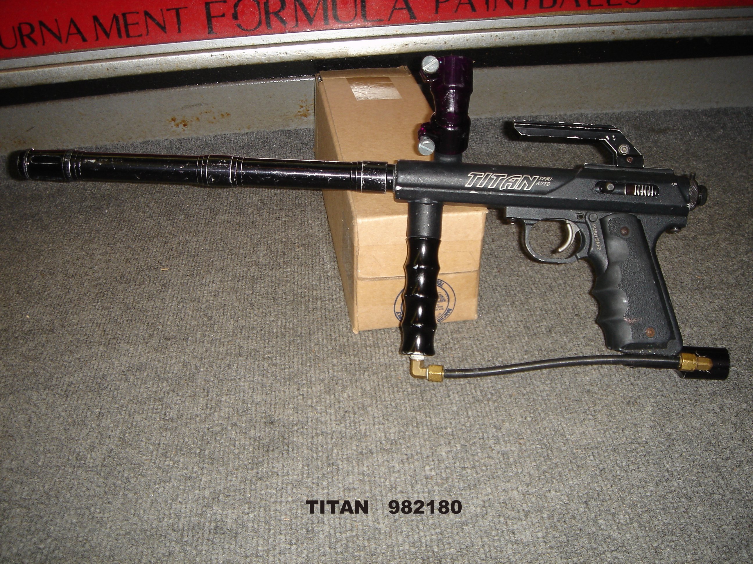

    So I have an old Mokal Titan that thanks to a bit of fiddling airs up and shoots just fine. I have a few questions about it though.
    -Does anyone happen to know what the body and grip frame are made from? It feels too dense to be aluminum.
    -People on Reddit are saying that the Titan's barrel is Cocker threaded. Can anyone confirm this? I can post a pic of the barrel thread if that will help.
    -Can anyone tell me anything more about it in general? All I know is it was released some time in the 90s, was made in Toronto and apparently never really caught on in the States considering I've never encountered any in the wild.
    Really not sure why these weren't a bigger hit; they're stupid easy to take apart, shoot quite straight and handle nicely.

        I’ve worked on a couple of these and they were pretty neat! Their most direct competitor was probably the Sheridan JTX/XTS and those suck to work on, especially when compared to a Titan. I think the Titan bodies were sand cast aluminum which depending on the alloy could be a bit denser than the 6061 most paintball stuff is machined from.
        As stated above the Tippmanns were probably just too popular for other inline blowbacks to have much market share and compared to a 98 the Titan looks pretty dorky but is every bit as functional, and with a user serviceable valve too and built in vertical asa too! I had a Tippmann 98 early on and honestly the powerfeed on the Titan would have made it a no-go for me at the time. The iron sights with a clear view and Tommy gun foregrip were great selling points for the 98 when it came to woodsball

          I'm looking at pictures of Cocker threaded barrels and it seems like the reverse of what the article says is true; that the Cocker barrels have a shorter thread section than the factory Titan barrel. Really wish I had an actual Cocker barrel to try in this thing before I buy one.

        It is Cocker threaded but not all cocker barrels will work. The bolt travels into the barrel when fired, so if the bore is to small it will catch and not recock. barrels like Armson usually work because they have a bevel at the breach. There will be a gap between the body and the base of the barrel, but its only visual. I have modded some others to work.
        Smart parts did make a Titan specific barrel (All American and a Progressive)

          Thanks for the information, that's what I thought but I wanted to be sure. I'm currently eyeing a Cocker threaded Lapco barrel bored at .690, I think that'll work with a Titan.
