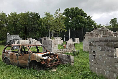

      I helped build an urban city at a local field. We simply poured a fake footing at grade ( 4 inches of concrete in a trough) then we laid half walls up. No core fill. No real structure to it, but it's held up better than I expected over the years. We get a hard freeze here too, so it surprises me even more.
      I attached a webpage photo from the field showing the beautiful city I was part of building.

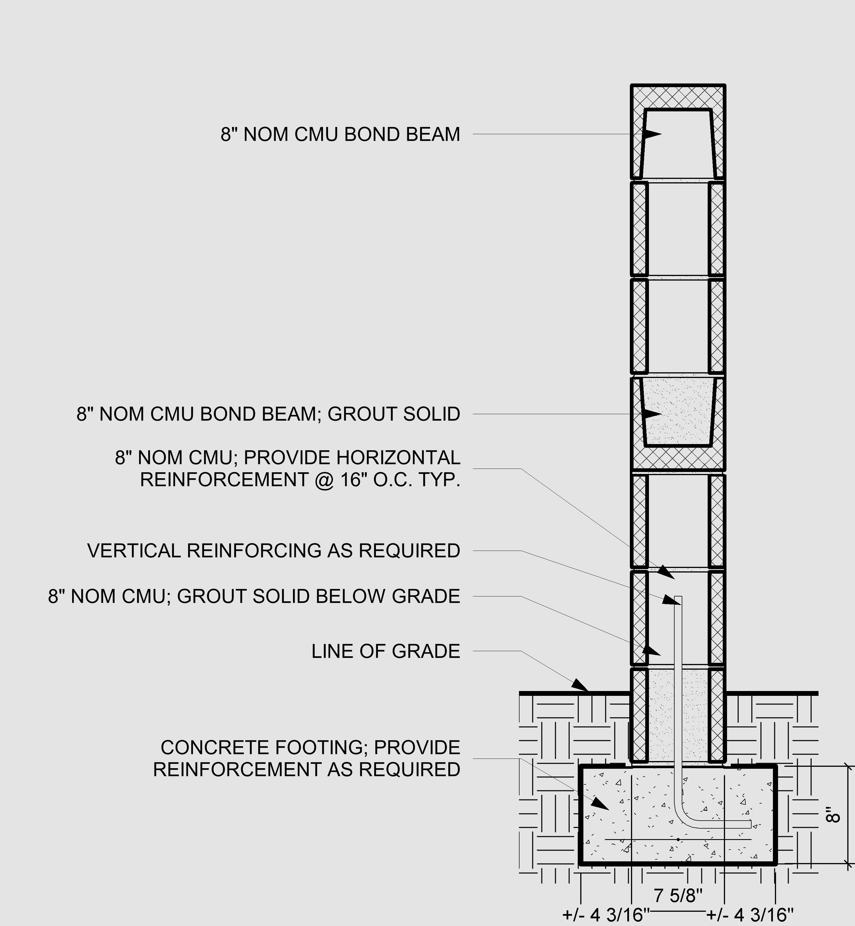

          CMU is cheap and easy to build with and will last forever. ICF could be good, but the foam will take a beating and might not stand up long-term unless it has a finish on it. For a 3ft to 4ftt wall I would go down at least one course for stability, but you can get away with less depending on the design of the bunker. Something like the attached image is about what you need. The intermediate bond beam probably isn't needed on anything less than 8ft tall. Over 8ft and you should probably have someone run calcs on it to make sure everything is kosher.
