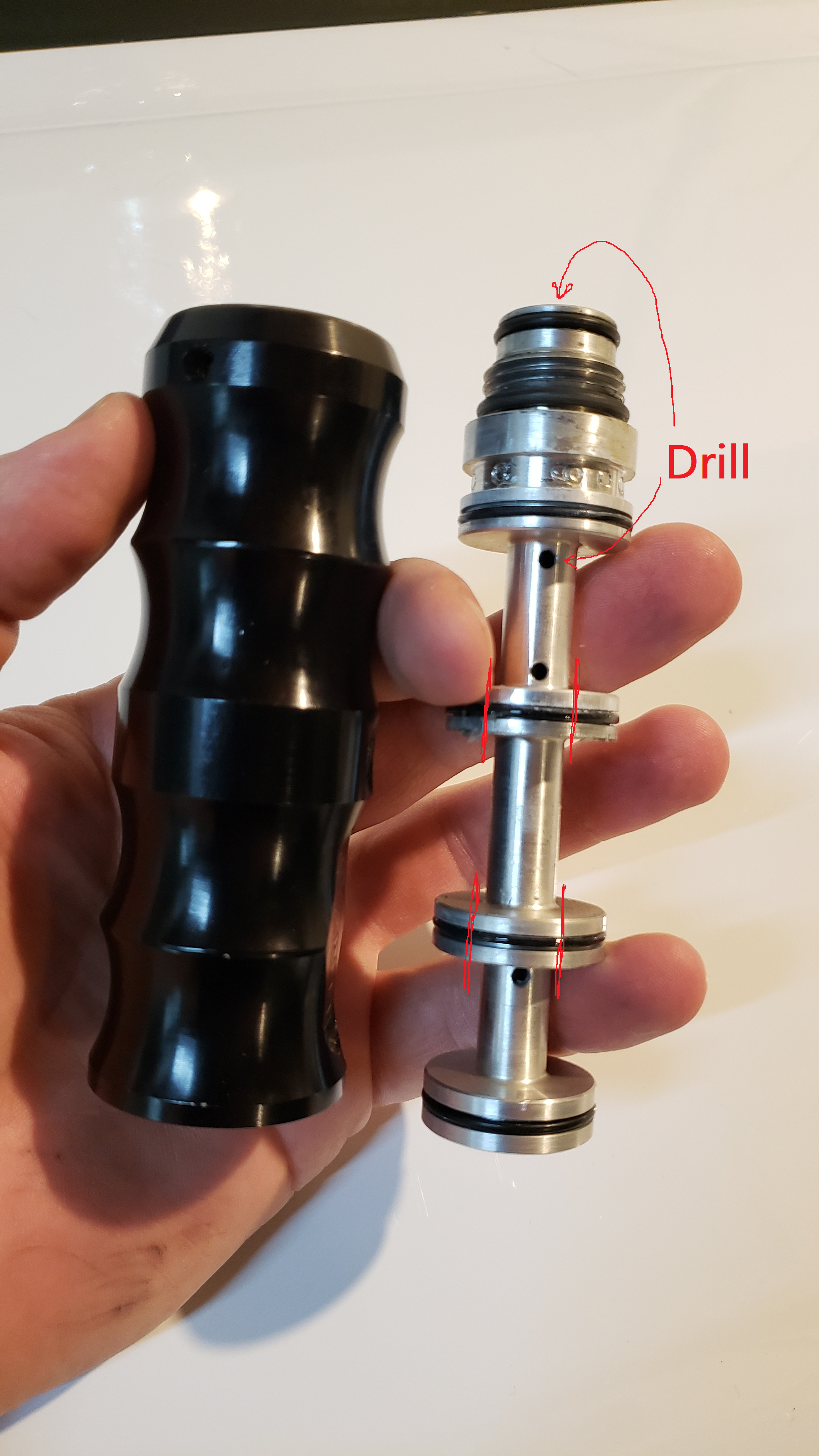

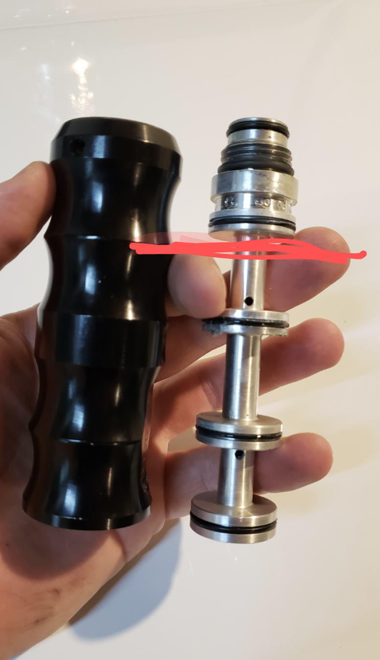

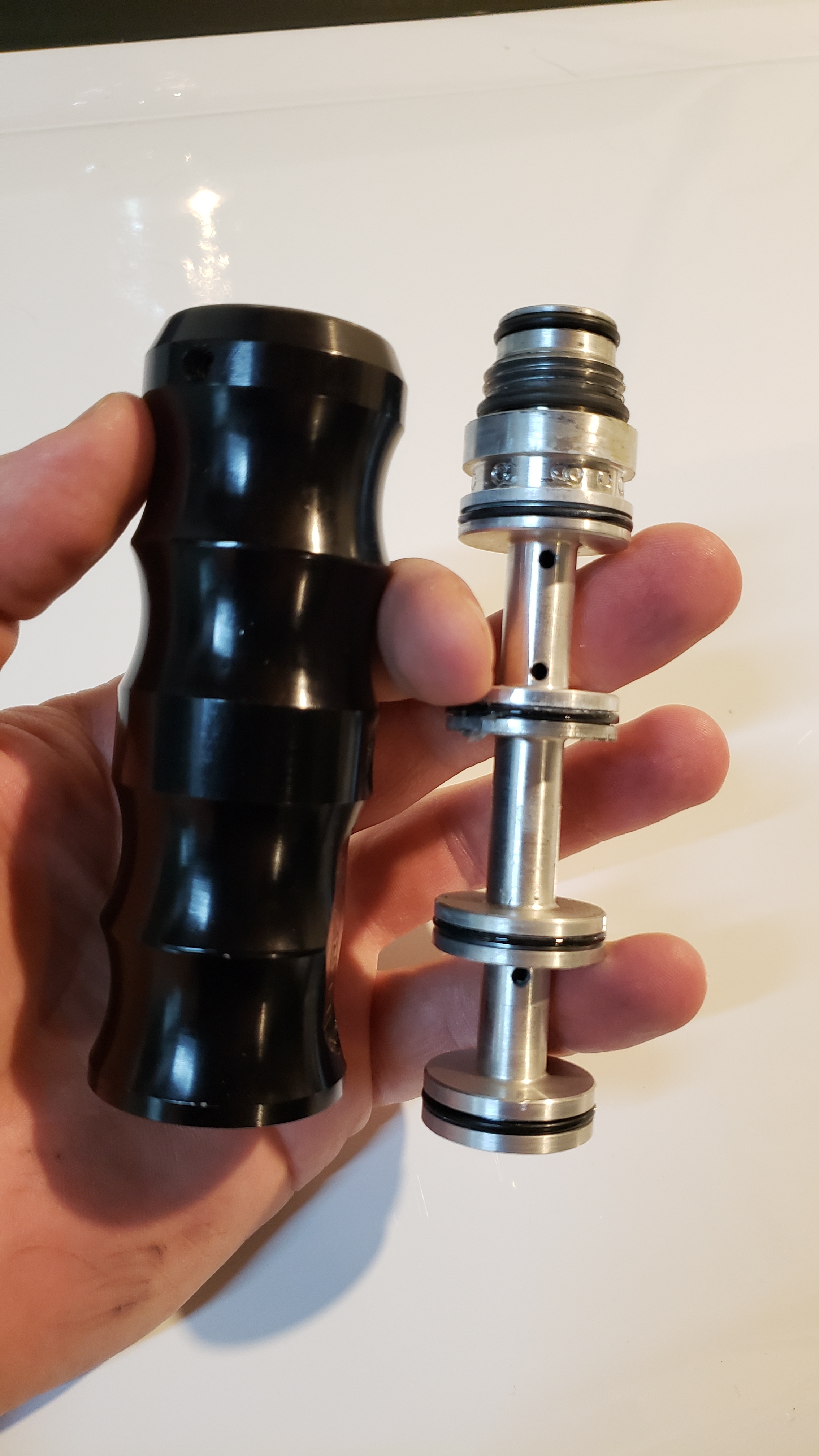

    How the heck do I make this thing not choke regulated HPA?

      Cut here and drill out the hole throu the ASA threads 👍

          I don't like that. That'll make it look like a Spyder gas-thru.

            You could drill all the holes bigger with a step drill wouldnt take to long, whats the top asa look like

              I'm gonna guess that the bottom disk seals the bottom of the chamber, the couple i have have set screws in the top plus the bottom, if you have set screws in the bottom to hold the bottom disk just cut the center out and slap it back together
              • Psycho91
                Psycho91 commented
                Or maybe mill the middle disks off and drill the holes a tad bigger
              • Psycho91
                Psycho91 commented
                Or mill the holes into slots

                That's not a bad idea, adding set screws at the bottom. That's how the top is so you can rotate it.

              I'm not familiar with these but it looks like you could remove the middle two orings and see if that helps at all before chopping metal.
                • 3396
                Uhhh.. just remove all of the middle o rings?
                Edit: then if that doesn't work you can drill that top hole out a bit.
                I wouldn't over do it as that core holds pressure top to bottom. That stem would make a mean toe buster if it happened to snap off due to being overly compromised.

                  I would try cutting away some of the middle discs and drilling out the hole that feeds up to and through the ASA portion. That should give a direct route from the input to output instead of having to go through each chamber.
