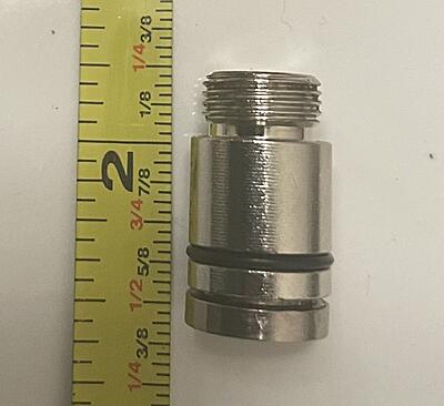

    What are the threads on the fitting? It doesn’t appear to be the standard 1/8 npt
    Anyone have a good source for these? Blast Legacy has sent me two that don’t grab onto the hosing, and they are now asking me to return my entire ASA when I ask for a replacement fitting…

      Hmmmm I will take a pic of the fitting later and post it.

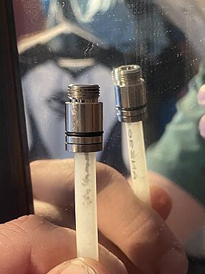

      Any ideas what makes a macro push fitting not clamp onto the hose correctly?
      I have my suspicions but curious what y’all think

        I've seen the collet/clamp get bent out of shape and not grip macroline on the smaller side. But I've also tried bending these tabs slightly back in and they just broke.

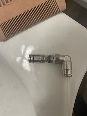

          Camozzi and Norgren make similar fitting styles. See what sizes they offer, then check if any match.
          It might be 1/4-28 or M6 or something like that. Even G1/16. I do recall it being small, and straight.

                  Try to find 1/8 NPSM or G 1/8 (BSPP). That's a custom fitting, though, as the o-ring location doesn't match any standards from other industries. You'll probably have to get a stainless nipple with the right thread on it, then Loctite it in place. Might be a good reason to go with hardline?

                      Yeah I don't think that's an npt fitting because it's not tapered.
                      This fitting came with the cam drive? Does it thread in and out just fine?

                        Affirmative on both counts. I’m assuming this weird outer oring is hoping to seal the fitting, but an oring on the shoulder should work as well or better.
