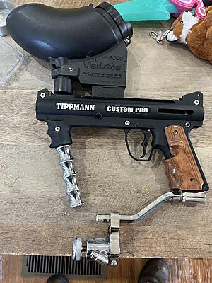

    So I bought a 98custom pro as a backup for a mech only big game and I was messing round recreating a OG 98 that a guy who helped get me into paintball made…. Anyways, the VA that it came with had a leak so I ordered a new one (BT 3 piece vertical adapter) and put on a smooth layer of thread paste and tightened in down and it leaked, so I tightened it about as comfortable as I am with torquing on it and it still leaks. Not sure if one of the o-rings on the pipe are leaking? I inspected them and didn’t see any sign of wear and they looked brand new. Either way it’s very frustrating. Anyone have any ideas or suggestions?

        I wish it was the old style 1 piece VA this one is a 3 piece with double o-rings on either side of the pipe… honestly thinking about soldering it or at least use side some JB weld on one of them

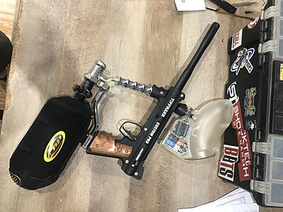

          Took her apart and ended up going straight back to 1999:
          Teflon tape 4x round the threads that screw into the valve (used a razor blade around the top thread to keep it clean and out of the valve.
          3 spins of the white snake on the double O-rings on either side of the pipe. But her back together and she aired without a peep.
