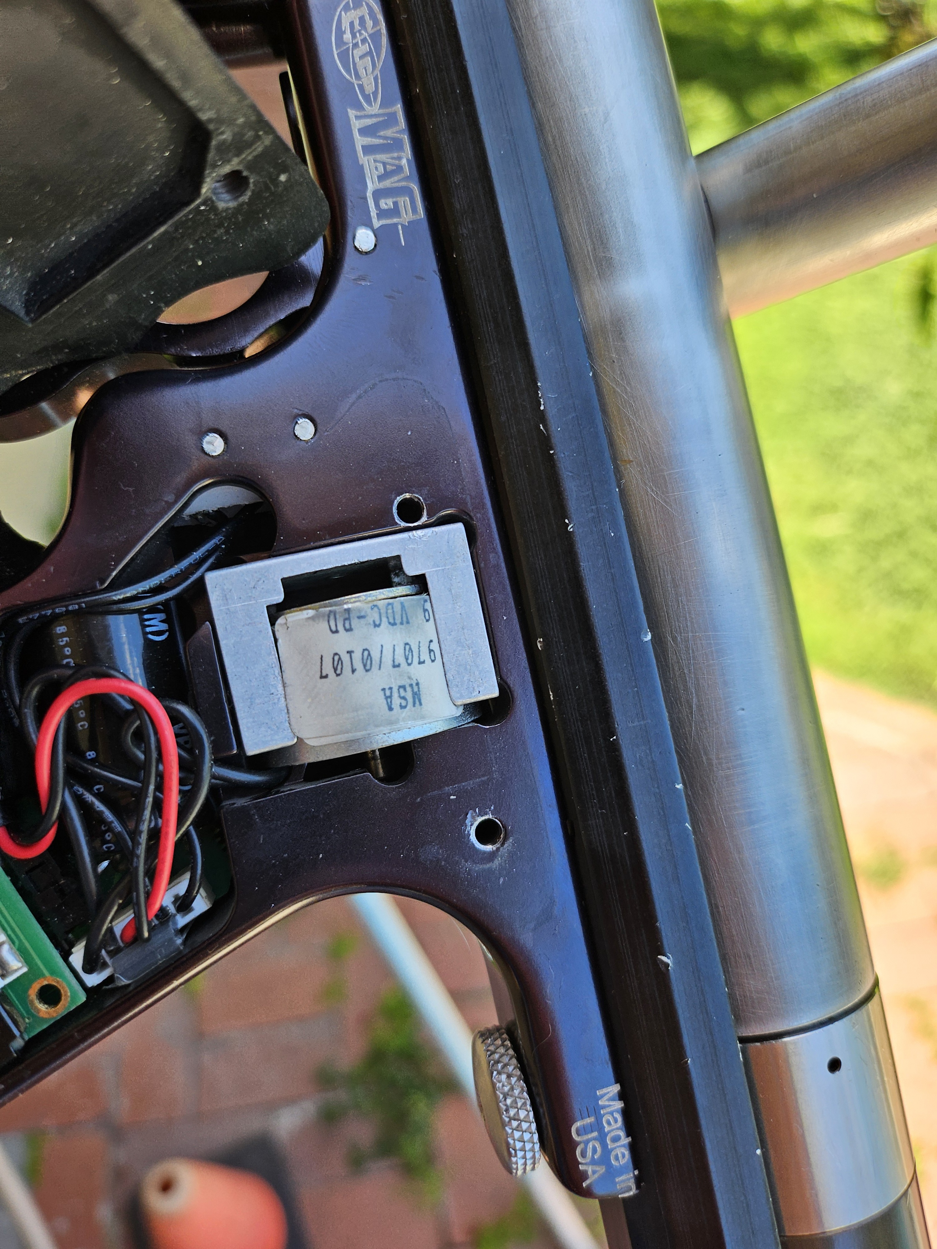

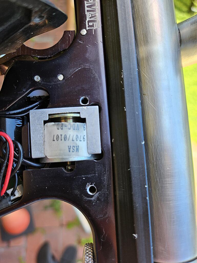

    Here is an example of the noid not resetting. It stays activated, pushing the sear back. It won't reset unless I point the marker downward.

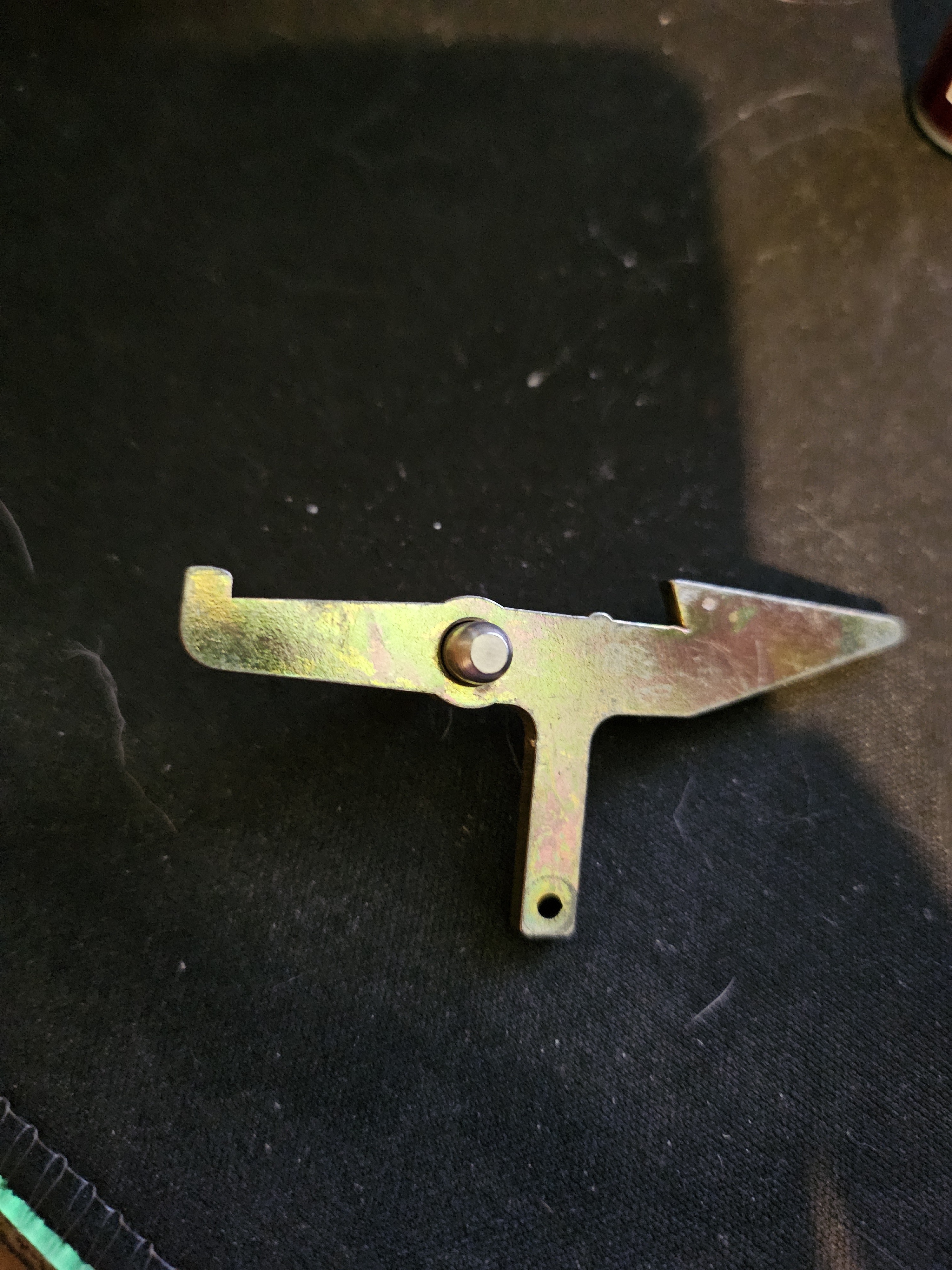

    Here is a picture of the sear. This is what came with the boo yah.

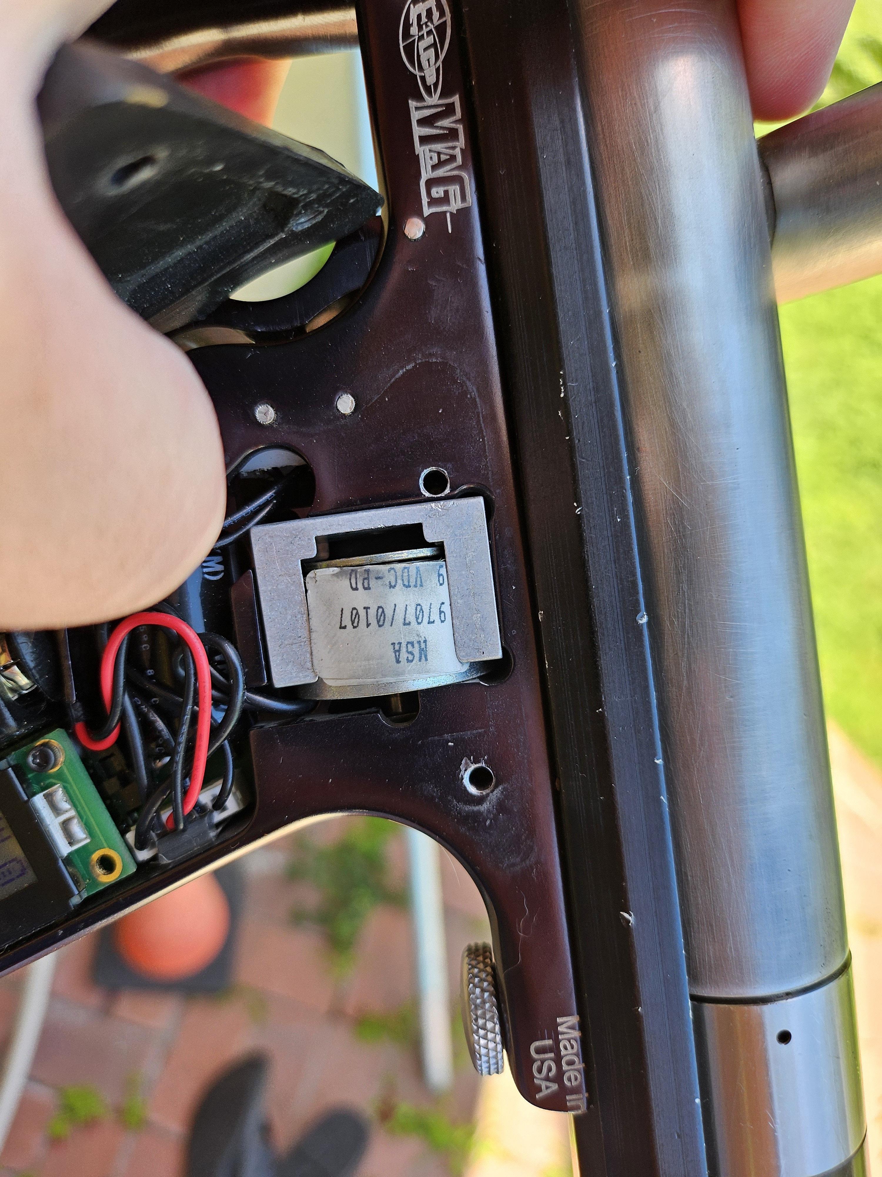

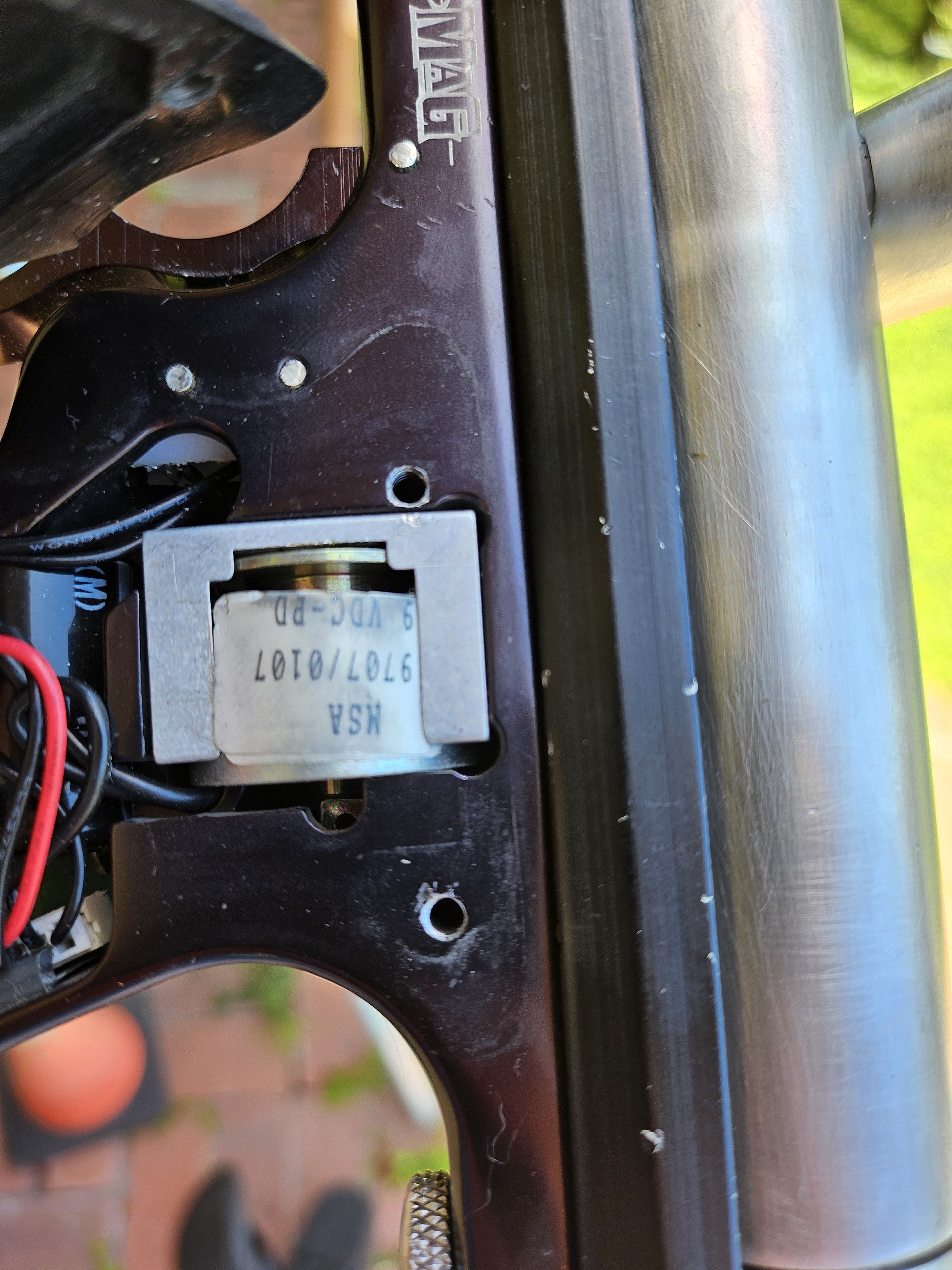

    Here is a picture of everything correct. The noid is reset and the sear appears to be in place. BUT, sometimes the sear does not come back to the correct position, despite the solenoid resetting properly.

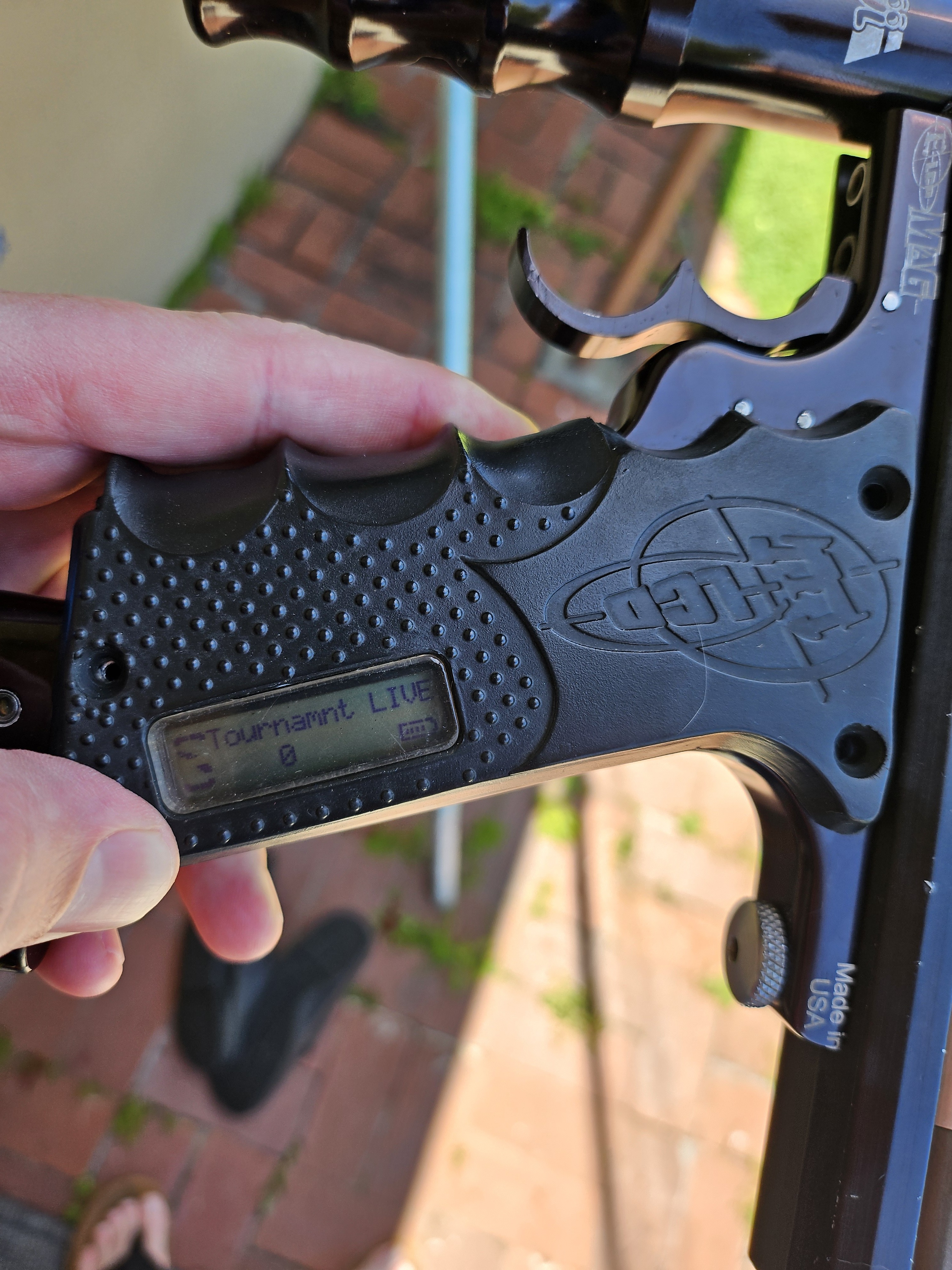

    Here is a picture of the battery display. The battery is at 10.5v.

    Maybe the noid could be adjusted a bit more marker-forward? I think the one I installed years ago had something similar, and I got it working without replacing anything. I think I just moved the solenoid a bit.

        Yes. The clapper may not be getting the full strength of the magnetic field when it's energized, and not tripping the sear as a result.
