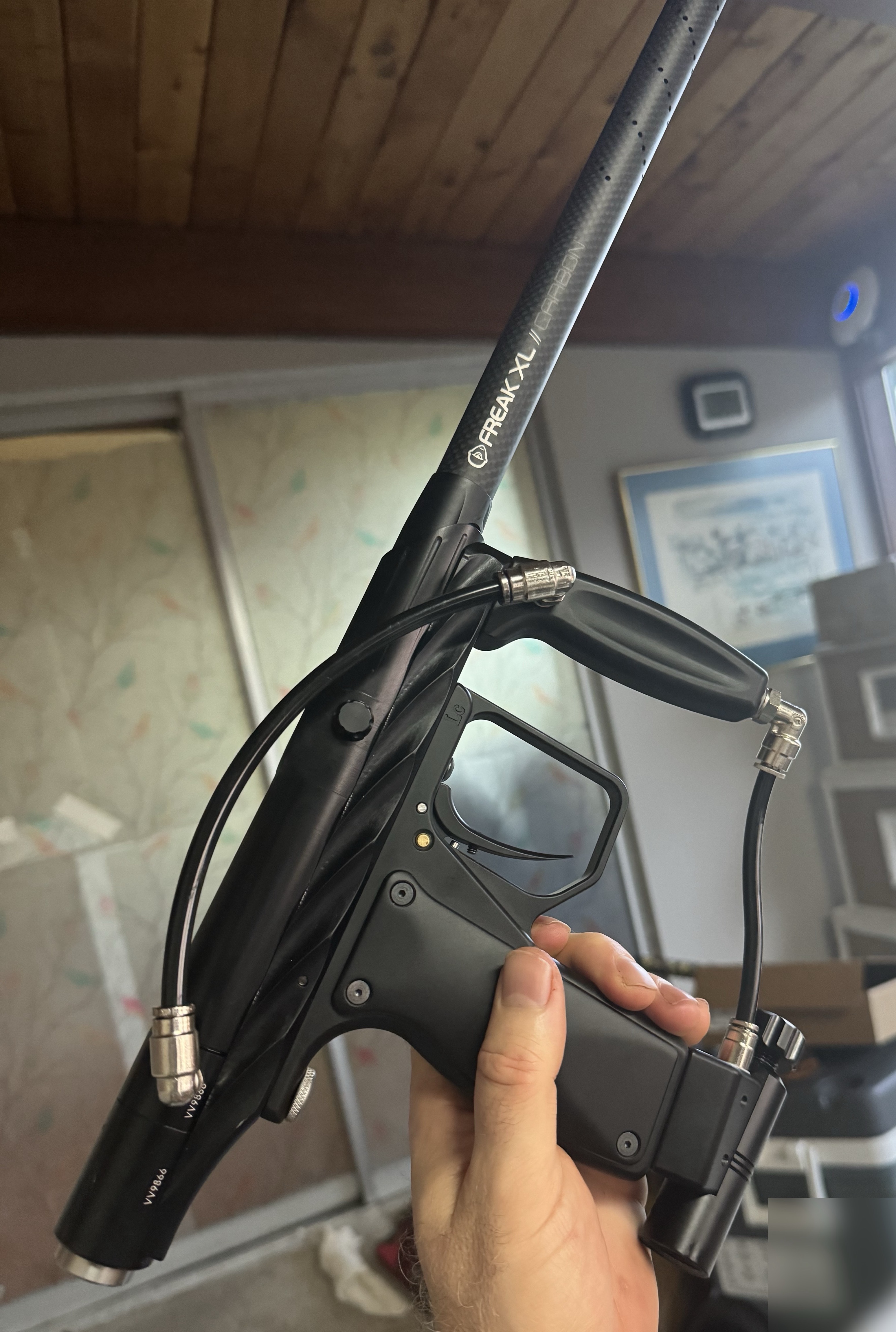

    An ULE Automag
    X-Valve with level 10
    Lukes rail, fore grip, Sidekick, Cool Hand Luke frame, T-Rex and P90 LPR
    Story: Had some trouble with velocity variation at Supergame. Narrowed it down to a spring issue. Replaced all the regulator springs (small and large), valve pin and respective seals. Basically, I rebuilt the X-Valve regulator. The back of the regulator where the small and large springs are is packed with Dow. On testing I am getting some strange bolt behavior. On trigger pull, it cycles and the bolt goes partially back toward the seated position. It hangs there for a few seconds, and during you can hear air leaking down the barrel. It then resets to the seated position by cycling again, and all leaking stops. I tried adjusting the X-Valve regulator by increasing the pressure. It only reduced the amount of time it took hanging out in partially back position. Reducing pressure at the X-Valve increased the time. Now my tank is empty and I need to refill before continuing to test.
    Here's some additional information: Supergame Oregon was a soggy, sloppy and wet mess. I have cleaned everything except the on/off assembly. I did pull it out to visually inspect, and everything looked well lubricated with no signs of water intrusion. At Supergame I made sure everything was well lubed, and inspected all the bits and pieces to try and improve the velocity issues. I put lots of paint through it as well. I was able to play somewhat so long as I dialed the FPS down to avoid the spikes over 300. Not much range that way, but was able to field test it. There, I think that's the entire story.
    Input pressure from the tank is 850 psi.
    Tank regulator is a Ninja Flex.
    Tank is connected directly to the Sidekick.
    I have to wait until tomorrow to refill on air. Until then, I thought I'd post up here to see if y'all had any insights.

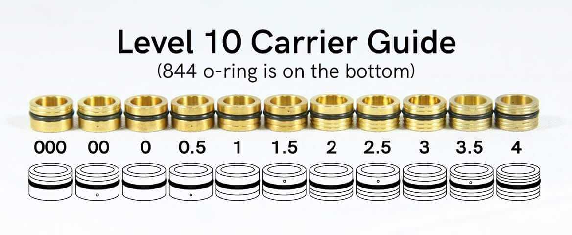

            Are you measuring the length or the ID of the carriers? They are intended to squeeze the oring. They operate differently than the level 7 spacers.
        • superman
          • 3379
          • Mount Pleasant, SC
          Also note that 000,00 look very similar to .5 and 1 to the untrained eye.

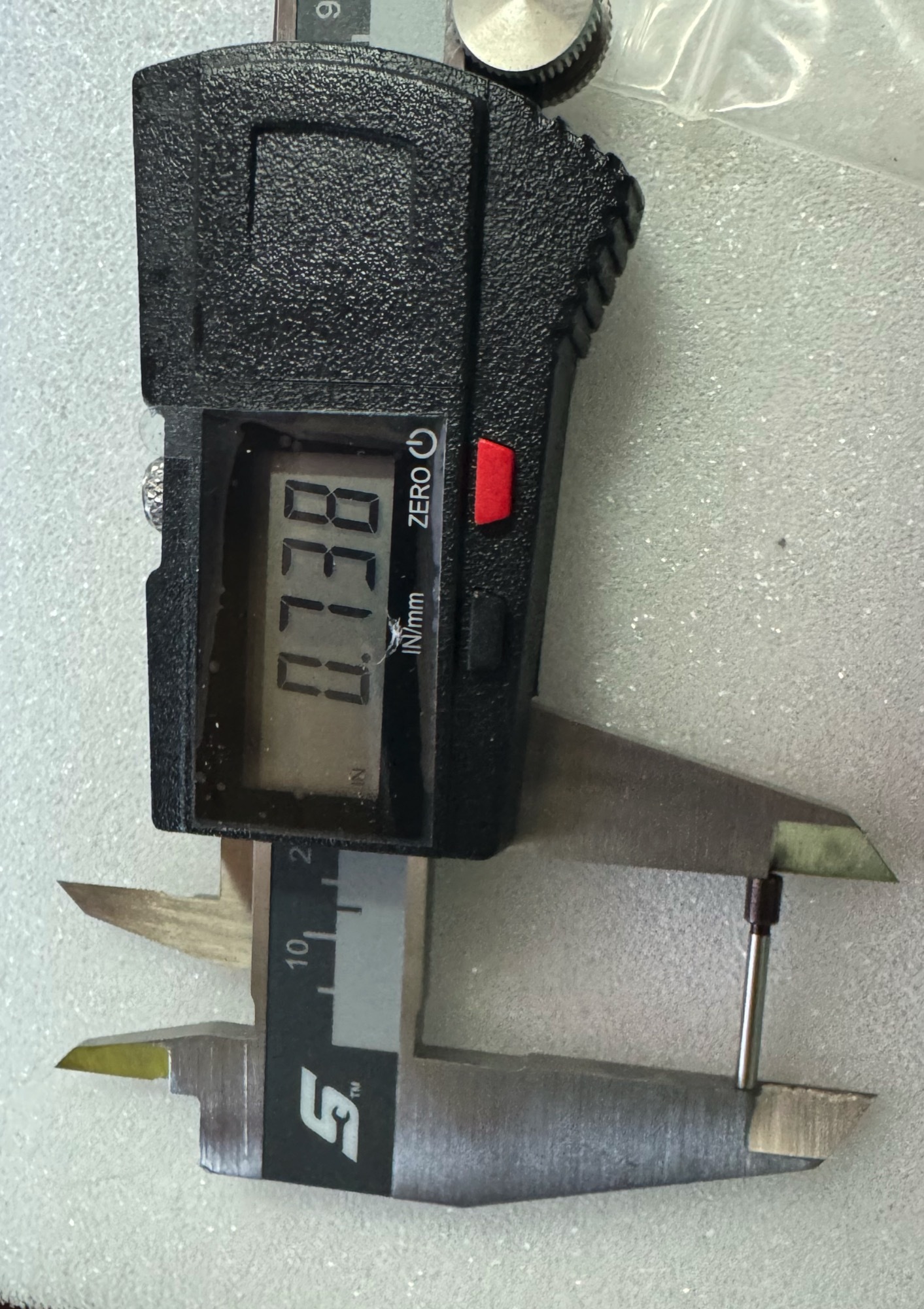

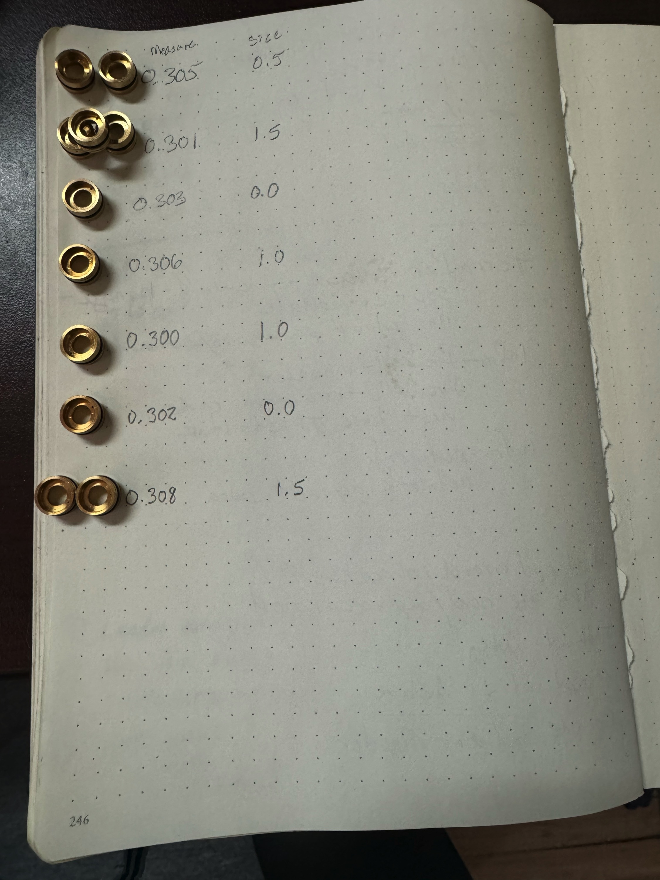

            I am measuring the ID of the seal side of the carrier. superman I did not have this image. This is MUCH better than what I was working with. This clears things up a lot!
            • nak81783
              Last of the Salzburg Clan
              • 592
              • DeWitt, MI
              I keep these handy as well.
