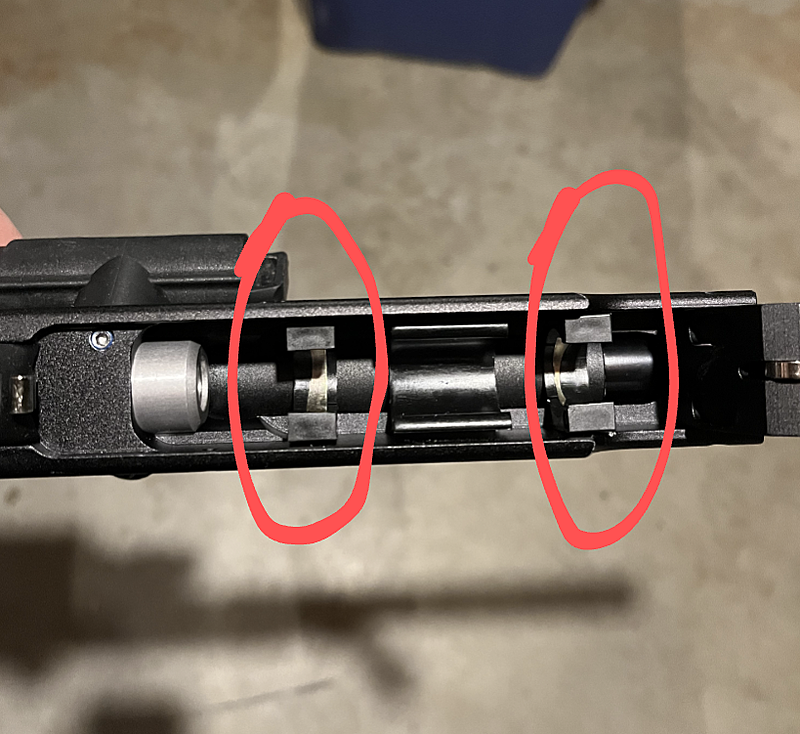

    I remember seeing someone post about a way to improve the SA-17 12 gram drop. I believe it involves removing one of the clasps?
    does anyone remember or have suggestions?
    thanks

    Yeah I pulled them out. The cartidge falls in faster and drops out faster too. The SA-17 was tricky sometimes. Like the neck of the 12 gram would miss the hole and jam up against the edge of the seal. I would drop a empty, flip the pistol upside down but at a upward angle, and drop the cart in neck first so it would line up perfect and the lever would not jam. .

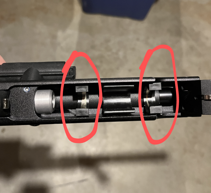

      Pull these 2 out 👍
      Now watch out when opening the door if the 12g is not empty, it will fly out!
      Those were added after a accident (lawsuit?) happened. The early ones didn't have them and were recalled.

        Oh that makes sense why I don't recall mine ever having them. I never had the fear I would open it when still pressureized. Not something you would ever accidentally do if you are paying attention. .

          yeah, definitely not a quick change with those clasps.
          Almost need a workbench and tools to change 12 grams.
          Ripping those out now
          thanks again
            XEMON commented
            I love the SA-17, but this "safety" makes it nearly unusable in games ...

          Yeah,the original run of those pistols were recalled and only had 1 of those kind of clips but it was more of a guide than a clip on them....After someone got injured they were recalled and after that they all came with 2 clips that grabbed way too hard and nullified the quick changer. It's basically a slam changer once the clips are removed
