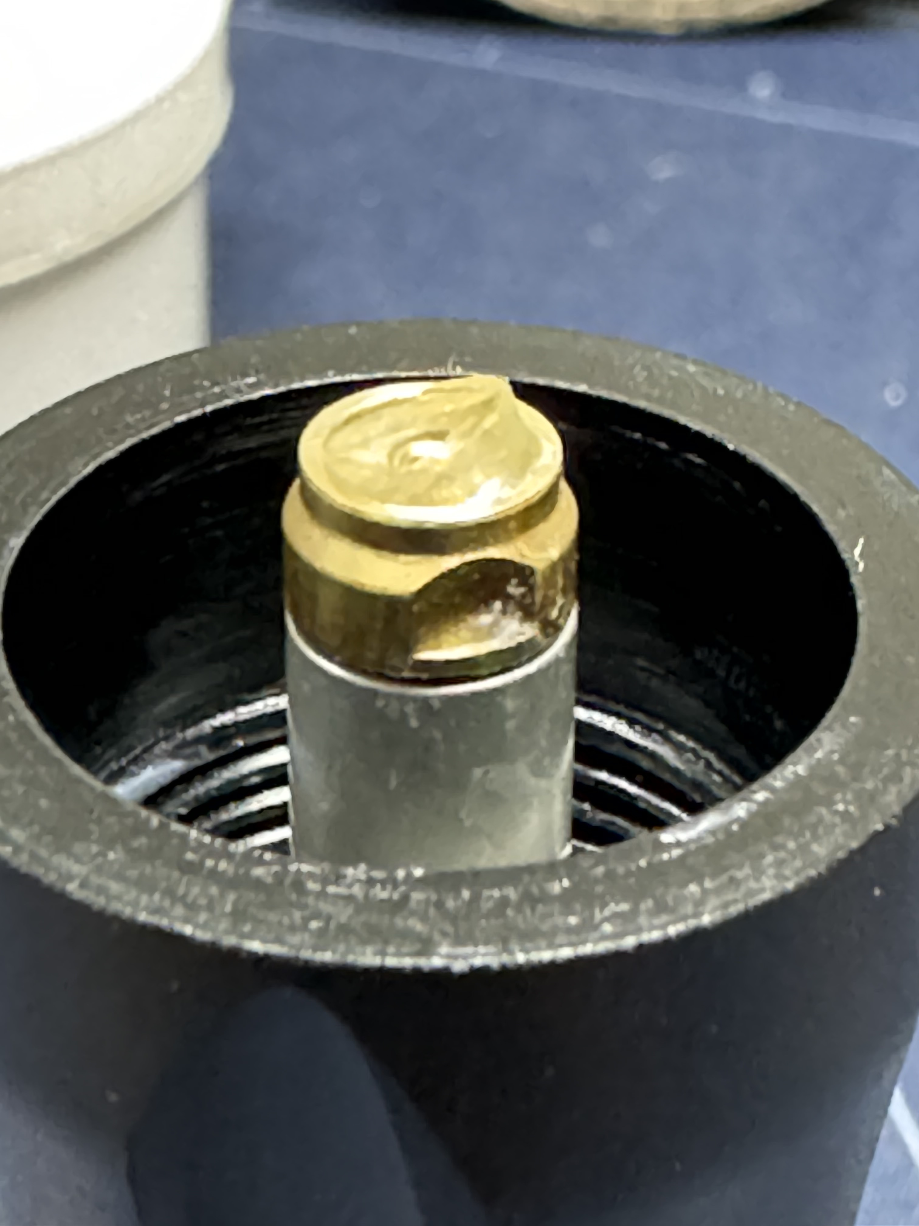

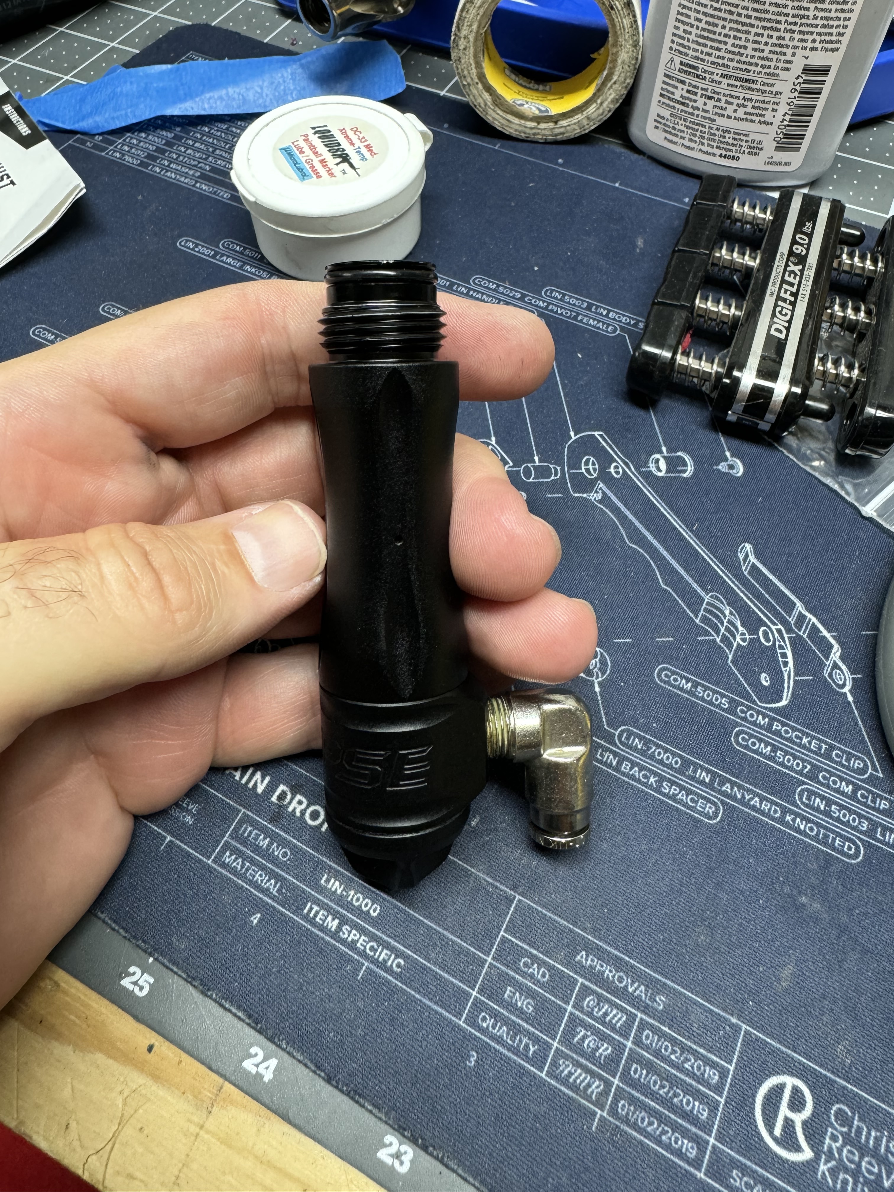

    I posted a little bit ago about this regulator, I was pointed towards replacing the reg seat. I did that, reassembled the reg and it’ll hold pressure stead for about 2 min then it will spike. I disassembled it and inspected the reg seat and it’s pushed out of that steam part that it’s inset into ( forgive me I don’t know the proper terminology). What’s causing this and how can I fix it for good?

    How old is the reg and is that the original reg seat?
    • Brandon
      Brandon commented
      No the OG reg seat was shredded, I got the reg off eBay for a good price.

    Did you read my mind!? Holy sh**. I’ve burnt up 3 LP gauges because I tried to “upgrade” my reg seat to urethane. Same Ego 09 era reg.
    Contacted George who I bought them from and he sent me a few extras in different materials and an elusive “oversized” alternative. He says, some brass caps are a little larger than others. Installed the oversized one the other day and have put a few hoppers through the marker without fail. The others would blow out in under 50 shots and then smoke my LP gauge.
    Also, check the poppet seal that’s under that brass cap, if it doesn’t seal, you’ll get all the tank pressure and would also likely cause that seat to fail.

      I removed the brass piece and the small, item that was under it (not sure what its called) was broken in two pieces. I'll order another one or two. Thanks for the help!!

      I'm the guy that sells the reg seats on ebay (mpqtmagnum).
      Happy to answer and questions about rebuilding these regs, I've done a ton, and usually its pretty straight forward.
      Definitely want all the other seals in the reg to be in good order, and a full rebuild is usually prudent. Also, if you can, being able to pressure-test the reg off the gun is ideal.
      I would definitely try and fix the rubber seal under the brass cap first.
      That little piece under the brass cap is the check valve. Basically what it does is when you turn the air off to your marker, it lets all the air completely bleed from your marker. With older EGOs without that check valve, (and subsequently no hole in the middle of the reg seat), there would still be a few shots of air in the marker even with the tank removed.
      So, on one side of that little rubber piece is the tank input pressure (high) and on the other side there is the reg output pressure (low). The high cant get to the low because of the rubber check valve stopper. And the low can't mix with the high because it is not strong enough to push back and open the check valve in reverse.
      When the tank is removed, the High pressure goes away, and now the air in the marker (low) is strong enough to push back on the check valve and then can open the check valve in reverse and the air in the gun bleeds out through the asa.
      Essentially, the check valve is not necessary as long as you are ok with your marker having a little air in it after you remove the tank (and then you just shoot a few times to drain it like you would with an older ego).
      So, if you cant get a replacement rubber seal a solution is to eliminate the check valve. You could try any number of ways. You could fill the little cavity where that rubber stopper was with some epoxy, or even some hot glue. Additionally you could put a completely flat regulator seat in the piston, with no hole in the middle in addition to plugging up the check valve. If it were me, I think id try the hot glue route, screw the brass cap down over it, and see how it goes. Ymmv of course​

        Just an update, as per caylegeorge​ suggestion I attempted to delete the check valve and replace it with glue to seal up that space. It was unsuccessful... I ended up getting an entire new from ANS on ebay (15 dollars )
