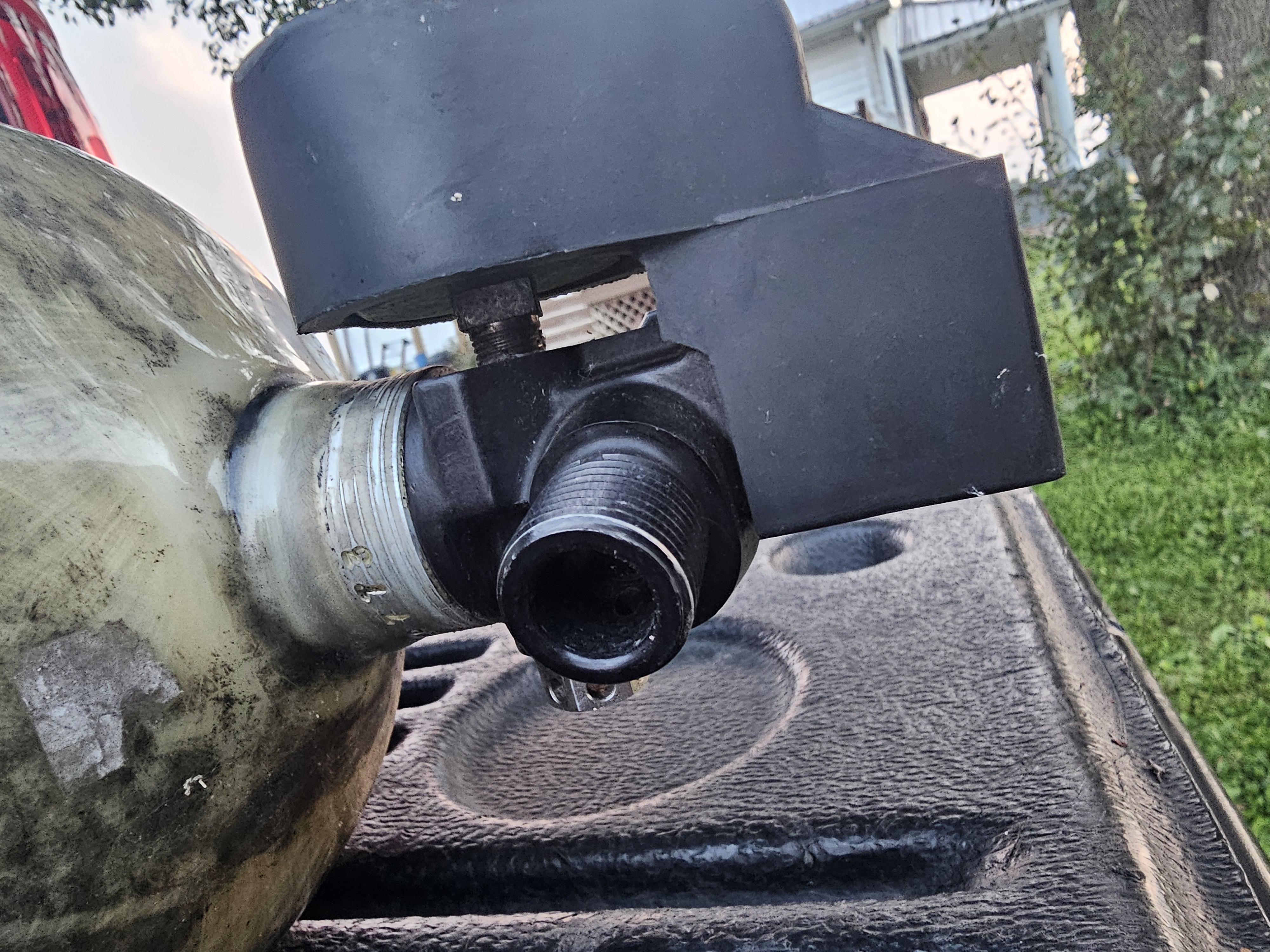

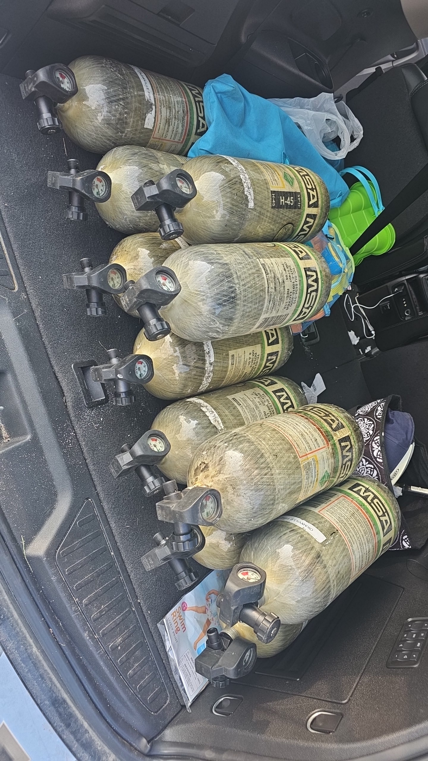

    Hey everyone, I've slowly been working on getting our outlaw field setup. I picked up a GX CS4 compressor several months ago and the compressor works well. But depending on the amount of players we have it may not keep up. So my idea was to find some scuba tanks to fill a few days before hand to keep players on the field. Well today a guy 15 minutes from me posted some 4500psi scba tanks on the fb marketplace. He gave me a deal on 11 of them. He said I could take the rest (5 more or so) but I said I probably didn't need them and it may help out someone else. Now I'm looking for adapters to fill the scuba tanks from the cs4, I assume this:
    https://airtanksplus.com/product/one...h-bleed-valve/
    and then another from scuba tank directly to the paintball quick disconnect, i assume this:
    https://airtanksplus.com/product/cascademan/
    Even though that says cascade, it appears to have the right fittings? Trying to confirm this with people who know before I spend money on it.
    I have attached the pictures of the bottles and valve

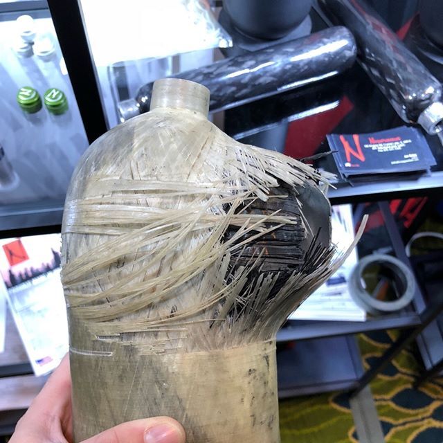

    Hate to be bearer of bad news but these tanks appear to be past their hydro life. Carbon tanks are only rated to last 15 years
    If one of them goes it'll be a literal explosion that would kill anybody unlucky enough to be nearby. The photo below is just a regular paintball tank imagine something at least 5x the amount of energy stored in this bottle.

      Unfortunately those are all old firefighter air tanks. Well past hydro life so I wouldn't use them.
      Also be careful when looking at scuba tanks. There is some brand maybe luxfer? That can't be hydroed because of the aluminum used.

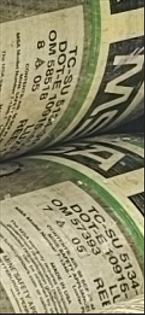

        Yep all of these of a born date of 2005 and I was aware of this. The danger is filling the tanks. They won't rupture just sitting here idle or consuming from them. All but two tanks are completely full. So I would like to atleast utilize the air out of them, for the price I got them for it's still worth it for that.
        The luxfer aluminum tanks that is mentioned is tanks manufactured from 71-88 using 6351 aluminum. Which none of these are that.

            Even if it were safe to do, you would need to swap out the valve on top of each tank so you would lose all the air in the full ones anyway.
            They're dead, set them up to be targets at the Chrono station.
