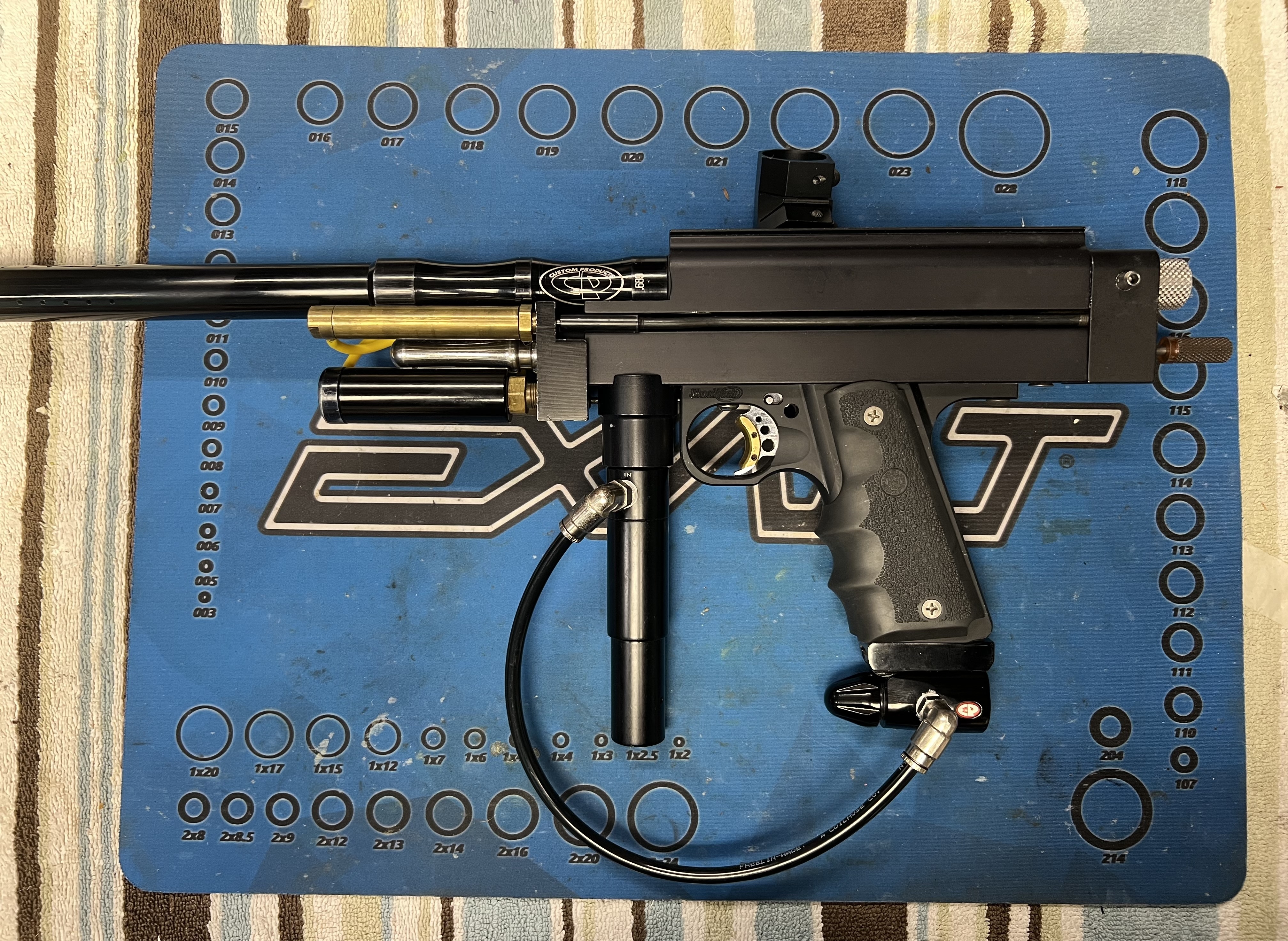

            I have a similar era cocker I updated as a bit of a sleeper. Was tempted to put and ID 3-way in it, but there is no ball detent so I was concerned about chopping.
            I ended up going with slightly newer brass ram and LPR, updated the internals with a modern valve. Worked out welll. The yellow hose was the colour I had on hand and is coved the the pneumatic cover.

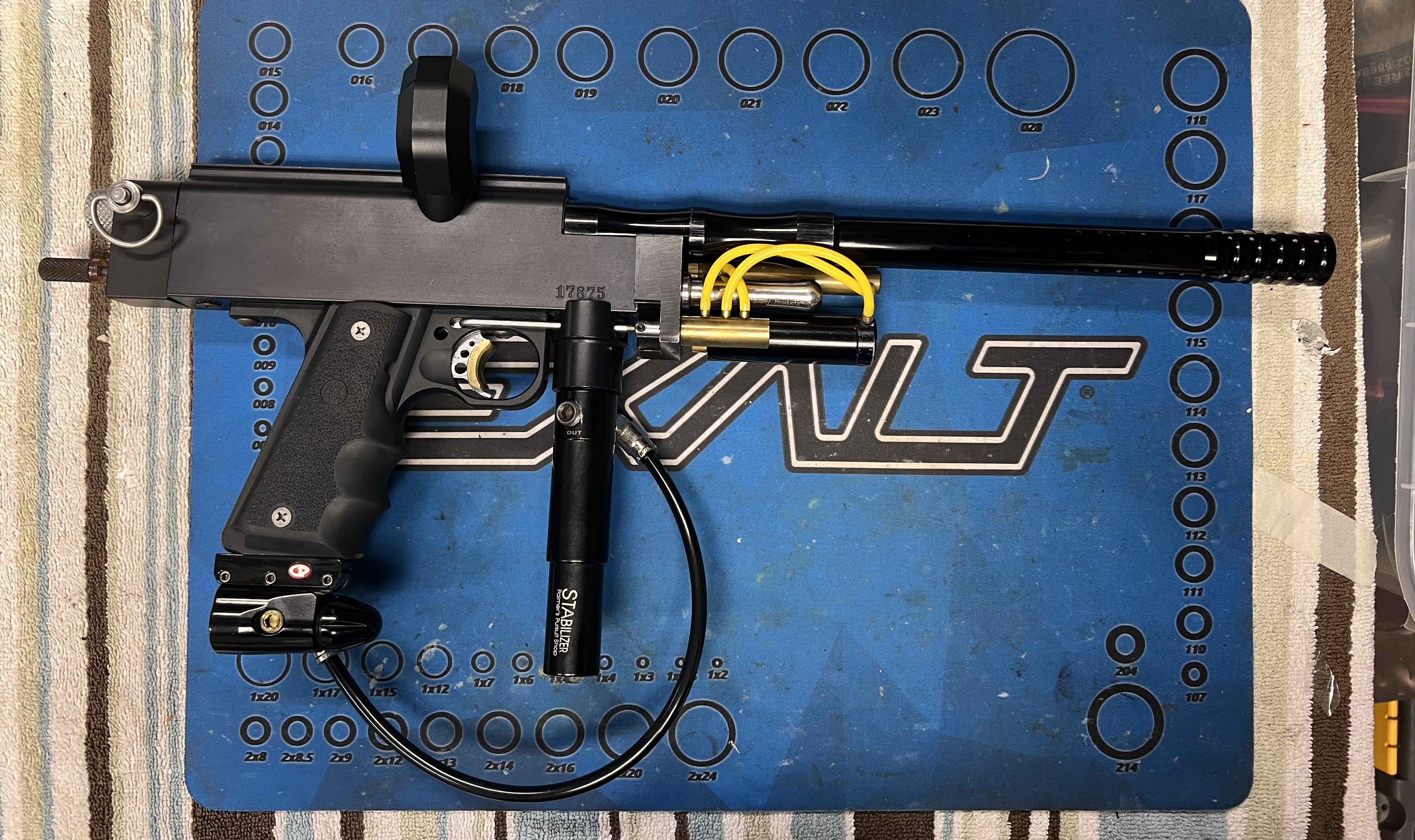

              Alright - thanks to Hellion360 It was a one stop shop for all the goodies I wanted for this build - they came today and I worked through the set-up largely following inceptions choppy old as hell videos for the pneumatics. I dialed a stabilizer in at 400psi output. I brought a powerhouse reg down to 500 psi on my tank. I set up the bolt with a coned lug, starting at 3 1/2 turns from flush - it cocked and released early in the pull. I set up the 3 way rod with the front adjuster bolt flush per inceptions recommendations....... aired up and... leaky 3 way like nobody's business - adjusted it in - then out - sometimes it stopped the leak and I could kind of cycle the gun, but nothing seemed to stay for long..... suggestions - tips and techniques for setting up the gunfighter frame with the ID 3 way - are the adjustments super finite compared to timing a sloppy older cocker? I did dial the stabilizer down - that seemed to help.
              • Psycho91
                Psycho91 commented
                Bring the hpr pressure down a bit 400 is kinda high, set it at 300 and go from there, but when you get it shooting your going to want to sweet spot the hpr
            • Drcemento
              Tiger Stripe Enthusiast
              • 745
              • NorCal
              This is making me nuts - I cannot seem to find a spot where this 3 way is not leaking from one of the 8 holes in it - I changed out the o-rings in frusteration to no avail, and drained 2 68 Ci tanks trying to get it to do something.
              One thing that I am confused about as well.... in inceptions video they show plumbing the ram opposite of any of my other cockers - like you would for a slider. I thought that might be the issue and changed it to match my other sliders.. just like cudas above. that actually seemed to make things worse?
              • Drcemento
                • 745
                • NorCal
                Finally got it. sorry for the stream of consciousness posts. it was the o-rings - both the factory o-rings and the spares may have been old- not totally sure. pulled out the 3 way stem again and the front and back rings were chewed up from all the adjusting i imagine, but i think they also were never creating a seal. had some spares in my jumbo O-ring kit, replaced them and all the sudden it worked, with the adjusting end of the stem about flush with the end of the 3 way just as inception said.
                dialed the reg down to 300 as well which seemed to help. also had confused myself further by changing the plumbing of the ram around again. cycles nice, now I can bring the two a little closer together. Really like the feel of the gunfighter.
