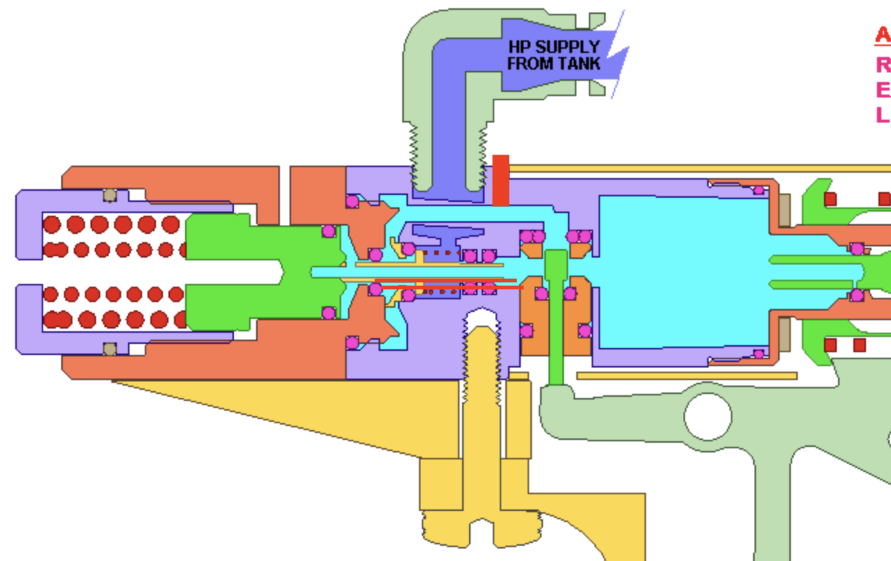

                    Well the thought is that the air flows though the small passage way to the top of the on/off which is what resets the on/off sine less pressure or flow both basically result in less pressure at the top of the on/off being able to cut that passage way down would (in theory) be able to reduce the return force of the on/off regardless of if its RT or ULT. In theory it would allow you to adjust that flow path externally without having to degas or take anything apart thus allowing you to adjust the return force.
                    So basically a screw to act as a needle valve where the red bar is on the image
                    (ETA: ignore the extra little horizontal red lines I some how clicked paces I didnt mean to and am just too lazy to go fix it and reuplaod it)Screenshot 2024-08-30 at 10.53.12 AM.png
