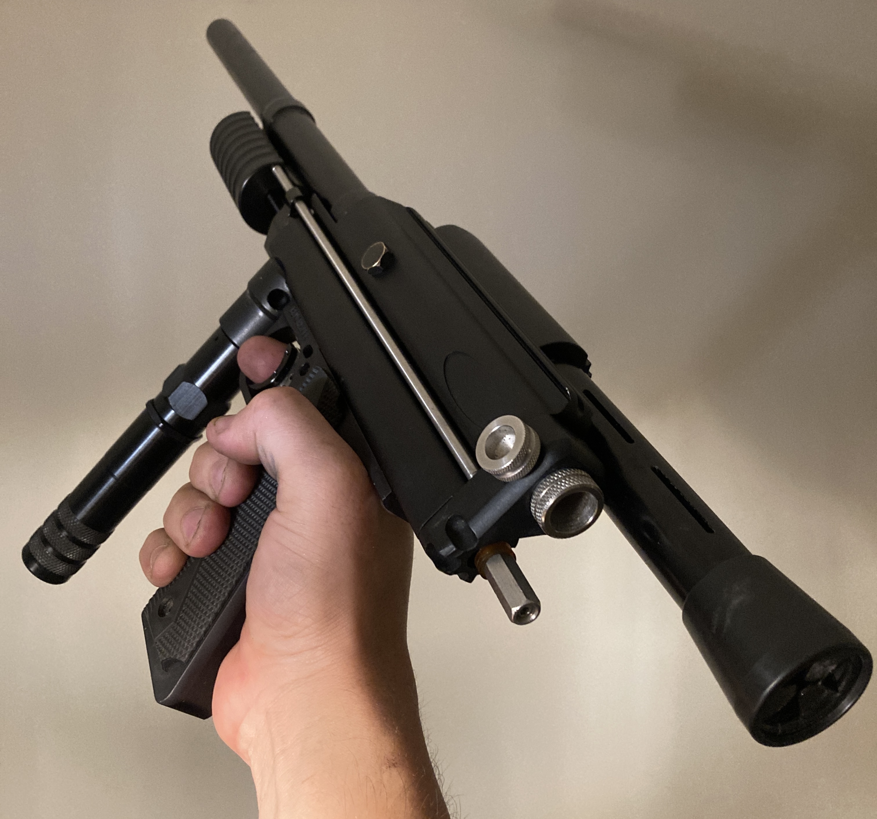

    I put this stock class sniper together recently and its been efficient and consistent for ~ 1000 shots.
    was getting 32 shots per 12gram @ 275fps.
    Took it out today and started having an issue where I get 10 shots at 275, then velocity drops to 200 for 12 shots, then back up to 275 for the remainder of the cart.
    Anybody know what the issue would be?
    cart reg is on a fresh rebuild but i have a couple more kits. guess ill start there.
    Autococker Parts.com Gold kit (ccm clone) in the lower tube
    Reg is set at 350psi

      as states in the post,
      bottom tube internals are autocockerparts.com gold kit
      reg set at 350psi
      2 oring freeflow bolt
      14" bob long longshot freak bored
      wasnt shooting any faster than i would in an actual game. taking my time, hitting targets.
      ill crack open the reg later today to have a look
      i havent touched it since buying it off my buddy who got too frustrated and gave up on his stock class build.
      im interested in seeing the numbers at a slightly higher input pressure, seems like a lot of folks have good results around 400psi
